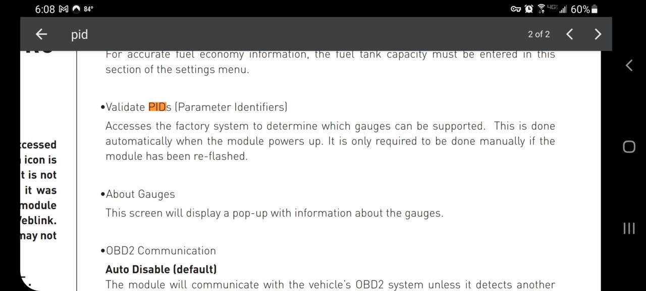

    Haha, so I just need to wait? I hope it's that simple. I couldn't find the update option, but it looks like it's automatic:

    I hope it works for ya, You could also try resetting the meastro unit instead of just validating PIDS. I have done that as well, I was nervous at first thinking settings on meastro would be erased but everything came back fine. I think it’s called “master reset”

    Just got inside from doing that, no dice. Seems like my Scangauge did something on initialization, shouldn't be too much of an issue I hope. Maybe just 24 hours is all it takes.

    Well I can tell you I lose my trans temp from time to time (just shows up as -) and going through the validate PID process always brings it back.

    Well crap, maybe I just keep the Scangauge? I haven't found any options to validate PIDs in my 1007, but I'll talk to the guys that put it in, they should set it right, if it hasn't righted itself in 24 hours.

    And boom, like that, the reset or something worked, thanks for the assistance folks!
