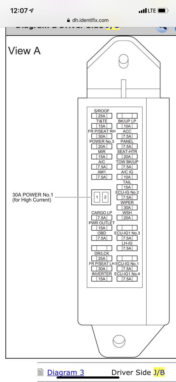

    Ok it looks like the power window relay is powered by a 30A fuse look for that under the dash.

    The body control module works your climate control theirs a 7.5A fuse that powers the BCM under the dash. Look I’m doing my best to help u I been doing this for 30 years if I was their first thing I would do is check every single fuse so pull your owners Manuel and u will see wat all the fuses do I know they are hard to get to but u need to do it either go get a 12v test light turn key on and probe each fuse or pull every single one out and inspect it specially the 7.5A they are a bit darker and sometimes hard to see if their any good

    Under dash fuse panel

    Check that 30A power No 1(power windows)
    Check 7.5 ECU IG No 1 (shifter interlock)

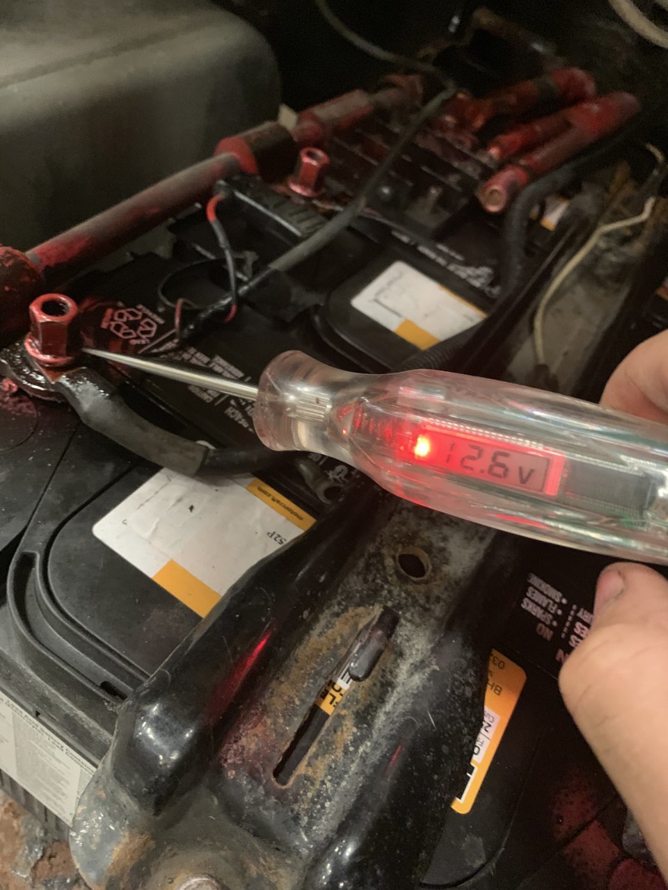

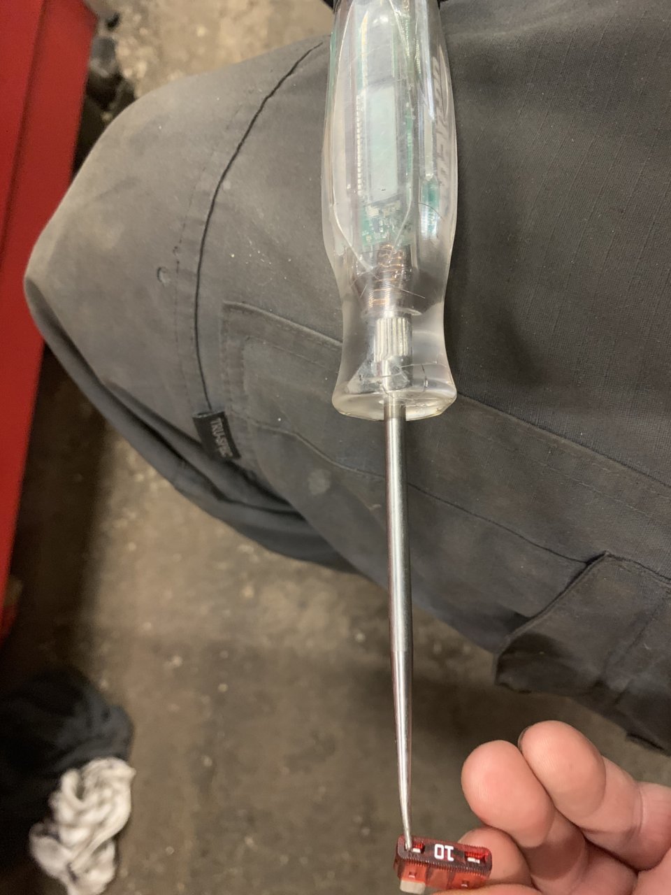

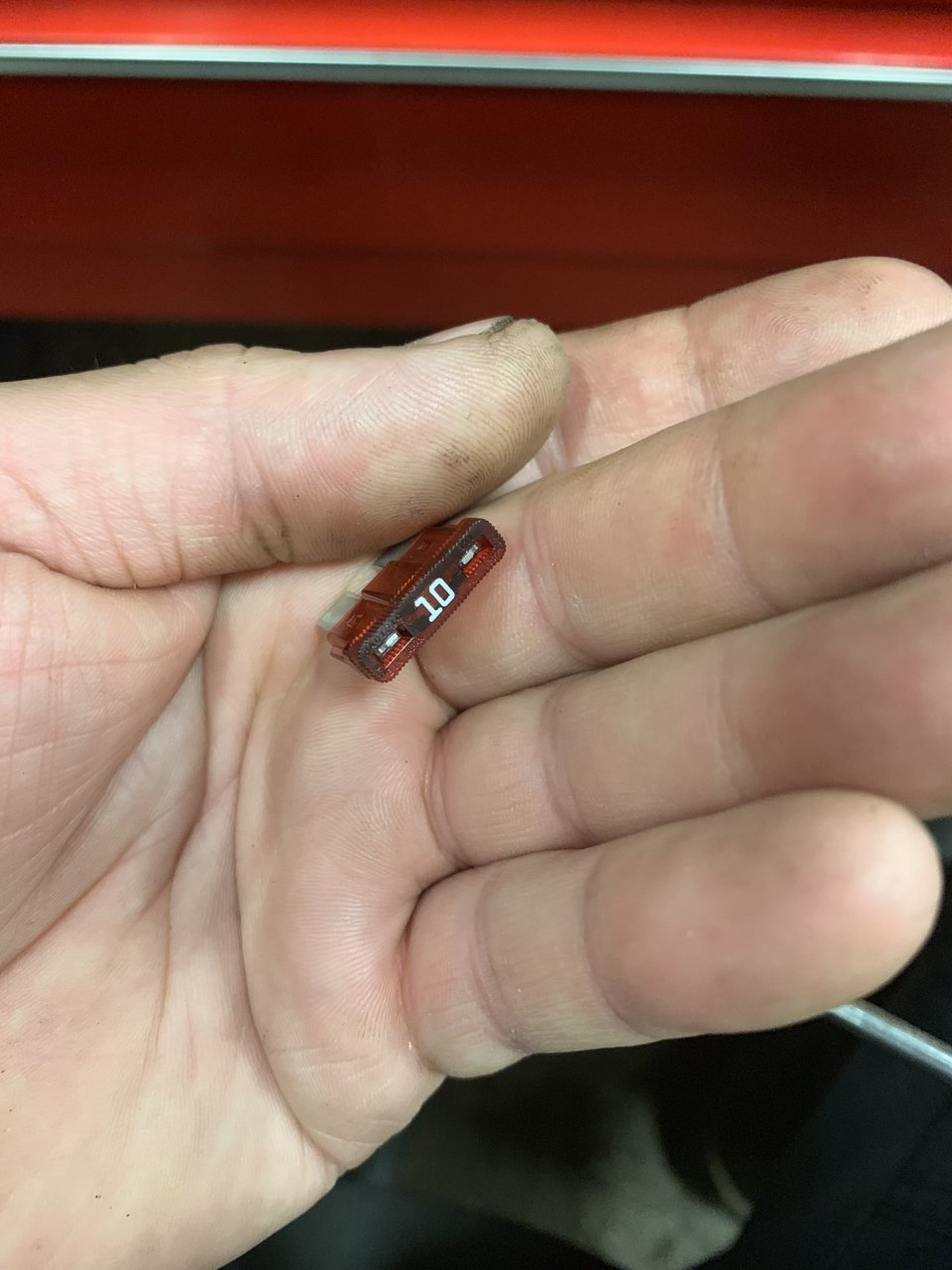

  28. Sep 19, 2019 at 5:51 PM
    #58
    773_eddie
    773_eddie Trd Pro
    Feb 17, 2019
    #26204
    662
    Eddie
    Chicago
    Tundra Trd Pro
    12volt remote start, weathertec accessories, Trd Pro decals, Toyota console safe,VLEDS Puddle Lights,Frac Harness,TRD PRO front and Rear Sway Bar,NSV Hood Light Bar,ESP long box,AJT accessories,Thinkware U1000 dashcam, coachbuilder 1/3 Lift, HR LED’s,Pro comp Traction bars, JL complete System wit 2 10” subs, Kenwood DDX9907XR HU
  29. Sep 19, 2019 at 5:53 PM
    #59
    773_eddie
    773_eddie Trd Pro
    Feb 17, 2019
    #26204
    662
    Eddie
    Chicago
    Tundra Trd Pro
    You stick the point into the fuse like picture #2 make sure key is on wen you do that and you poke both sides of the fuse if the tester lights up on both sides it’s a good fuse if only lights on one side bad fuse
