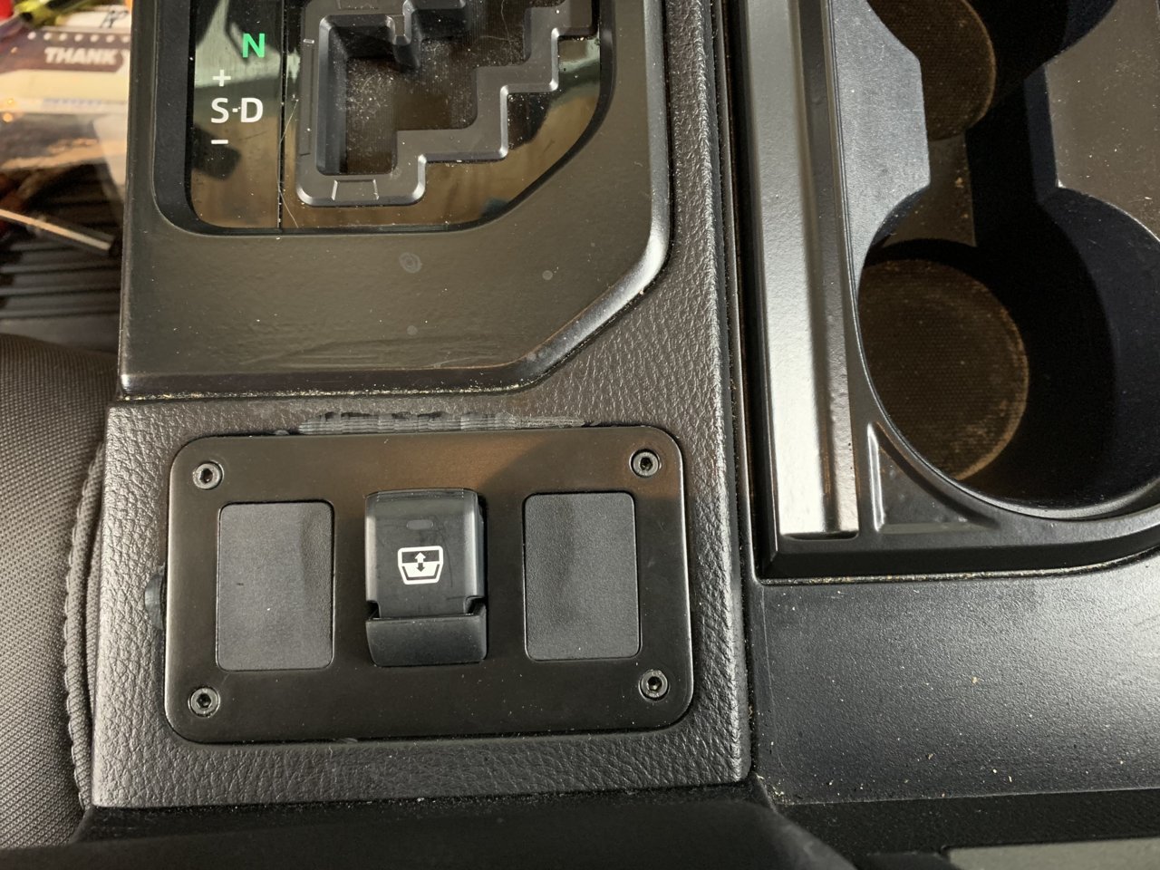

    Finally got mine painted this week and hopefully getting it installed tomorrow. Thinking about drilling out the mounting holes before I cut out the plastic so I know exactly where they are and don’t over do the cut. What do y’all think?

    581208FD-1C4C-4690-943C-E6FDA676FDCA.jpg Finally got it done! Thanks to all in this thread for your guidance! I didn’t realize how much trimming there would be. That was by far the longest part of this whole project.
    As you can see from the picture, I had a slight “accident” with my Dremel. Short of getting a new piece and having to do this all over again, any suggestions on how to cover up that blemish? I was at a good angle and wasn’t paying attention to the neck of the tool, which buzzed the top.
  28. Oct 31, 2021 at 12:10 PM
    #178
    CorpsTundra
    CorpsTundra [OP] New Member
    Jul 15, 2021
    #65597
    170
    Dan
    Michigan
    2021 Tundra CrewMax SR5-TRD OR - Cement
    Outside of melting some of the cutoff plastic into the gap I think you either live with it or replace it. I would stay away from trying to melt plastic to fix it unless you take it all the way off. Either way the texture and color will be off, so I’d replace it when you come across a cheap one. I think you could probably find one at a junkyard for a reasonable price.
