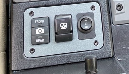

    It finally came! I need to either get some better sandpaper or fill/prime/paint the top eventually, but it fits great and holds the switches well. I drilled the thru-holes a little wider for the M4 socket head screws that I picked up - M4-.70x20mm. The screw length was just long enough to get them started while the heads weren't seated, and then heads pulled down flush after tightening them down.

    Nice! Yeah the original post from @RainMan_PNW mentions the need for lots sanding and filler primer if you're looking to get rid of the 3d print lines. There are 4 solid layers on the top so you should have plenty of room for light sanding unless you're using a rotary or belt sander on it.

    My CM design one looked the same way.
    A little sanding and filler primer.
    The hardest part is retraining yourself not to reach forward for those moved switches !!
