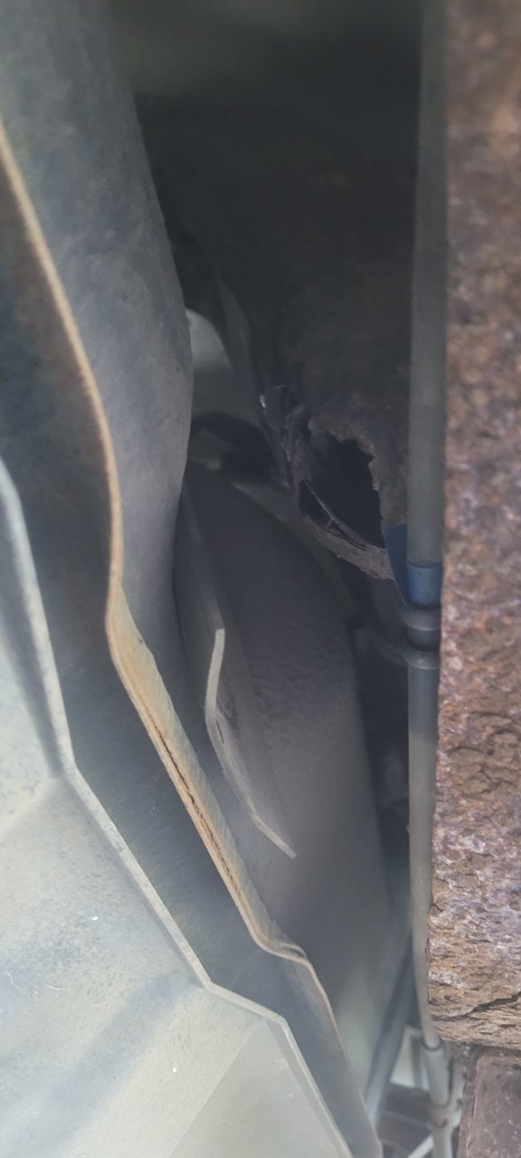

    So I walked out the other day to find the fuel tank hanging down. The cross member is rusted through as you can see in the pics. I'm having it towed to the dealer hoping for a frame replacement (they said if it qualifies as if they are still doing it). Based on what I have seen I don't see how this wouldn't qualify? Input?
    The frame pic is the cross member where the front fuel tank strap would attach. No way to attach, just a hole now.

    I have read a lot but not seen the so you wanna buy a tundra link. Very helpful links, looking now. The frame has not been treated, I have owned it since 2003 and based on the other link I don't see how that hole in the pic I posted won't do it. That's the front red cross member in the post regarding frame replacement faq

    That 1st thread should link to the campaign, which I think requires a hole in the crossmember above the spare tire carrier or similar? I don't recall ... doesn't apply to my newer model :D

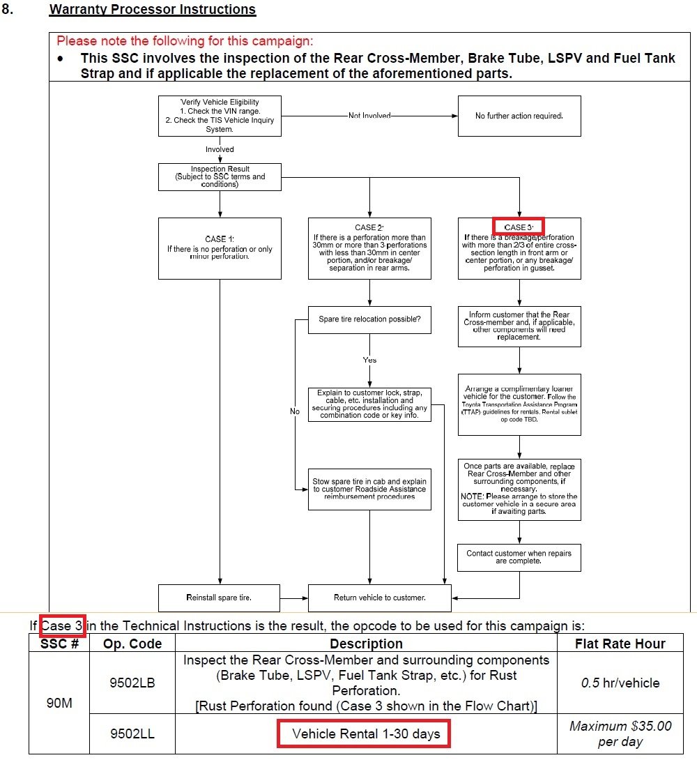

    Attached a copy of SSC 90M Recall pdf if that's what they change it under and in case you have questions for them.

    That's good to hear. Definitely post up that list as soon as you get it. Want to make sure they don't charge you for parts that they should be paying for, like lower control arms.

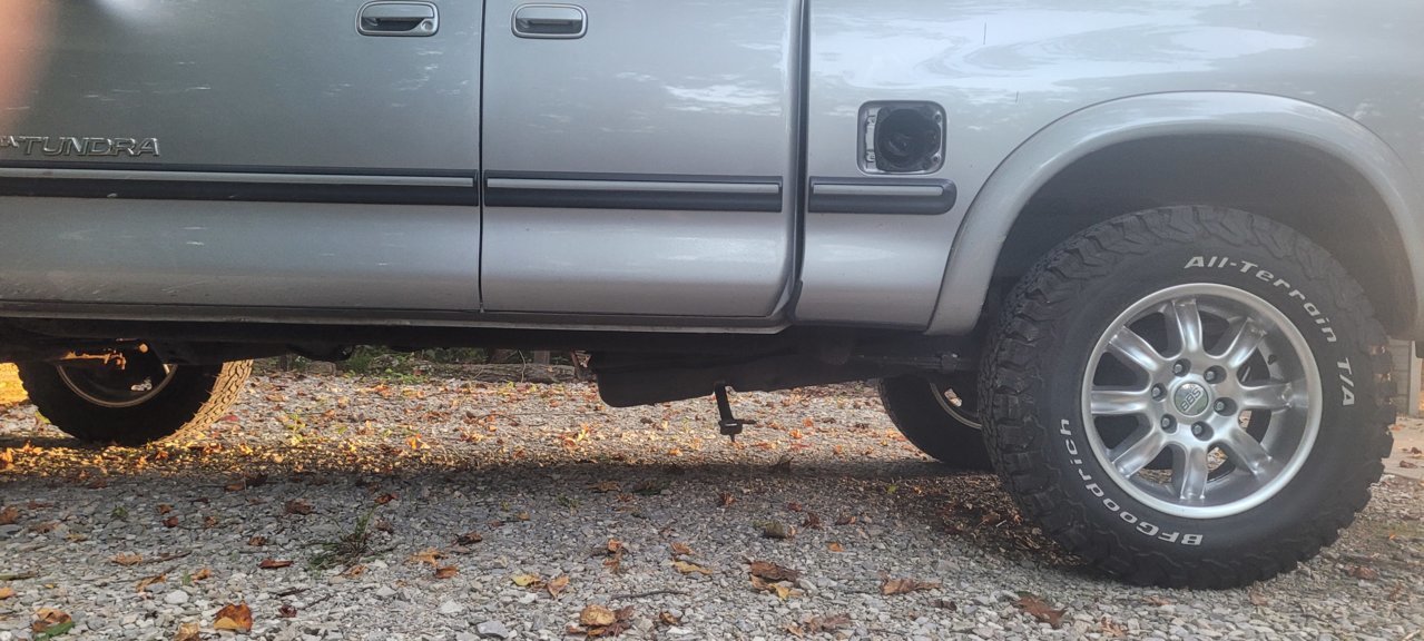

    looking for suspension input, either direct buy this or indirect to help me figure out what to buy. I am not a buy it and see how it goes kinda guy, I need it to be right so I don't waste money. Right now I have the following rims and wheel spacers on the truck that is getting the frame replacement. I have the combination to get flush with the fender flares I put on it to cover where the fenders were rusting out and that worked out great.
    BBS OEM Tundra 18" Rims from the darrel Waltrip edition...here is a pic
    SpiderTrax 1.25" spacers all the way around.
    I had to trim the plastic under the front bumper to keep it from hitting the tires when turning somewhat sharply at speed and the trim worked but it has to be close to hitting the bumper. That means they barely and frankly do not fit great but do work. I have 5100s upfront with factory spring and I think they are set on the center notch if I recall correctly. I need to get new struts (I will be replacing all 4 corners but front is the concern) so I need something I can guarantee will work and potentially improve the situation (at least not make it worse) but not make something else worse. I was thinking of the 5100s with OME 2884 but got to thinking that since its so close i may be better off with something adjustable although that certainly more money. I cant guarantee the lift I currently have to know how the 5100/2884 will match up. I can do a lot on my truck but I am not a suspension guy at all so completely a noob here. I do mostly on-road, no real off-road with it but do take it off-road to go hunting at times and do what I have to to get where I am going.
    Input would be appreciated. I have read multiple threads but I am not sure how to translate what I have read into what will work in my setup and that's where I am asking for help since I don't know if I got 2" of lift, 2 1/4" , etc? I know its "around" 2" but.....
