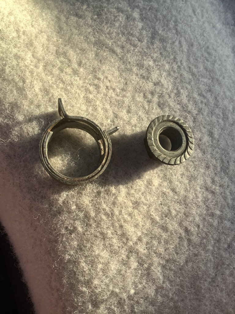

    Found the hose clamp on the right side of the truck in the little “pan” where the sway bar end link is attached to. The nut was hanging out in the bottom of my bumper/fender/wheel well, also on the right side of the truck.
    I looked everywhere all over, up & down, left & right and I can’t find anything missing or loose. Does anybody have any idea where this specific nut and hose clamp could of come from?

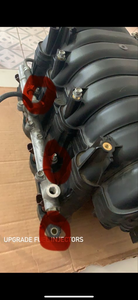

    That nut looks a lot like an upper intake manifold hold down nut that goes on the studs. One on every corner

    By any chance you have a picture of this?

    So their should be 6 total on my 2002 sequoia?

    If you looked all over and all your hoses are okay then the hose clamps may have been replaced with a different one. Just throw it in your bin of spare hose clamps.

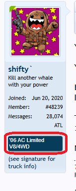

    You don't have your year / cab type / engine / 2wd-4wd info in the 'Vehicle One Line Description' saved into your profile HERE, so I can't give more details on what you should potentially have and what's compatible.
    Basically, the power plug between early years was different (4-square) than later years and the early years used lower amperage options. In later years the plug was updated (4-flat or 4-oval, IIRC) and higher amperages were available. You can swap any higher-amp alternator you want, in any year. The later-year alternators will even fit in the earlier-year trucks if you re-pin the wiring from the square connector into a flat OEM connector, and potentially grind one down spot on the alternator housing.
    Typically speaking, later years, if you had the tow package (like I do), the trucks came with the 130a alternator. In the later-year Tundras, you can also swap (direct bolt-up, plug and play) the 150A alternator from the Sequoia. But IIRC the main fuse on the Tundra is 140A, so if you're really pushing that 130A alternator to its peak output threshold for more than a few seconds, you'd probably want to update the main fuse? I'm not an EE so I'm not 100% sure.
    More info on interchange is here: https://www.tundras.com/threads/04-sequoia’s-150-amp-alternator-swap-on-a-00-tundra-the-3-big-upgrades.67222/
    PS - once you go into that "HERE" profile link above, update your Vehicle One Line Description then click the "SAVE" button at the bottom of the profile page, your truck info will show up in this blue box under your picture. It's super helpful to update that info so we don't need to worry if we're giving you advice that pertains to your exact year/make/model/cab/engine/drivetrain.
