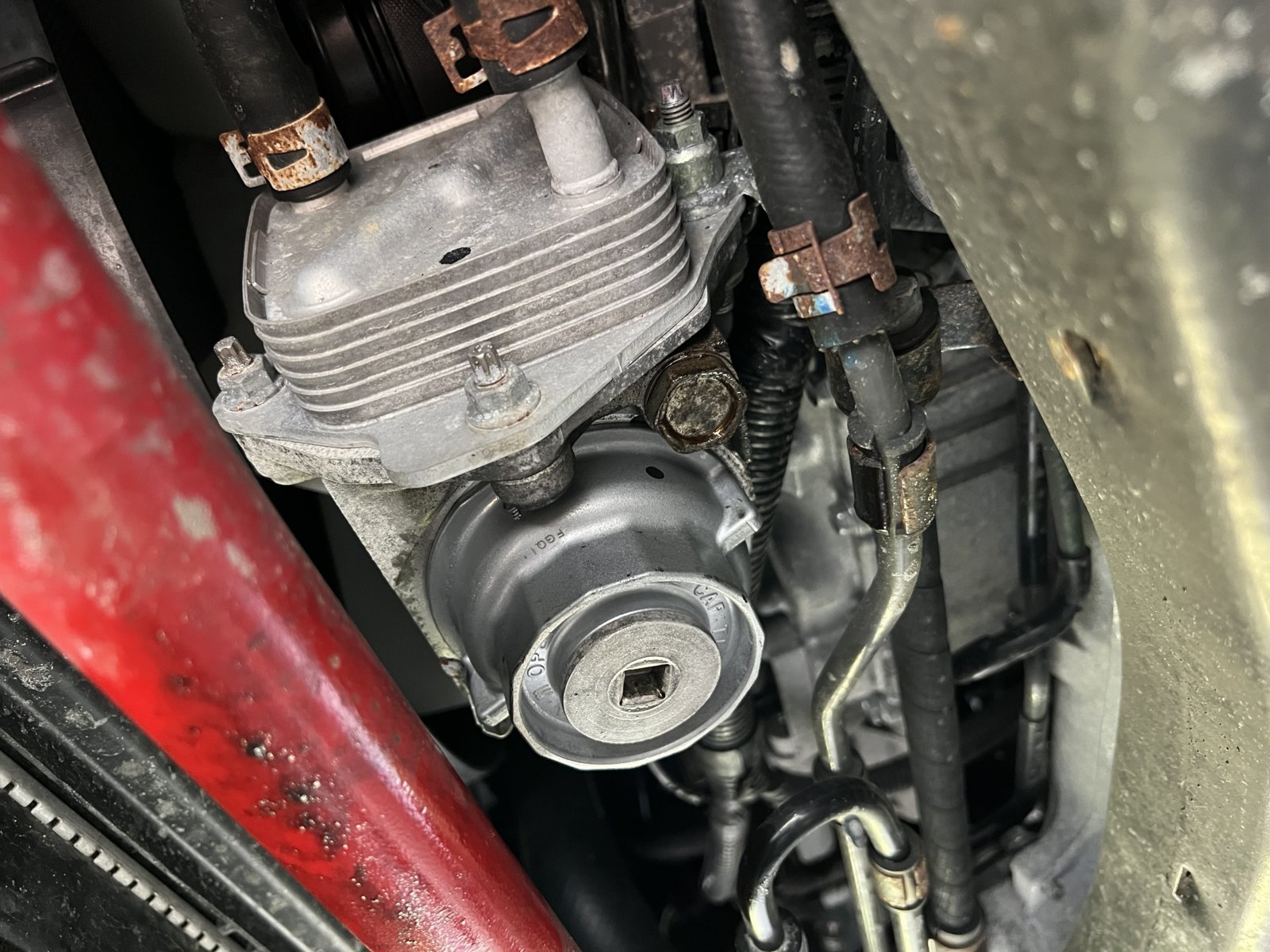

    Anyone know what the bolt next to the oil filter is? It looks like it’s leaking….

    Just noticed this on mine also..

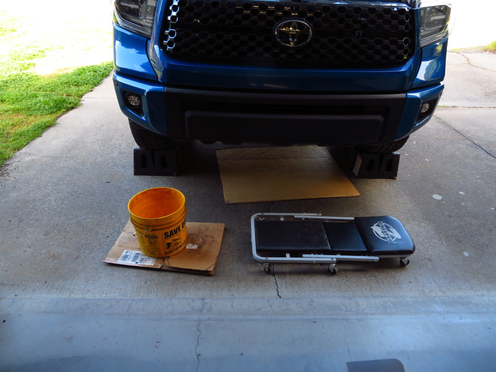

    Renewing an old post but I promised photos of my oil change setup. I changed the oil/filter yesterday (2/26) and here are photos before I slid underneath:
    1) I set up a table with everything I need for the oil/filter change (new oil, filter, tools for the job, once used paper towels, etc.)
    2) I put the paper towels (I dry my hands in the kitchen after washing and save the towels for just this type of use) and tools in separate shallow cardboard boxes (actually from cases of beer). Easy to slide around in positions for use.
    3) Large piece of cardboard is used to rest skid plate on after removal and slide it back under the transmission out of the way. Five gallon yellow bucket slides under pan drain plug on a small piece of cardboard and captures all of the oil being drained without spilling a drop.
    After pan is drained and drain plug replaced, I move everything over under the oil filter and drain it and remove housing. I then slide out and bring the oil filter housing to the table and replace the filter and O-ring after draining the last bit of oil out of the housing.
    Then I'm back underneath to re-install the filter housing. I'm done underneath until I re-mount the skid plate after filling with new oil, starting and checking for leaks (there never is any).
    So, that's it.
    Dan

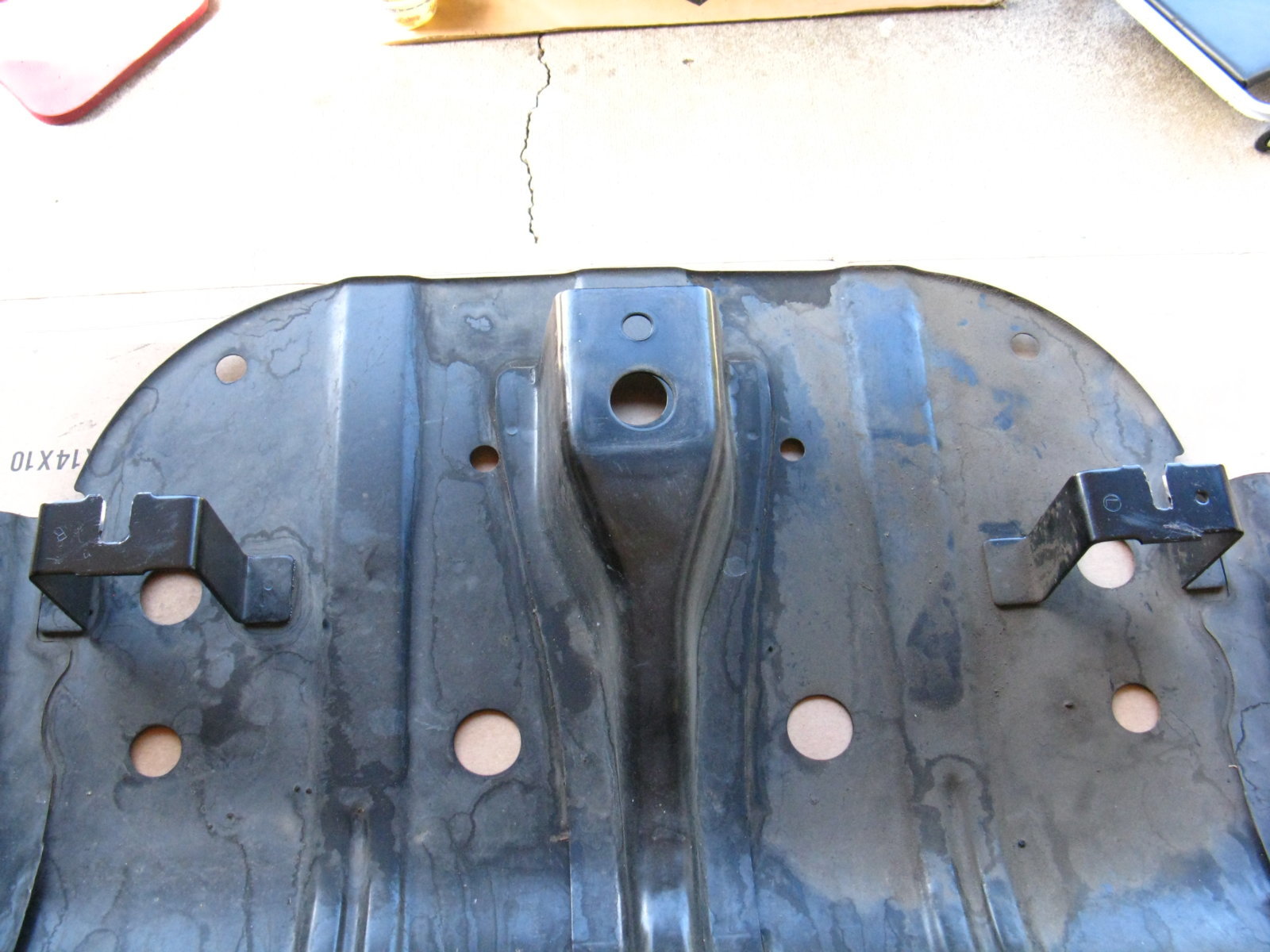

    So I modified the two center mounting points as shown. I leave those two bolts in place, just loosened a little. Remove the other three (plus the three thread forming screws for the front bumper tabs), slide it forward and off. With the two center bolts in place, you can remove all of the rest of the fasteners without wrestling with the danged thing.
    To re-install, slip the front edge of the skid plate under the three bumper tabs, move it forward a bit and up to align the slots with the loosened bolts. Slide rearward and the two bolts will hold the skid plate in place while you install the rest of the three bolts, then the three thread forming screws for the bumper tabs.
