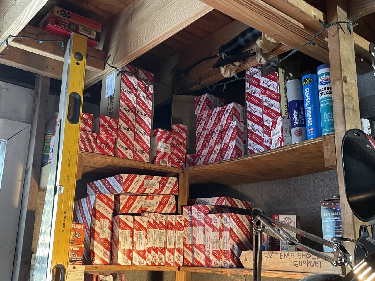

    Buy all the necessary Mama Toyota parts when they're on sale and stock your self. Then you can feel like YOU are your very own dealer service department. Without all of the BS.

    Wow lol I thought I was bad

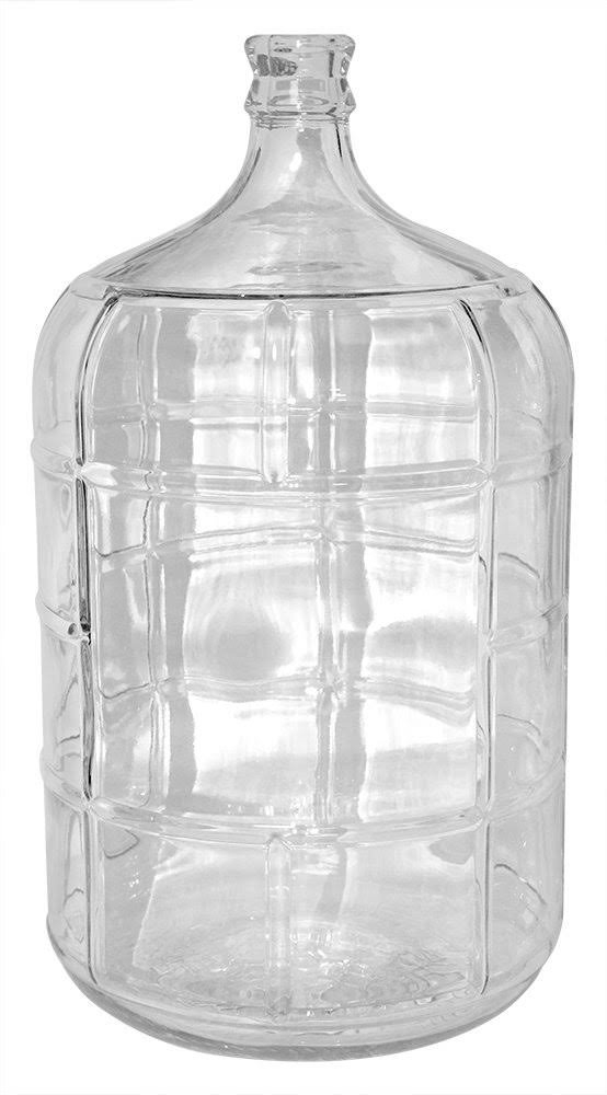

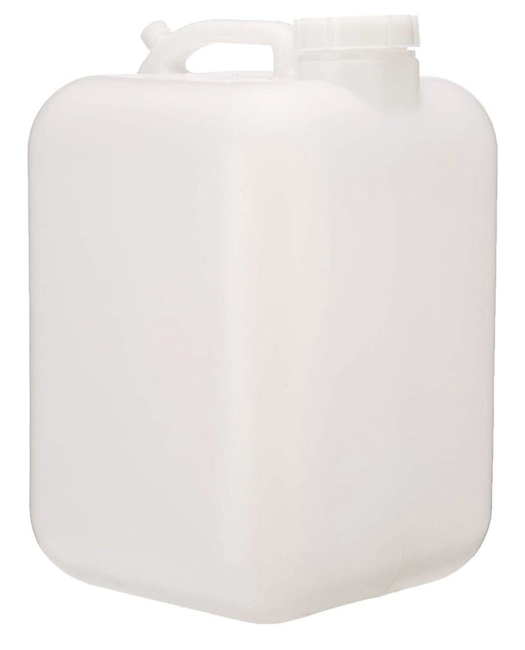

    I use a 5-gallon plastic jug with a screw-on lid. To drain the oil I simply put the tubing from my Fumoto valve in the spout and let it drain. When the jug gets full I take it to my local garage that heats with waste oil. No mess, no cleanup at all.

    I think these are called "carboys".

    No, a carboy is different. A different shape, and usually heavier material. A carboy is shaped more like a bottle with a single neck and spout. Similar to a beer bottle but with a much shorter neck.
