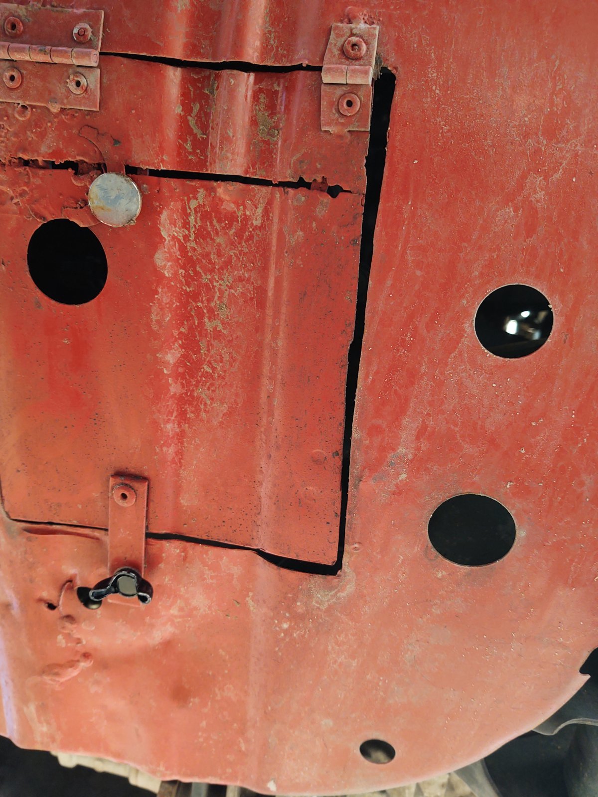

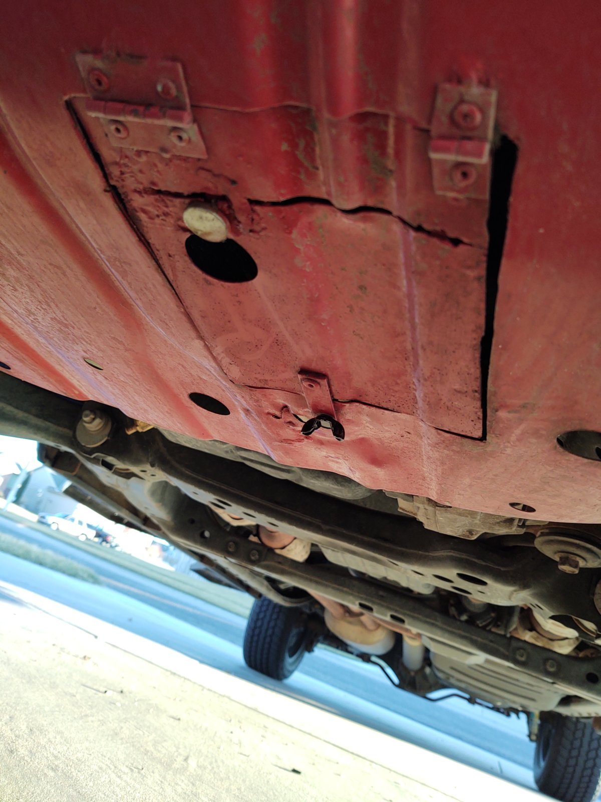

    Do you have pictures of the trap door you made? The skid plate on my Tundra doesn't have one and the nice guys at the lube shop stripped the bolts so you can't remove the skid plate. I was going to buy a new skid plate but am curious as to how you made the trap door yourself.

    Not saying mine is the best but works great and takes about 30 seconds with drill driver and socket to take off plate to access filter housing

    Here is mine, I have a thumb screw so I dont need any extra tools and have a rare earth magnet to hold the door out ofy way

    I like that, I guess I was just paranoid of it being a weak point doing it that way

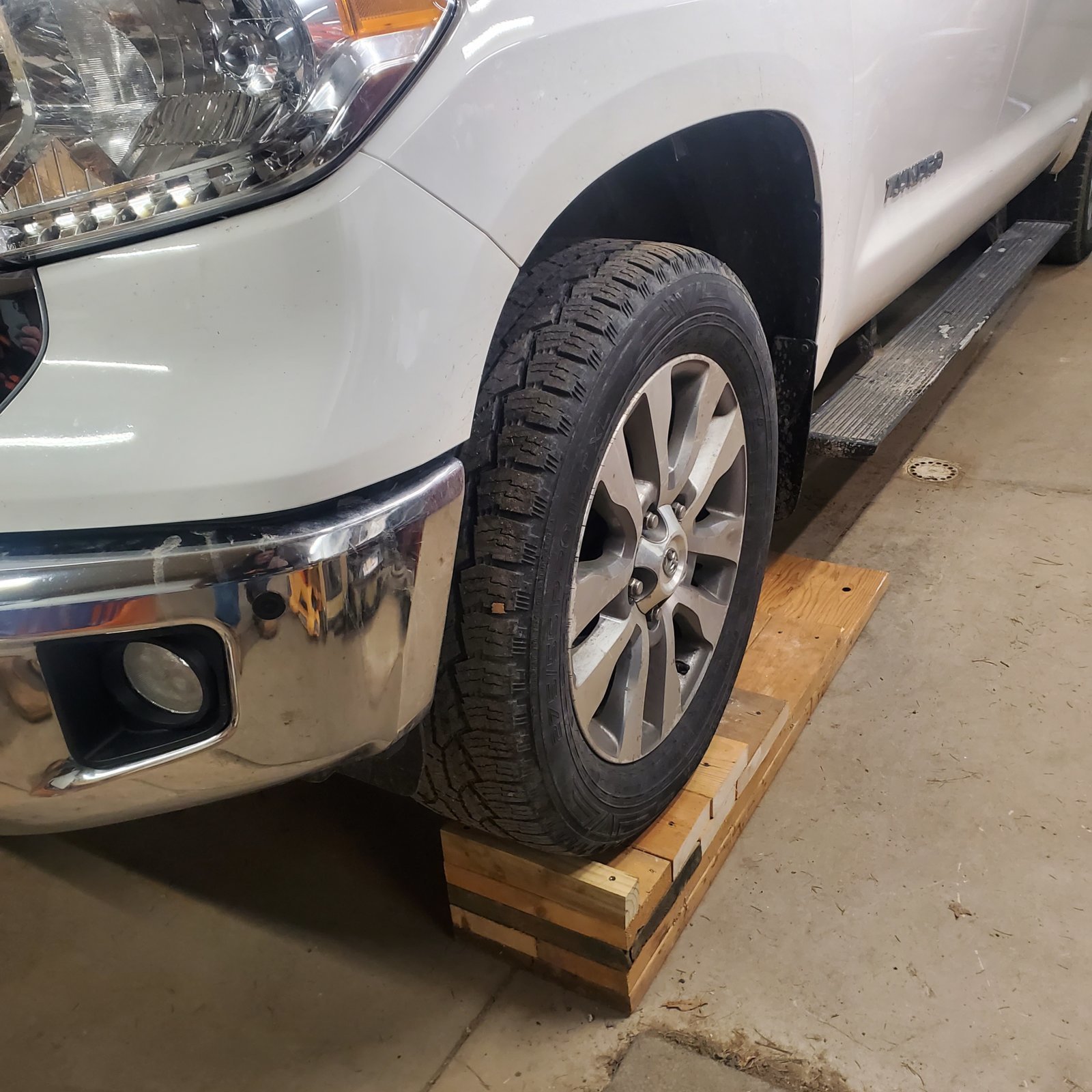

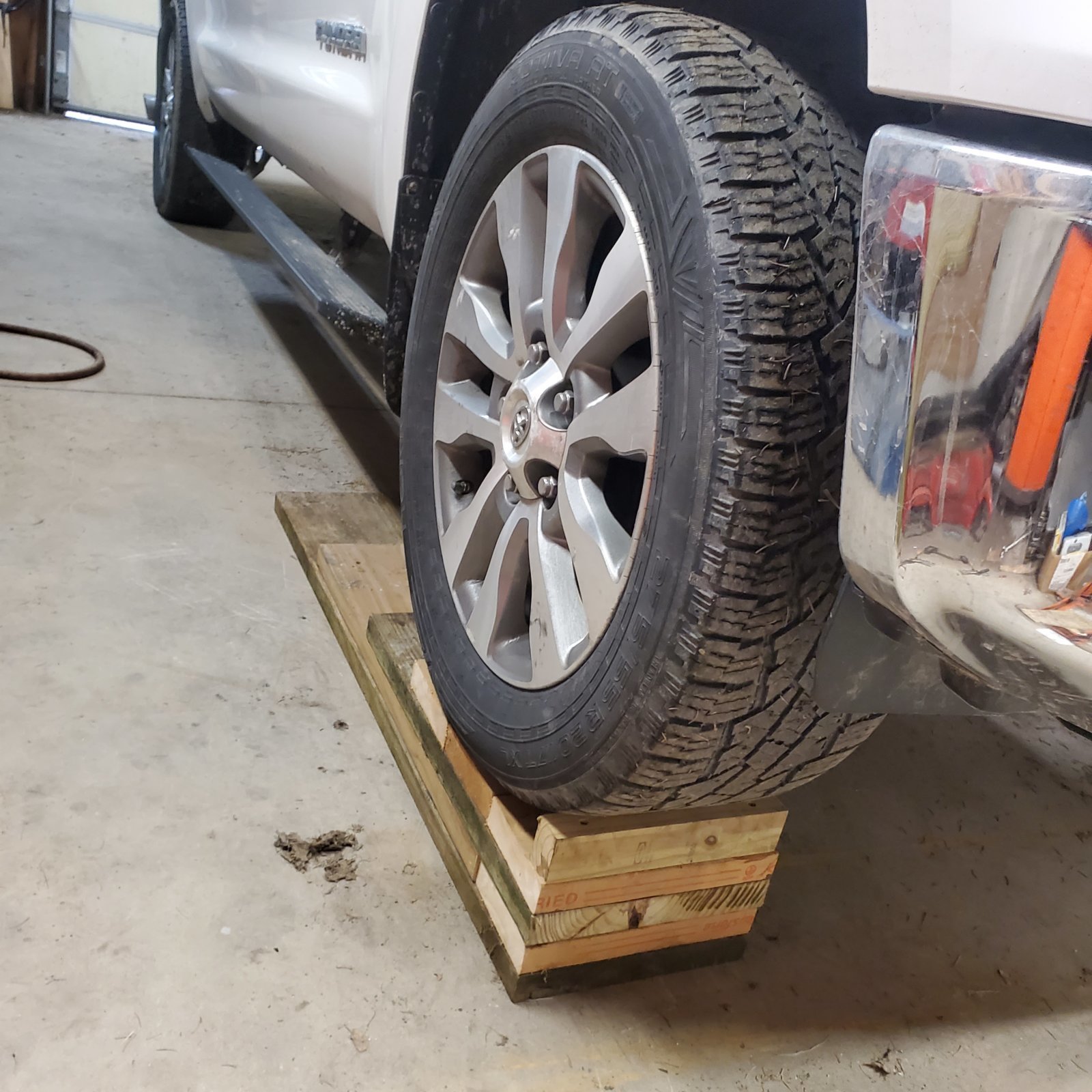

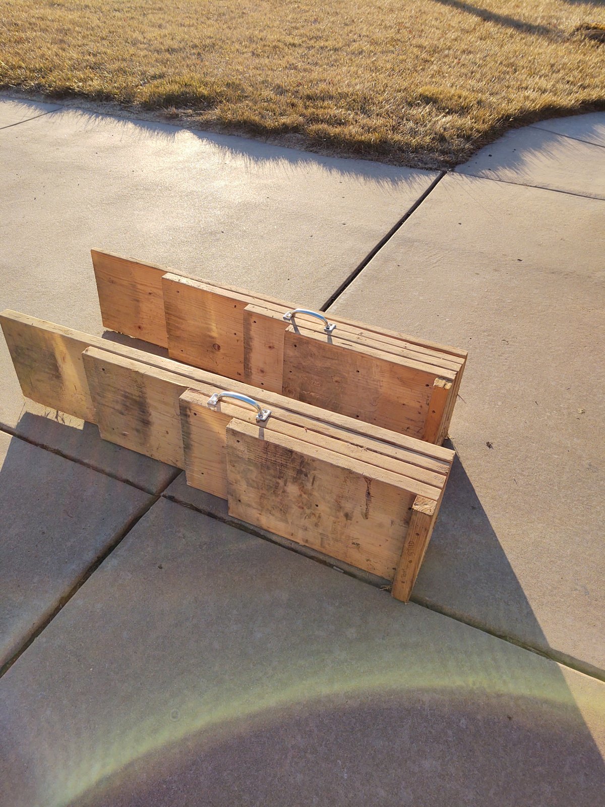

    Made my ramps thanks "Ebrperk"..

    Looks good, great job. They will last many years

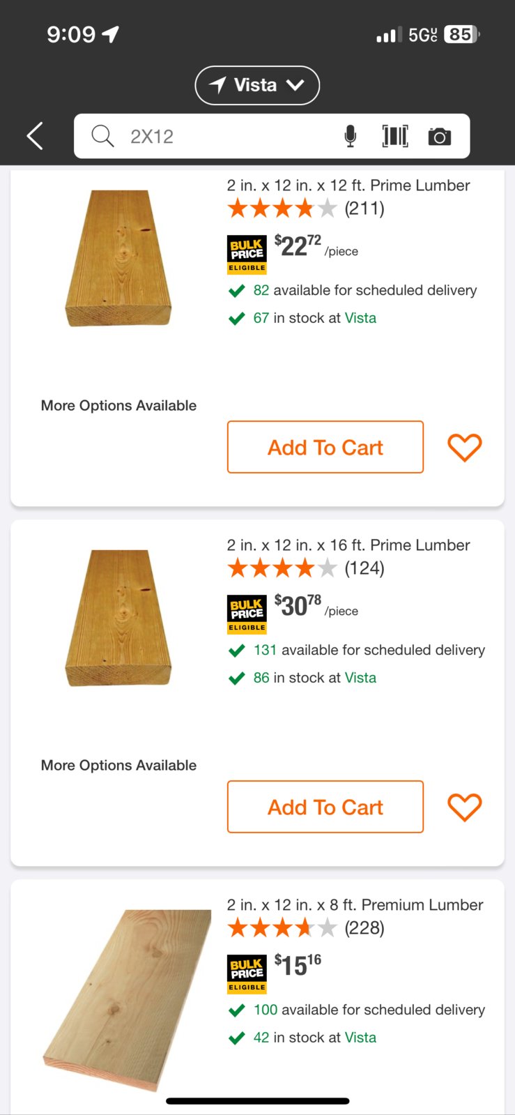

    assuming these are 2x12 what was material price?

    2@12’ should do it

    I already had scrap pieces, my local lumber yard didn't have any 2x12x12ft any ways, so... ..It's mostly 2x12's, some treated, except for some 2x6's to fill in what I needed..the treated one is heavy ..Bottom to top, 4FT, 3FT, 2FT, 18In. per previous post.. So you would need 2ea. 2x12x12Ft.. I know others use the HD Rhino Ramps. These are super easy to drive on.....Used them last night to replace the broken ground strap for the tranny, secure more of the exhaust heat shields..

    at the time, I paid around $10.00 apiece for the 2x12x12, had several pounds of construction screws so it was cheap, also, I work at a lumber yard so lumber and building materials are plentiful

    I like my job ginormous but they slide on the concrete garage floor all the time. Had to buy rubber mats to put underneath. I bet these homemade ramps do way better
