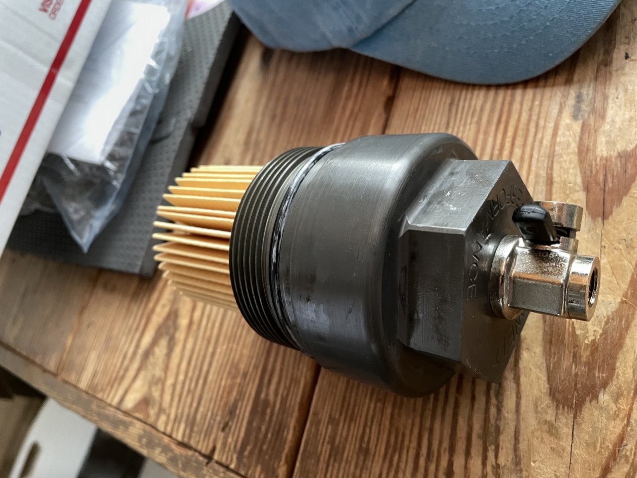

    This is the hot setup:

    What am I looking at here - link?

    Aftermarket engine oil filter canister cap made by Jowett Performance. With the optional Fumoto valve in the bottom of it for easy oil draining prior to removal. These caps are hard to get now. I got mine about 4.5 years ago. Though I saw a few posts several months ago that Jowett was making another run of them.
    https://jowettperformance.com/products/coming-soon-billet-oil-cap-for-filter

    So I guess my first question is should o install two fumoto valves…..one on the actual oil filter cartridge and one for the oil pan? Or does it all drain from the same place?

    I don't know that you could install a Fumoto valve on the oil filter housing that comes from the factory. However, there is an aftermarket billet oil filter housing that has a Fumoto valve built in. I think it was posted as a reply earlier in this thread, yeah....see reply #35.

    Until my last oil change I thought I was a master at doing it myself.
    I didn't get the new rubber gasket into the correct groove of the filter housing and oil leaked everywhere.

    Thank you for the link.
    My daughter’s fiancé owns a shop. I watched him do the oil change. Sorry for the probably silly question. Is the fitting and rubber hose (see pic) take the place of the plastic piece that comes with the Toyota filter to drain the housing it’s in? It has threads and the plastic piece just appeared to snap in.

    Yes, the tool you show threads in using the threads for the plug that's normally there. Then you screw the knurled part in to push the ball up and drain the oil. I only screw the knurled part in just far enough to get the oil to drain so as not to overcompress the spring.

    I noticed a warning about that on the filter box.
