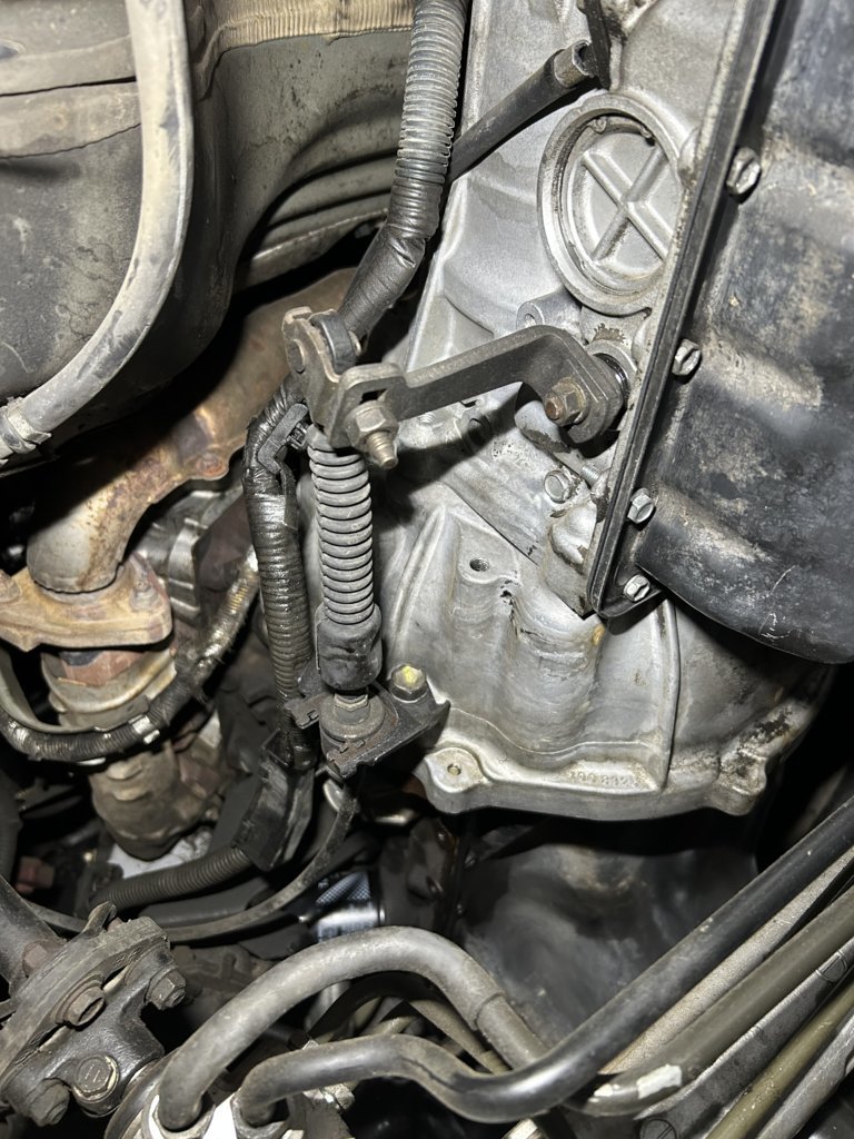

    Aside from what TBM already shared, I just want to say I'm seeing two more problems.
    Blue arrow: That boot should be pulld down over that bumpout.
    Blue line: That bracket should be bolted to, I think, that hole in the transmission.
    I may be wrong on one or both, but I don't think I am.

    Hey shifty, so that's where my issue arises. If I put ALL the bolts back in, then the transmission will only go back to N, despite the stick itself being in P. Also to the rubber sleeve, I intentionally pulled it down to show my current issue. I don't have an issue with pulling the rubber sleeve back over the whole thing.

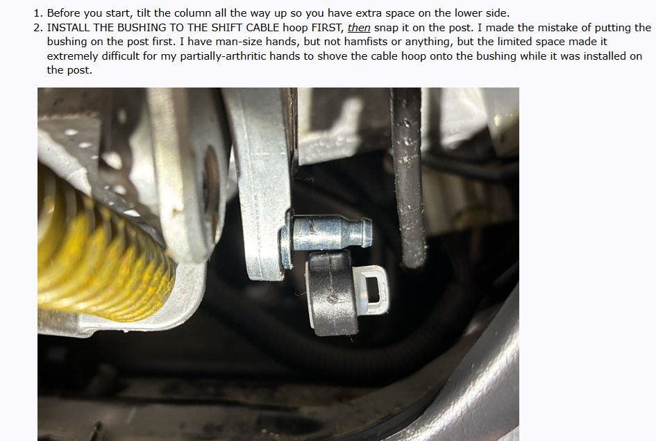

    Hey shifty, so I bought the bushing, but I'm trying to figure out how the plastic arm is able to fit inside of it. I'm wondering if its gonna be a super tight fit or what the deal is because I can't seem to get it on the bushing.

    I had a similar issue, and I swore I wrote about it before. I believe I had to slide the bushing on the metal post, then slide the black shifter end over the bushing? It was either that or the reverse, put it in the shifter end and apply on the post. Make sure there’s no residual plastic anywhere.

    Hey shifty, so I'm gonna do the other way. I've naturally tried putting on the metal post then sliding the black shifter on, but won't go. I've seen a video where they do the other way and apparently it works. However, they use a different bushing to get it to work, so we'll see what happens.

    It definitely wouldn’t work one way, and I had to do it the other. Thinking back, I think I did insert it into the cable end, then onto the post. I feel like that was the only way to get enough leverage on it. It definitely was stiff, as it should be. (TWSS)

    Hey shifty, so I found a video talking about using pliers to be able to get the bushing onto the arm. However, I did notice how they had the plastic arm removed from the truck, so I'm wondering how they were able to do that.

    Here you go, it's in the 1st link of the bullet point above, I wrote the caution message about the order to us, in all-caps, so (at least I'd hoped) nobody could possibly miss it if they just looked at the thread. Do you read anything we link at all? :rofl:

    **EDIT** Success, so I realized that the transmission was in N, so I was able to get it into P and now the truck turns on like it's supposed to. Hey shifty, I do apologize that I gave you so much hassle as my brain doesn't comprehend information like most guys on the forums here.
