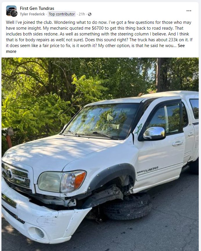

    $100 part and 30 minutes work per side for a normal person, but nope, now he's in for $6,700 to repair the truck. Worst part is, he mentioned noticing steering was weird leading up to this.
    Change your balljoints people, but stick with OEM.

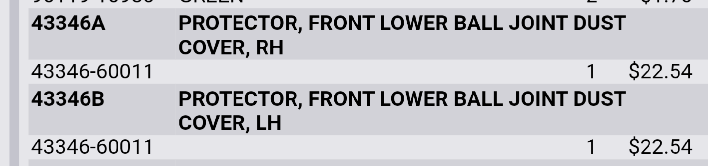

    Do they come as a kit? I’m curious if a kit version includes the dust guards since you cannot order the left one on an 02 (same part number and identical part whey they ARE in fact different)

    No kits for an 00 as it was not part of the recall. Toyota parts sites cannot identify the correct lower ball joint for an 00, so I had to do a lot of digging to make sure the ones I ordered were compatible. Still not 100% positive as the site said no compatible guarantee, but everywhere else I looked at showed these part numbers compatible with 00 models.

    I had no problem ordering left and right for my '02 from Ourisman Toyota, and both came with dust shields. Assuming we're talking strictly lower. If the uppers are different left to right, I'm in trouble...

    I’ll have to double check that part with what I’ve ordered. I’ve never gotten the dust shields included in the two LBJs I’ve ordered in the past.

    Now I'm actually waffling a bit...It might be that I reused my existing dust shields. I don't remember now. But they are at least different part numbers.

    I thought joints are different but shields are the same. At least that's what I just ordered. Based on looking up the parts.
    Granted I have an '05.
    Here's for '02:

    They’re physically not the same if you ever took a look at them (02). I should know, I’ve already been through it.

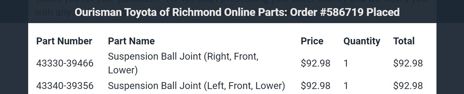

    I don't know about other dealerships, but Ourisman has been great about answering my questions. They usually respond to email inquiries within a day, and my experience has been concise, accurate responses.

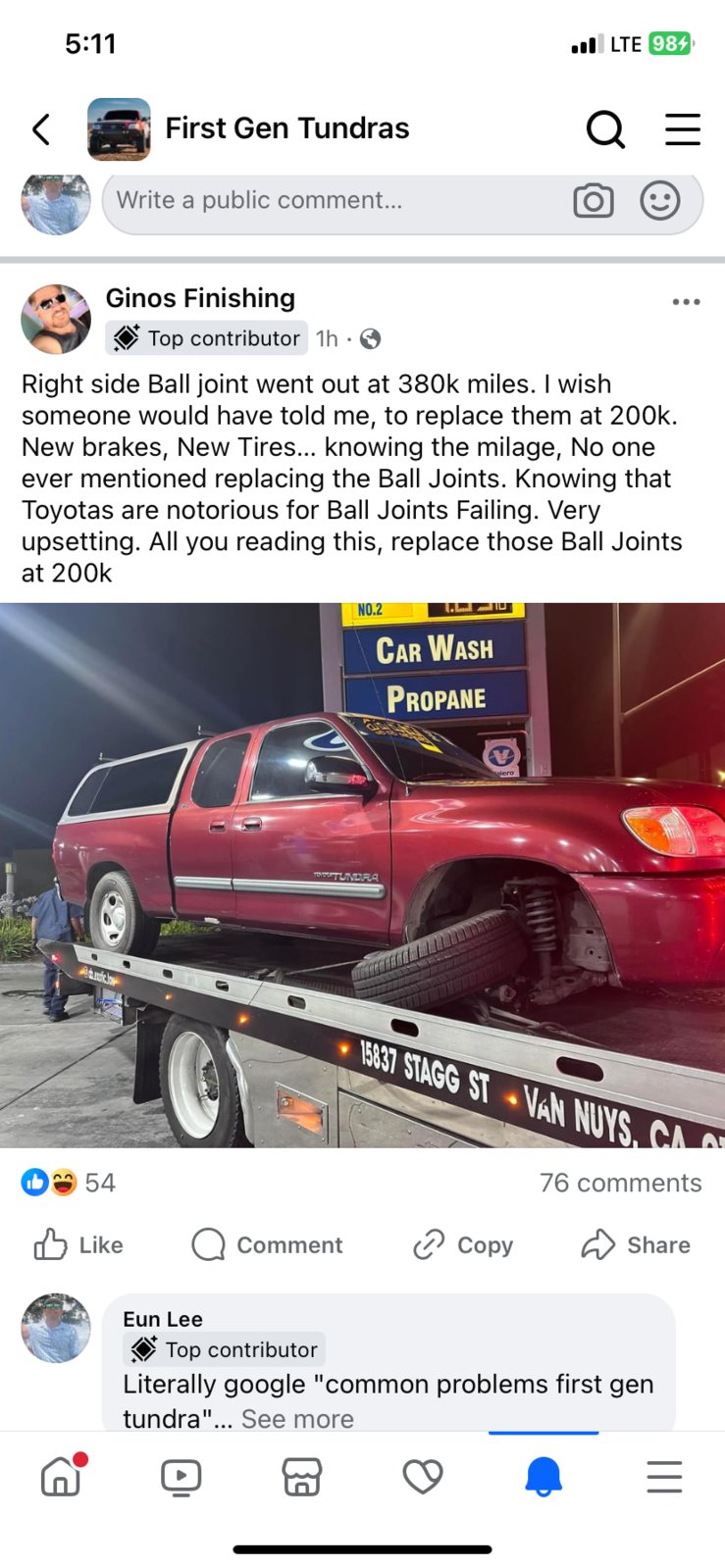

    that idiot let his ride over 350k

    Okay, that’s just negligence.
