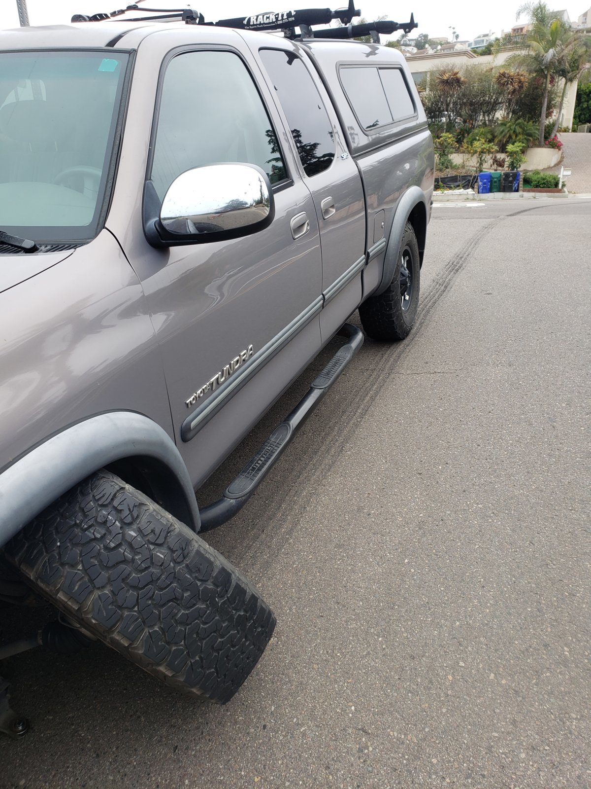

    SD Surfer
    SD Surfer Globe Trotting Bon Vivant
    Oct 13, 2022
    #84846
    1,851
    Bruce
    So Cal
    2019 SSM CM SR5 TRD OR 4X4 5.7
    Yeah, that was a bad day... totally fucked up my surfing that morning.
    Just started my left turn (an opening between cars that are going 50+) across the main drag coming into La Jolla, and BAM!!
    Sounded like the unmistakable car crash noise like someone but I know that wasn't the case... No impact, truck just fell on it's face. Took a moment for my brain to process what was going on, then no real choice but to drag/drive it across the two lanes onto the cross street. (BFG's are tough sumbitches)
    I can't blame the Tundra, she tried to tell me and I didn't pick up on it. I remember noticing that the steering didn't return to center as well as normal, like coming out of a U-turn when you let go of the wheel and momentum will straighten it out... it stayed turned more than normal, that should've been my clue.
    I got pretty lucky... no body damage other than the door/fender gap, fender got pushed up & out the tiniest bit. Probably not even noticeable to anyone but me 'cuz I knew.
    Replace 'em BEFORE they go boys, way better than after.

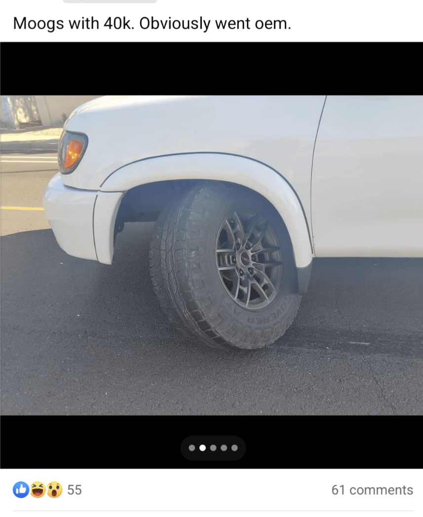

    Good morning. 40k for Moogs is surprising.

    I saw another one from some kids that stole a truck or something. Someone posted on here. May've been a video though?
    Anyway, that's why I/we couldn't find it, it was in front of my nose in the LBJ thread. @tokolosh's situation deserves having a full size photo so others reading this thread later see it, so here:

    Either I had a glitch in the matrix or you made this post yesterday? My phone says you made it just now...

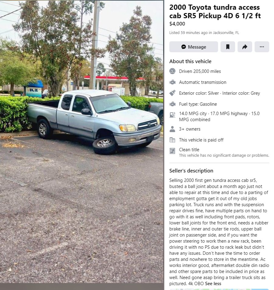

    Spotted on Jacksonville FBM, I'd call that pretty catastrophic and on an otherwise pristine truck:
