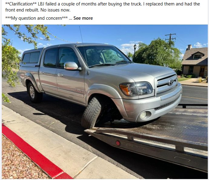

    Jack McCarthy
    Nov 2, 2020
    #54409
    10,258
    Bill
    North of Boston
    02 Tundra AC SR5 V8 4x4
    Poor design. Buying aftermarket only invites premature failure due to use of plastic internal parts unlike OEM.
    G_unit3000 and FrenchToasty like this.

    FrenchToasty
    Sep 15, 2019
    #36156
    18,348
    Mo
    The SoAz….. big surprise
    Bone stock
    Oem fails, yet oem is the way to go……..

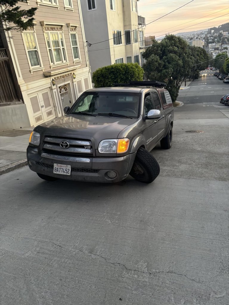

    That’s crazy. Appreciate the replies. My neighbor has an ‘01, I’ll have to ask if his have ever been replaced.

    Have you ever owned a vehicle with LBJs under tension, or always LBJs under compression? Coming from the GM world myself, I always dealt with the latter, and can't recall ever owning anything like the Taco/Tundra with LBJ under load. I didn't take the claims seriously. But after a few years of seeing up to a dozen people per month with their wheels tucked up into their fender well, and massive carnage, I started to get it.
    It's both.
    First .... This is a wear part, Toyota states that point very clearly in the LBJ recall bulletins, but there's no real "maintenance" for OEM joints. People tend to (ignorantly) treat it as though it's something that should last forever. I say "ignorantly" because I can't think of any car out of the few dozen I've owned in my lifetime that had magical everlasting ball joints. It seems if folks aren't ignorant to limited lifespan, they have an expectation the LBJ will give ample warning prior. Given the design of the OEM joint and how it sits in relation to other things, it's 50/50 on whether you'll see play in the joint, and I think that's off-putting to even your average mechanic who doesn't deal with this design often, if ever.
    Best practice: Treat it like the wear part it is, change out based on the part lifespan. And I'm not saying "part lifespan" as if every part is equal in quality/longevity, because they're not, that would be another poor judgment to make. For OEM, that means changing every 100k-125k miles, knowing we typically don't start to see OEM joints failing until 150k-175k miles on stock suspension. Aftermarket parts are all over the place, we've seen them fails as quickly as 5k miles, and others at 40k miles, but rarely lasting more than 25-50k miles. Consensus is: AVOID. Go with the part whose quality doesn't falter, and use fresh bolts, then proactively change like your timing belt and radiator: Every 100-125k miles.
    Second... It's a design, I wouldn't call it "flawed" necessarily. Other manufacturers use load-carrying lower ball joints, but I think it'd be preferable to opt for tension-loading design over the compression-loading design Toyota went with. I think if someone sold a load-carry conversion kit similar to what you can buy for the Jeep JK/WJ, which allows you to convert the upper 'follower' joint into a load-carrying joint, effectively splitting the load between the upper and lower, people would buy it. I mean, I know Solo and TC both make unibal conversions, but I'd love to see someone put out a reasonable ($600-1,000) conversion that's OEM-grade, with inexpensive replaceable parts, to convert the front suspension to compression-loaded. But it ain't happening, because these trucks aren't popular enough, and the to-market cost would need to be more like $2k-3k.

    Good explanation, thanks. I have always dealt with the typical compression style… Honda, GM, Dodge, 4Runner.
    They’ve always given plenty of clicking notice when they were ready to be replaced.
    I had to do a double take on my ‘21 Tundra it indeed has the tension style of the 1st Generation. Good to know, I’ll put an asterisk on my checklist for that item.

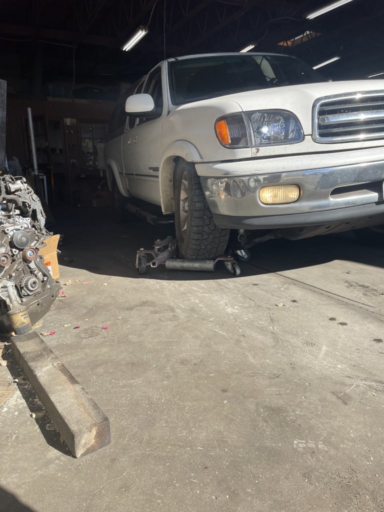

    AlexiosTundra02
    AlexiosTundra02 New Member
    Aug 11, 2024
    #121209
    6
    Ventura County
    2002 Tundra AC 4WD

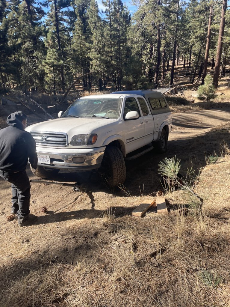

    Previous owner used Moog. Had to bring tools, parts, and mechanic up the mountain. Replaced driver side, drove 45 mins down, then drove 1.5 hour home when the second LBJ popped out. OEM ONLY LOL

    shifty`
    shifty` Just like witches at black masses
    Jun 20, 2020
    #48239
    28,375
    ATL
    '06 AC Limited V8/4WD
    Thanks for being willing to post this. And sorry for the bullshit you had to go through. It looks like maybe you got off mild compared to others - how bad was the collateral damage?

    AlexiosTundra02
    Aug 11, 2024
    #121209
    6
    Ventura County
    2002 Tundra AC 4WD
    replaced both LBJ with Toyota parts. After alignment, it looks like rack n pinion will also be replaced. This was my first time off roading and I got the full experience lol

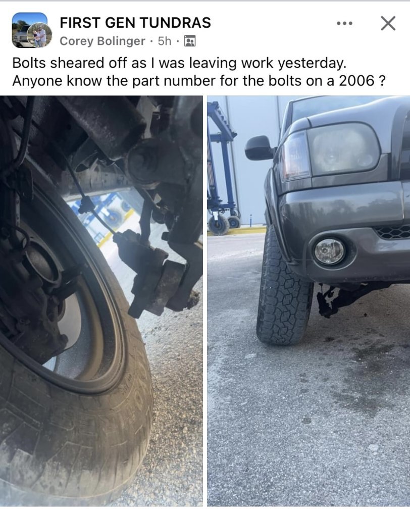

    Here's some BOLT sheering actionIMG_5184.jpgCHANGE YOUR GODDAMN LBJ BOLTS YOU CHEAP TWATS
