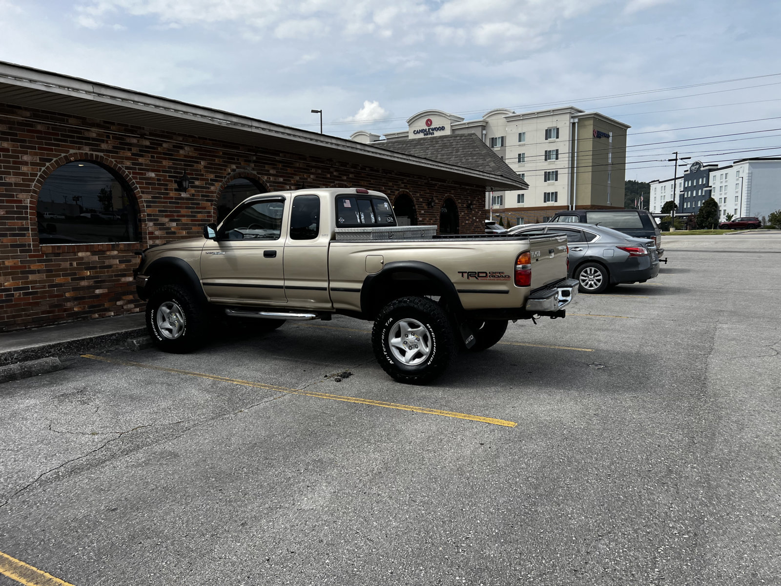

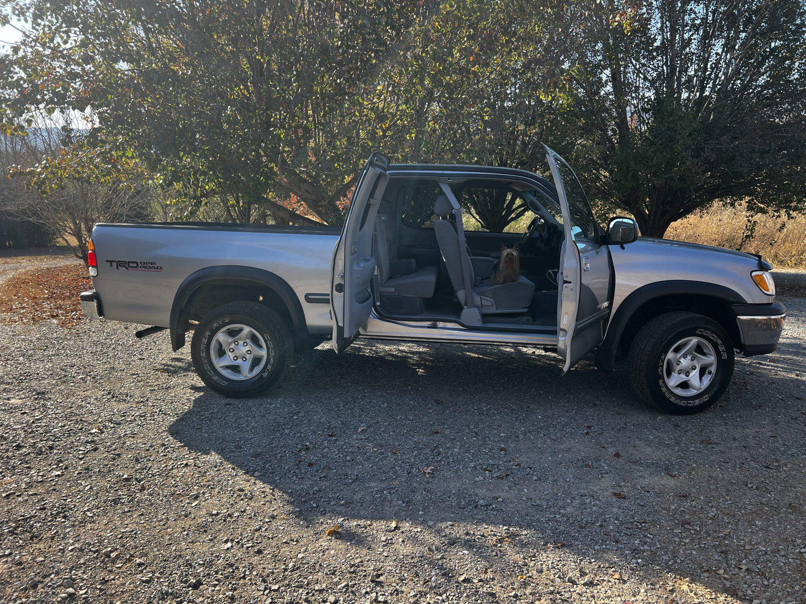

    I am semi active on the 3rd Gen Tacoma forum...I posted a pic recently about my son - he had a 2002 immaculate Tacoma . He was hit head on by a lady traveling the wrong way on an interstate. He fortunately survived (as did she). As you can imagine he had to replace his truck.
    He purchased a 2002 Tundra 4x4 Access Cab. It was a 1 owner and had the frame replaced by Toyota in 12 or 13. He wants to level it and add a bumper like on his tacoma (he had an ARB with a Warn winch). I have read much of what folks suggest - as has he. I believe we are ready to pull the trigger on shocks - we are going to have the coils added there. I believe we need the 2 1/2 inch option (2885) to support the weight of the bumper/winch he will add but not certain if I need the 3". Any help is appreciated. I attached what he's planning on buying and a pic of his truck.

    I would not go with the 2885 unless you plan on lifting the rear at least an inch or so, even knowing you're adding armor.
    I highly recommend reading the "Suspension, wheel and tires ..." section of this thread: https://www.tundras.com/threads/so-you-wanna-buy-just-bought-a-1st-gen-tundra-eh.115928/
    It'll give you the info I think you probably need to make an informed decision. Do not believe the lift suggestions any online vendor gives you, those numbers catered toward double cab (DC) 4WD trucks. I suspect you'll get a full 2" = 2.5" of lift up front from the OME 2885 which is pretty substantial. I got roughly 2" out of my Toytec coilovers and it's a radical difference which required nearly 1.25" lift in the rear to level out. You may want to go OME 2884 for closer to 1.75" lift, then let that front armor (if that's the way you go) pull the front end down another 1/8" - 1/4"
    And be ready to drop money on (at least) meatier tires, because that truck will look pretty goofy with stock tires. For reference, this is what my AC 4WD looked like after 2" of lift up front, no extra lift in the rear, stock tire size on OEM 17" alloys. PIC 1 and PIC 2
    Imagine another half inch lift in front .... you'll be even higher, at 2.5", it may end up looking a little whack. But maybe he wants that look, I dunno.
    There are also a lot of lift/measures with before/after in this sticky thread: https://www.tundras.com/threads/how-big-is-yours-measure-up.46186/
    My truck is on page 5, in a couple of different replies, documenting the various upgrades I made recently.
    Don't pay attention to what anyone has on a double cab. They're closer to a Sequoia than they are the access cab/reg cab.

    Just for reference (this is about as level a pic as I have), 2885 front, 2" rear 285/75

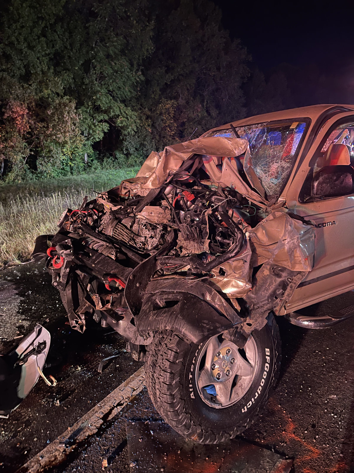

    The crazy lift in the from end is certainly Not want he likes lol...Here is a pic of his truck that was totaled...it is shiny because he just had it detailed...then he had the accident a couple of days later...the pics did help with the insurance settlement though. Pics of his truck before/after the accident (same week).IMG_0036.jpgIMG_3768.jpg

    Ouch! Glad he's OK.

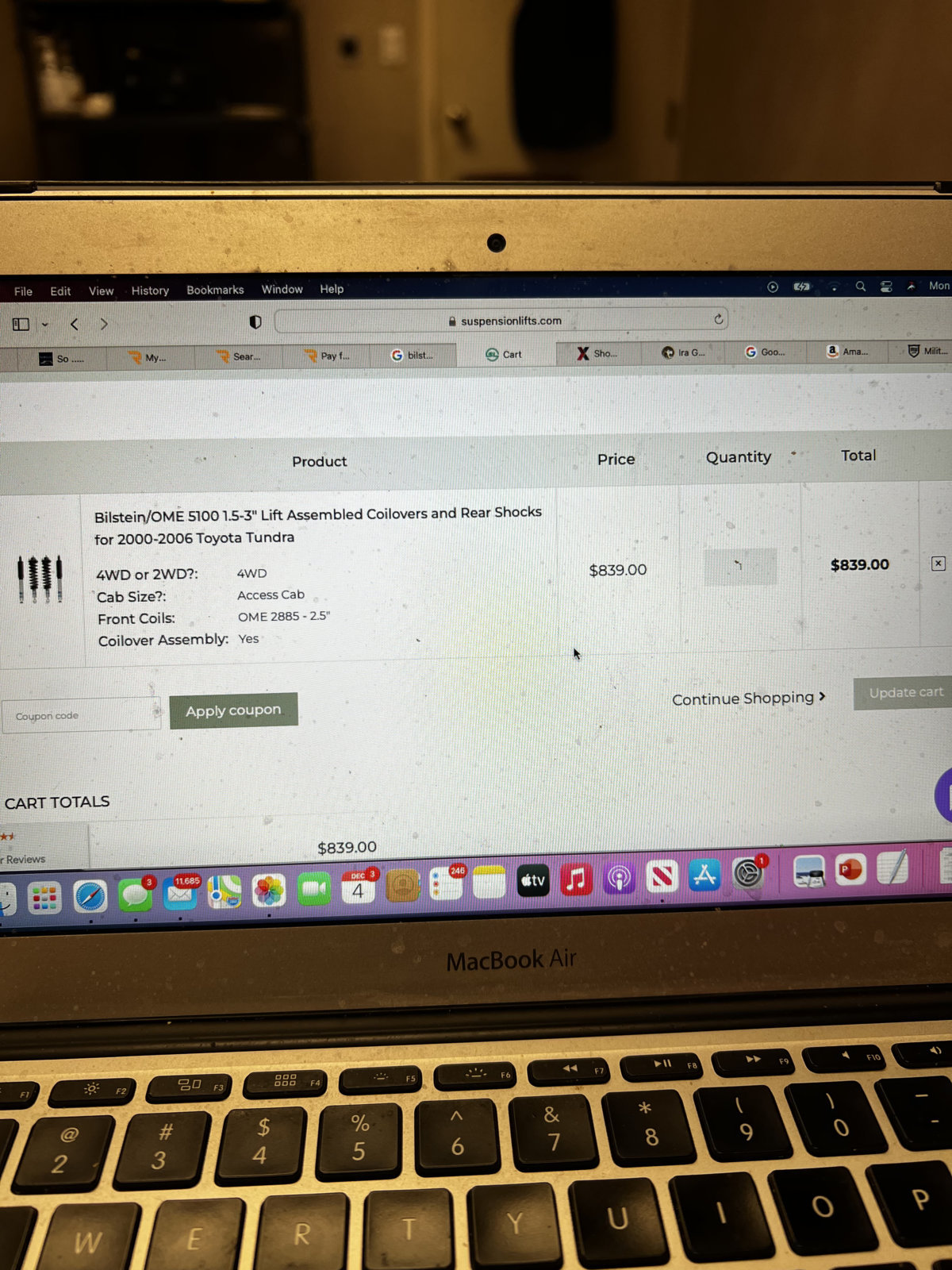

    If he wants comparable to what's on the Taco, 5100 + OME 2885 and some updated leaf springs in the rear (there's quite a few to choose from) should get him into that ballpark. The springs I went with for a solid 2" lift are linked in my signature, and run under $600 shipped. I believe it's @oscardog86 just put some (Archive brand?) medium-duty springs on his access cab and got around 2.75" lift judging visually, and that's with a bed-loaded camper on it, not sure what he paid (I'm guessing ~$1,100 based on my pricing a few months back).

    Thanks - he was not wanting to lift the rear but just level it. He is definitely not a mall crawler...in fact the closest mall to us is over an hour away...we own a horse farm on a river hahaha. He will tow some as well - he does construction for his summer job and does blacksmithing on the side - this truck will see a LOT of 4WD time.

    That's terrible. I'm glad to see that the cab is as intact as it is.

    Yeah I was so happy with how it protected him...the highway patrol thinks the ARB Bumper set up helped. He was airlifted and had a few surgeries (compound leg fracture...broke in 6 places and his ear was cut badly and needed plastic surgery). Long term prognosis is he will have pain forever but be able to go forward with life - he will commission with the Army in about a year and a half.

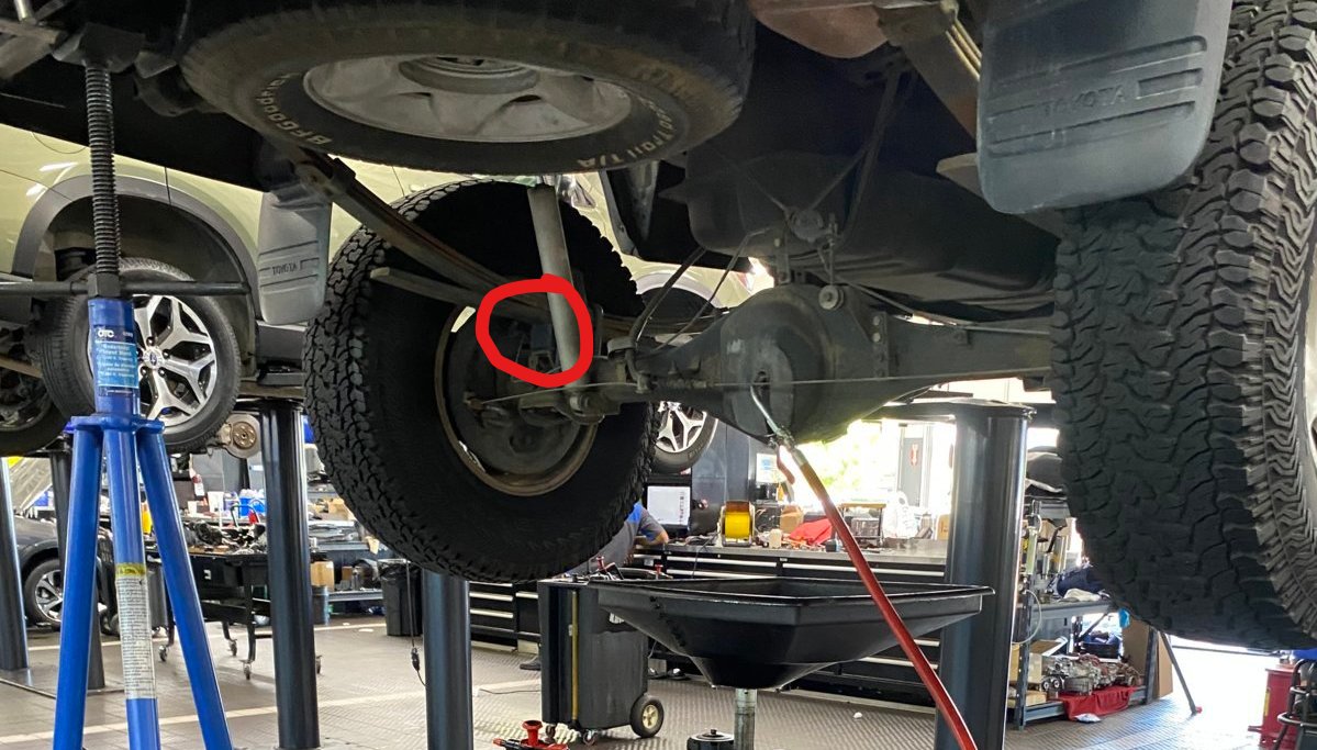

    OK...(actual Boomer gen here)...I do not see a way to click on your sig file for the leaf springs- help please. Thanks

    That does look great - so did you buy a new leaf spring pack (and make it 2" higher)? Thanks...

  27. Dec 4, 2023 at 11:11 AM

    Don't tell nobody, but they are leaf blocks. Like shifty said, not recommended for towing which it sounds like he'll be doing a lot of. I only towed a small tent trailer that had hardly any weight, so it was never an issue with me.
