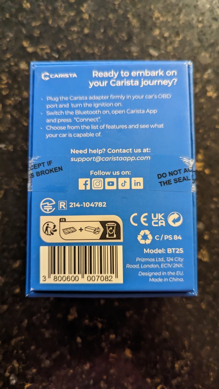

    The Carista was money well spent! Can turn off the fake sound any many other things. I turned off my seat belt chime for just the drivers seat (extremely annoying when getting out every couple hundred yards to open gates), turn signal changed from 3-5 clicks, as well as added the option to roll down all windows with a long press of key fob button.
    It does in fact work with the 3rd Gen trucks, just have to select the 2nd Gen option when setting up.

    Can you post a screen capture photo from you app that shows this ability, thanks

    Check post #37 on this thread with a picture of the Carista product that you will plug into your OBD port and follow instructs within the product.. You'll need to purchase a "monthly" subscription for about $10 that you can cancel as soon as changes are made and saved within the vehicle.

    I purchased the Carista module, etc, I can see and adjust a good number of things but I don’t see any options for engine sounds is why I’m asking. Thanks!

    Gotcha, I don't remember which category it's under but look for one that has two options, ESE and ANC. You only need to turn off ESE (Engine Sound Enhancement) to get rid of the fake engine noise. You should actually leave ANC (Active Noise Cancellation) on as it helps keeps the cabin quieter.
