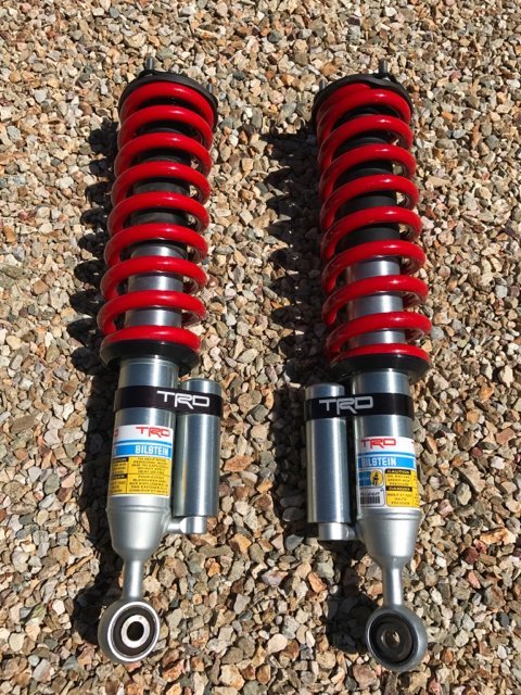

    Saw this on Tundratalk...
    For the benefit of the Tundra community, I had the stock TRD Pro front coil springs tested for their spring rate at @SDHQ since no one seems to know what they are. The test came back at 621lbs/in. So when new, before powdercoating, they were likely 650lb/in. springs. These are off my 2016 TRD Pro Crewmax - I don't know if they would be any different for the double cab. I know dampening plays a huge role in the ride quality, but this info would seem to suggest that maybe 650lb would be a "best fit" spring rate for off-road performance and on-road comfort.
    Also, if you pay close attention to the pics, you'll see the driver side, bottom spring perch is set a notch higher than the passenger side to account for the "Toyota lean".
