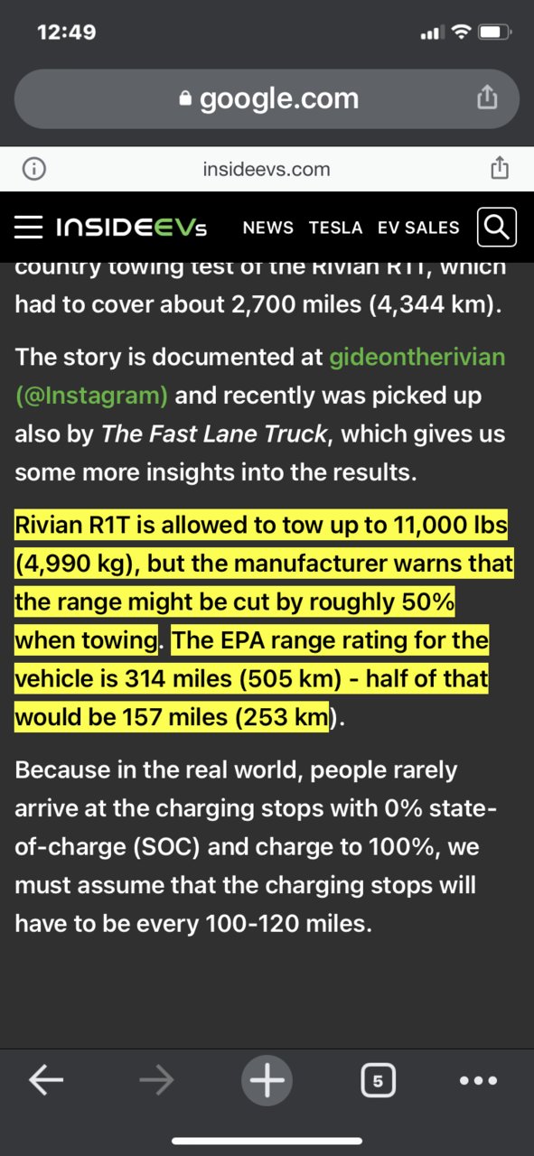

    Right from Rivian.
    Now if you are going up grades, most likely even shorter distances.

    The Rivian tow test was conducted with a Astro Van on a car trailer. Although someone said that the Astro was "shaped like a brick" the Astro is actually quite aerodynamic.
    Those pulling a travel trailer or tall boxy trailer will see an even sharper reduction in range

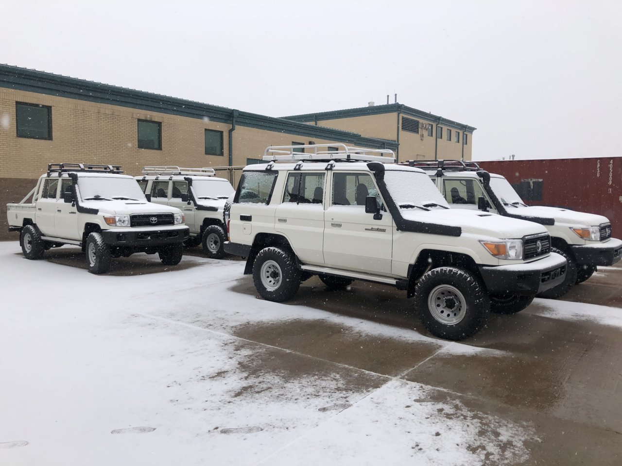

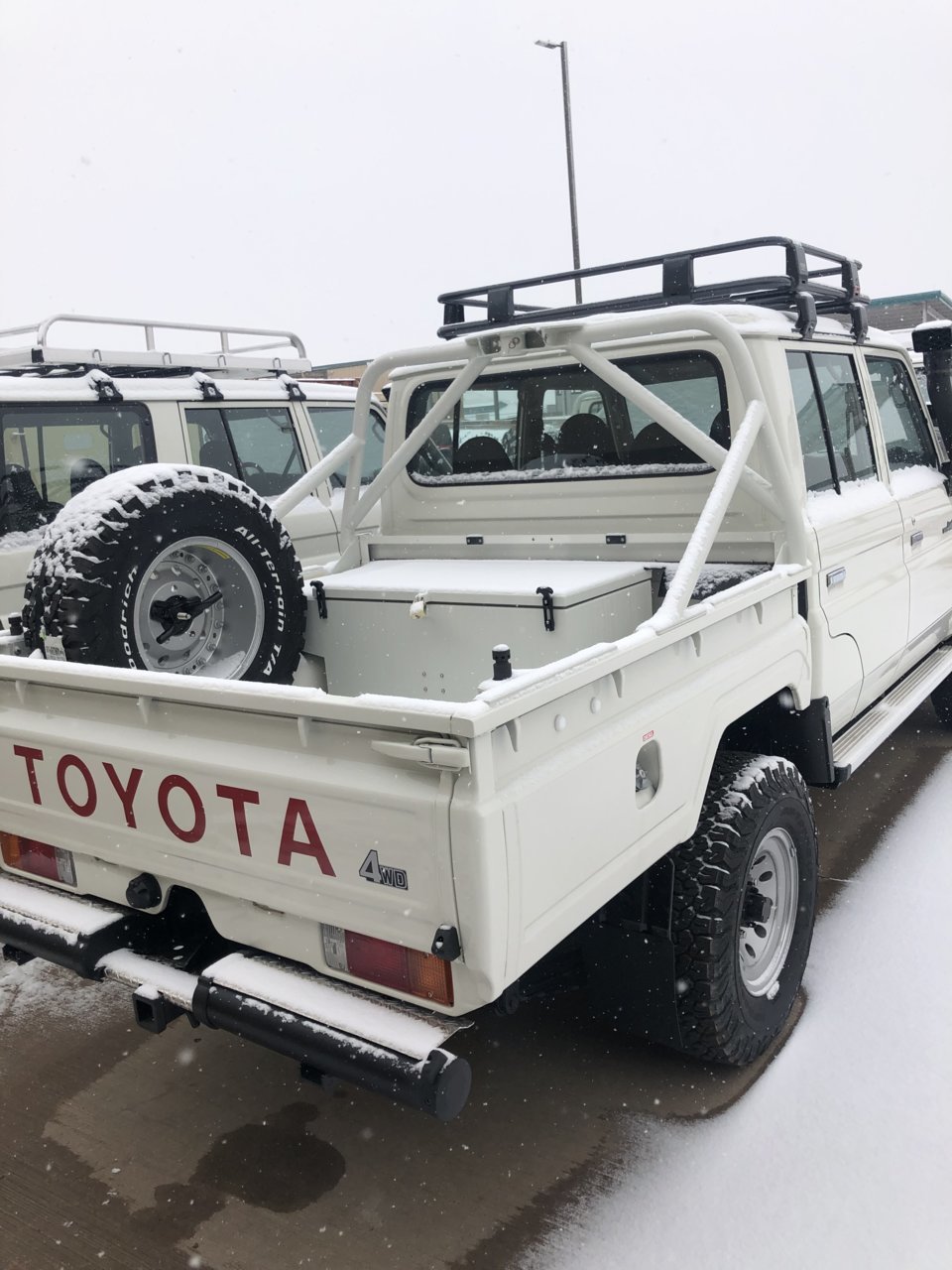

    This makes me wonder if these regions will start importing vehicles that normally would not be? I wouldn’t mind seeing a Toyota LC 70 series…:devil:

    I'd buy one of those in a heartbeat.

    That thing looks like an RC car.

    Same here. These are purchased for SF soldiers to train with. Wish we could get this new of a LC to play with.

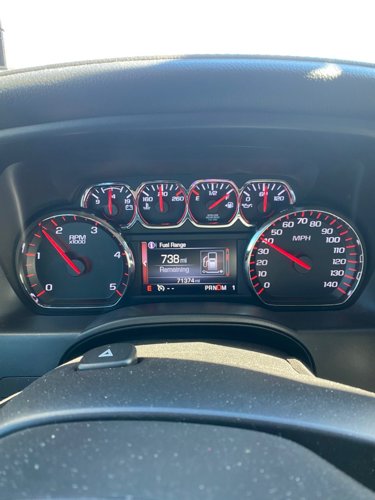

    When I start seeing this kind of range out of an EV…I’ll consider.
  22. Dec 19, 2021 at 6:57 PM
    #52
    34,437
    18" TRD Off Road Wheels
    I'd be ok if the real world performance could match what I get out of my tundra. I average about 475 miles listed range, and if I am pushing it I'll drive 400 without fueling.

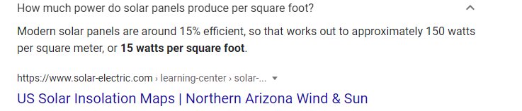

    Thank you for the power requirements. It helps visualize the needs of the vehicle.
    Now, I don't know how up to date this is as it's all just a quick google search skim, but it looks like a square foot of panel only nets 15 watts. That I think is going to be the barrier to their use in a vehicle, @Baja Mike. So, for practical use of something like the rear defroster using 500w a 3 square foot panel would generate about 9% of the needed power (45w/500w=0.09), but add how much cost to the vehicle? Perhaps if solar panels were about twice as efficient and half as expensive we would see them used?

    Solar panel math can get pretty confusing, but to simplilfy, if you mount (2) 100watts panels (about as much as you can fit) on a car expect about 700watts a day in good conditions. This would equate to about 2miles in charge, or .7% charge of a battery.
    Where panels become more useful is on your home. I know my local area and will use the math for this area.
    in San Diego SDGE pays or bills you for electric power based on the time of the day call TOU, with a 2KW system you can get 14k miles a year (charging at midnight to 6am, when power is extra cheap)
