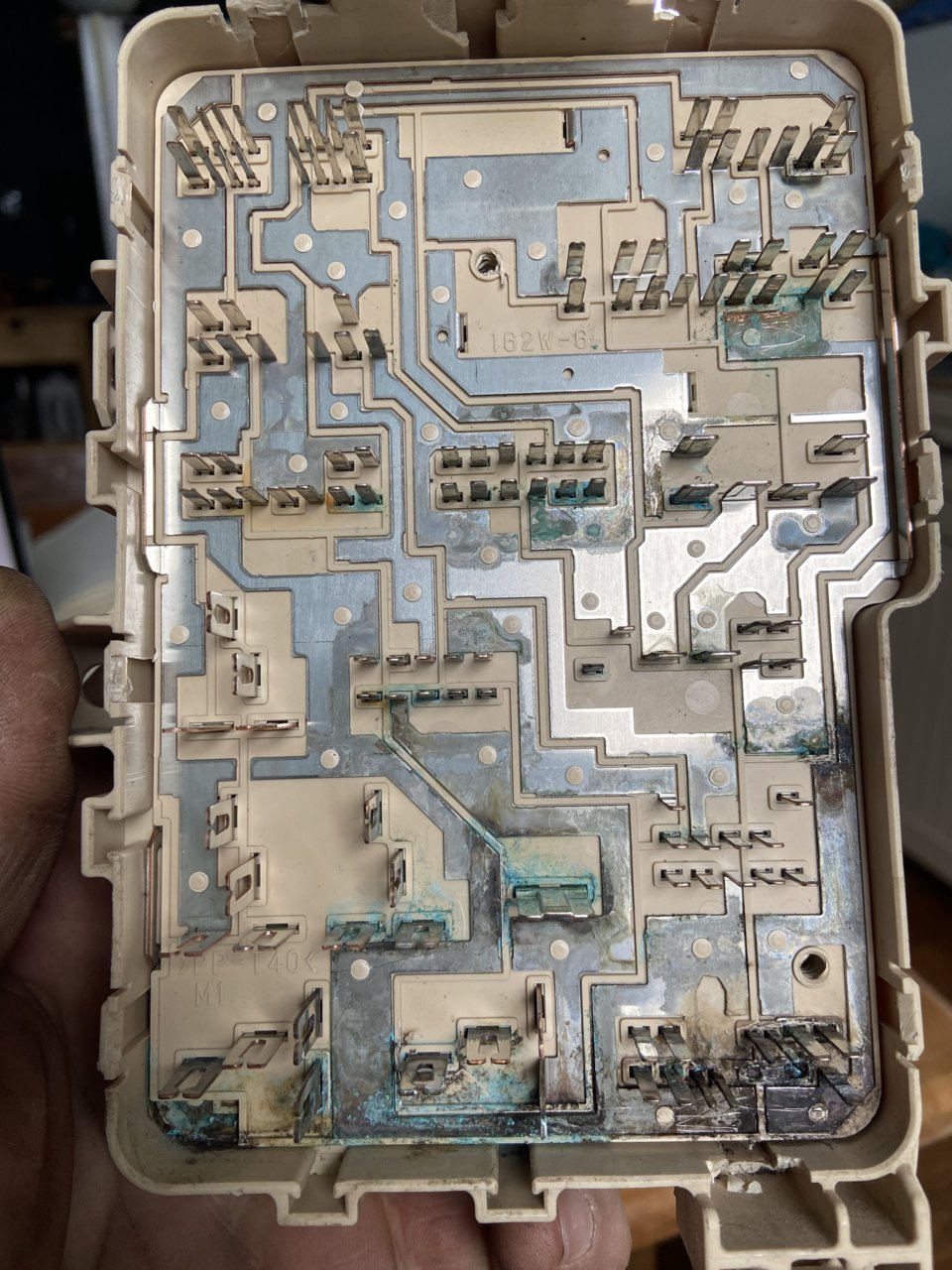

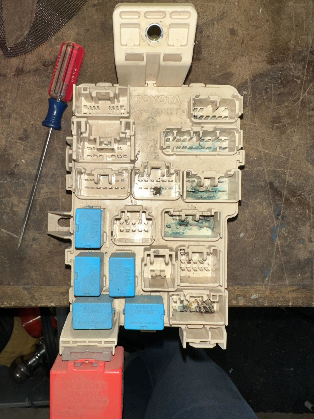

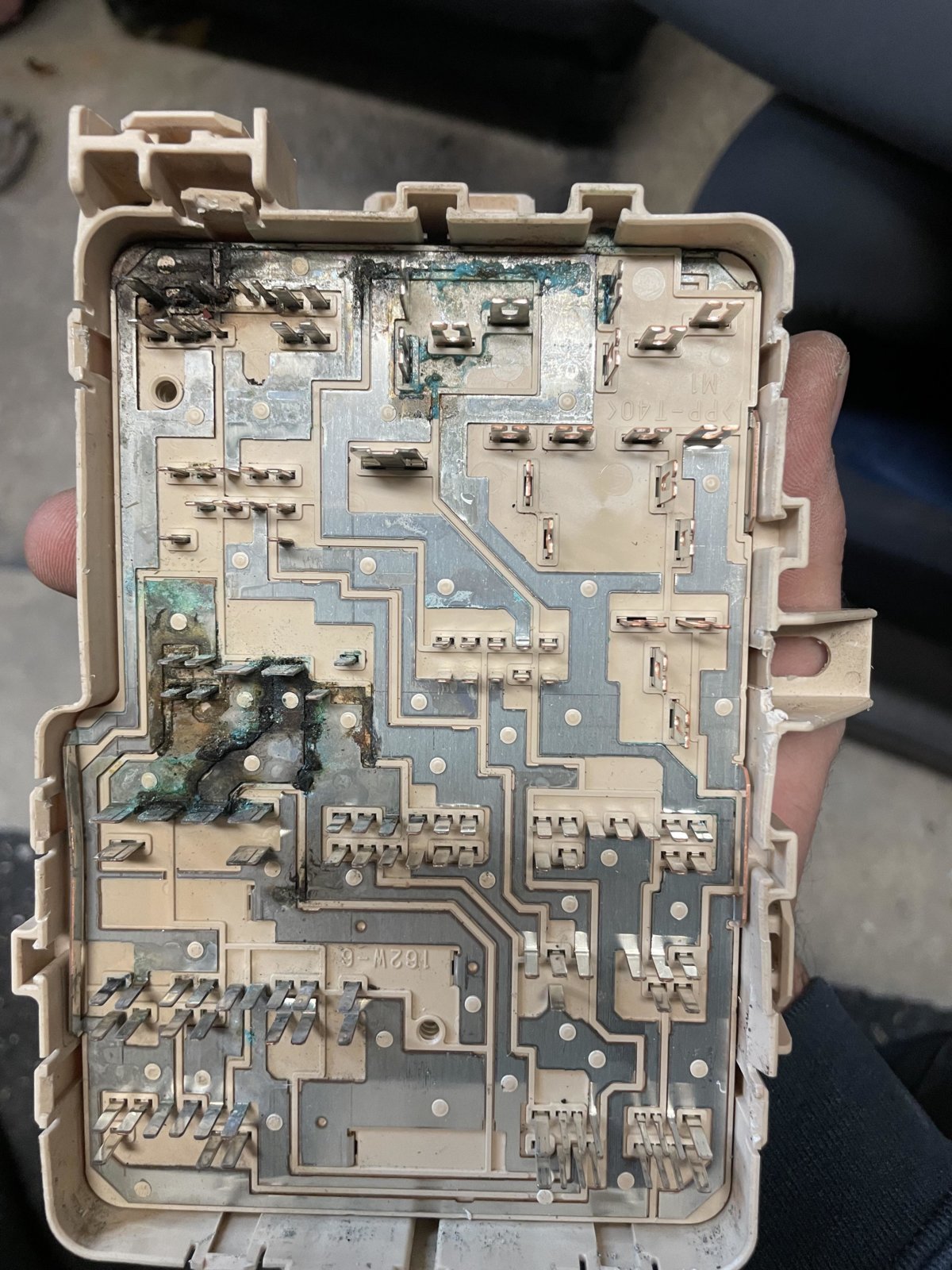

    If you have no signs of aftermarket alarm, then it sounds like you’re our newest victim to “water damage in the fusebox”.
    Entry is often thru cracked windshield, rotten window surround or the A-pillar (via windshield trim holes, or rubber door seals).
    Taken from the thread I mentioned, note the last three picture links here:
    Occasionally, water trails down harnesses into the ECM behind the glovebox (pics, pics), or the in-dash fusebox (pics & pics & pics) it happens a LOT.
    It’s also possible you have water leaking into the bulkhead of connectors under the driver kick panel. But usually when it’s multi-circuit stupidity like you’re referencing. It’s, like, quite often the exact problem you’ll see pics of above.

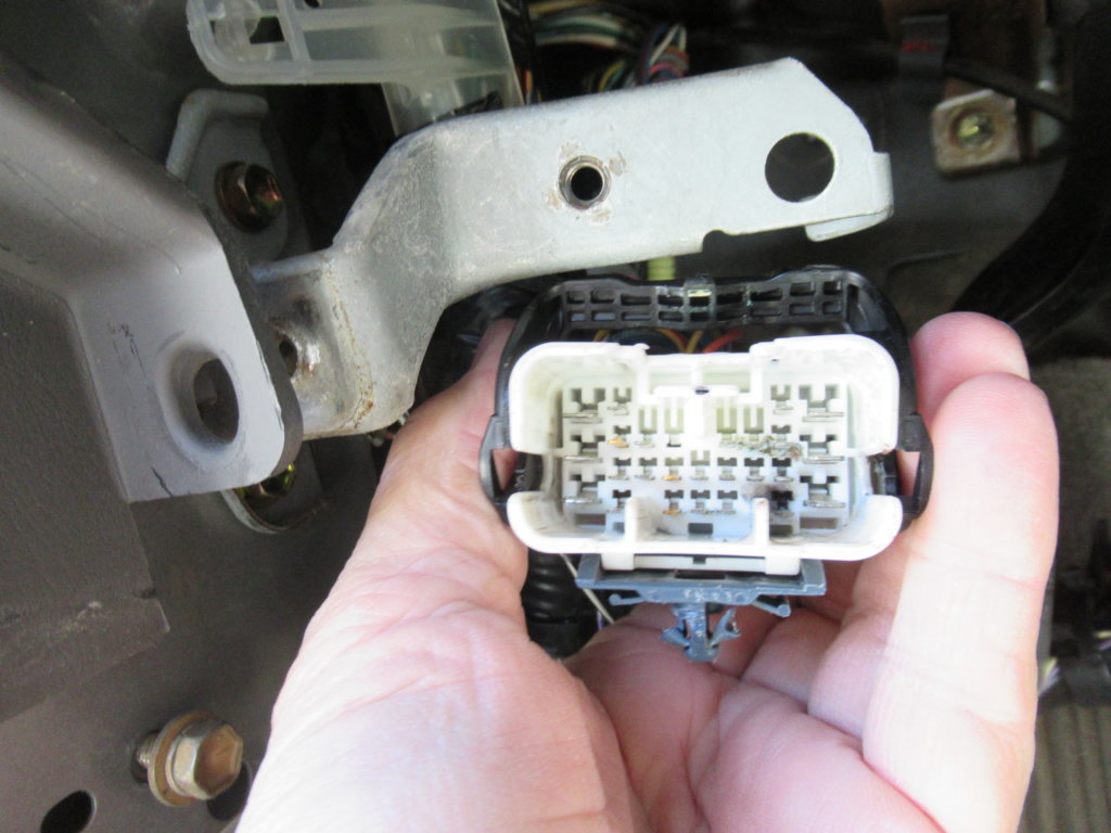

    But anyway, even still. 100% my next course of action would be to pop out and inspect the fusebox for traces of green (oxidized copper) and rotten connectors on the back of the in-dash fusebox. Some pics of what others have found - like I said, very common issue, and because the internals of that fusebox are basically a logic board with traces, of sorts, corrosion will cause all kinds of weird results as circuits get bridged or rotten.
    It won't always be as obvious as these cases, but you probably DO NOT need to crack the fusebox in half unless you see green under some connectors like the first few pics - but also see the last three pics for a less-common case that still happens, where pins in one of the connectors right there will take on water from the windshield or A-pillar (I hope you're not one of those people who continues driving with a cracked windshield...) and rot out connectors. This is the kind of stuff I'd be looking for, since we KNOW it's pretty common, and not just for trucks that live outdoors (although it seems more common in those).
    And that smaller connector, here's what was inside:
