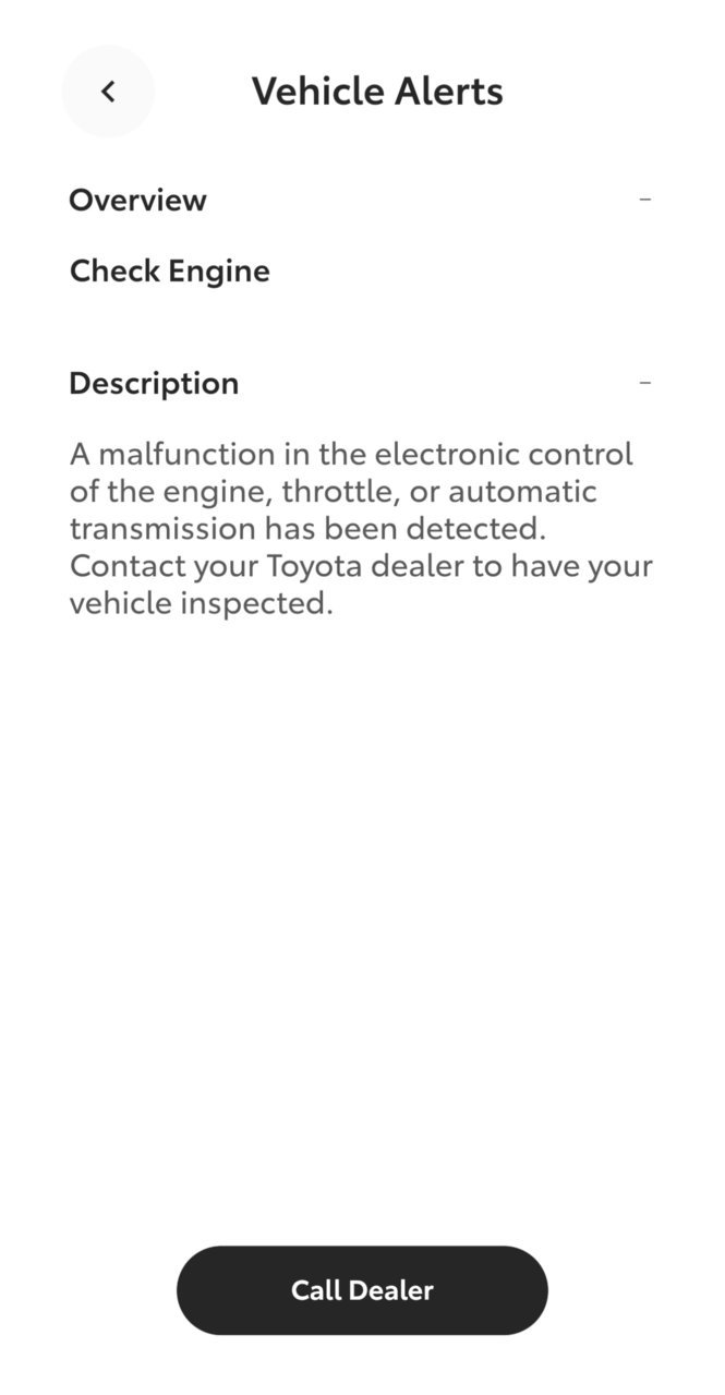

    I know this is probably not necessarily indicative of anything, however, the same error message I’ve attached appears in my Toyota app and it hasn’t cleared while the techs have been attempting to diagnose/repair. They indicated that the process has taken a while because Toyota corporate is making them run a full series of diagnostic tests, so I’m not actually sure if the alleged overfill of oil is the culprit or not, at this point.
    Also, the only time I noticed oil leaking was after the engine failure, when the tow truck driver was loading the truck; I think you can see some of the oil drops in the first pic I posted.
