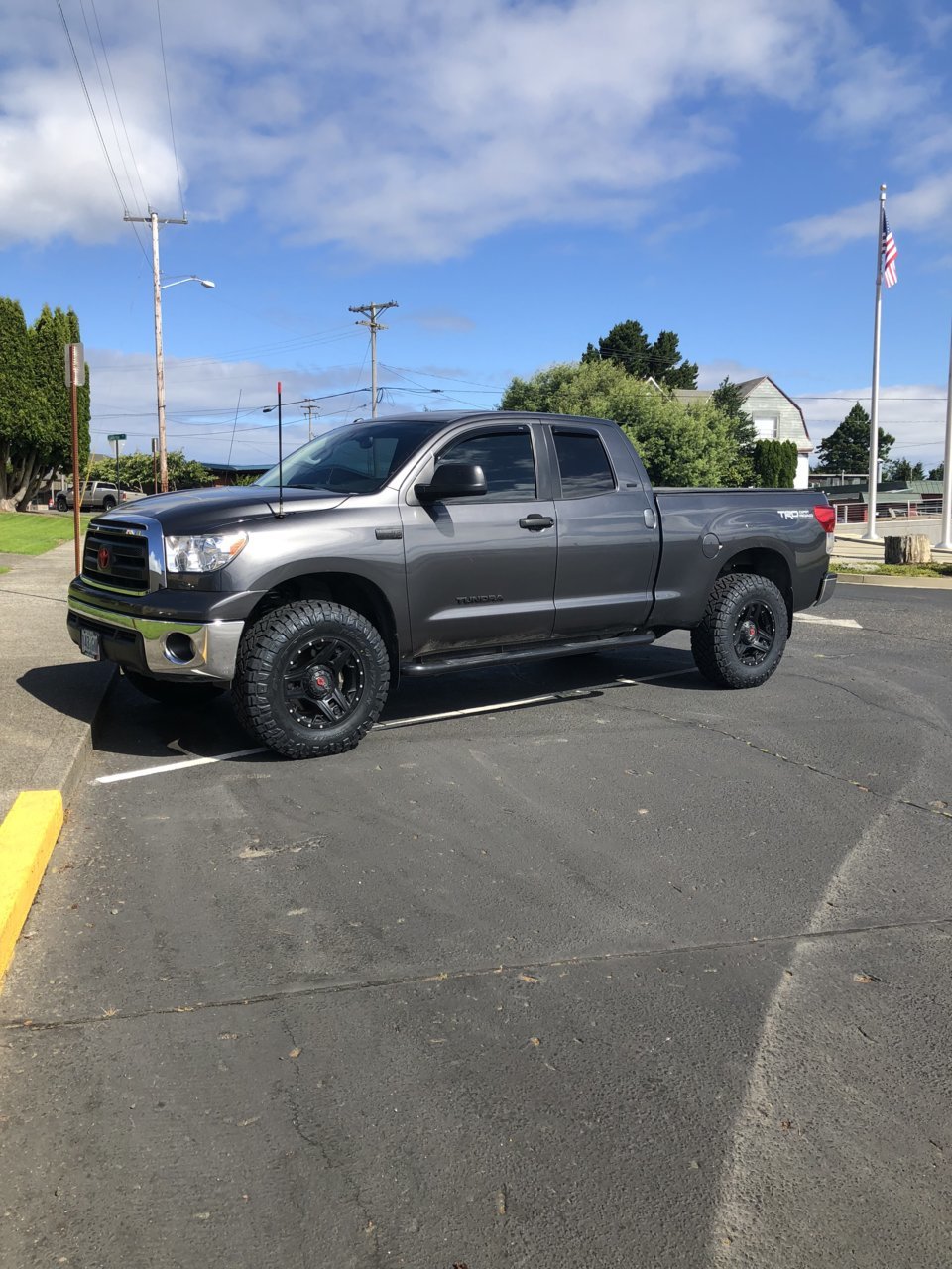

    I just had this lift installed last week, and added Nitto Ridge Grapplers 35”x 11 tires, and went to the Oregon desert for a week. Very nice ride on and off pavement, soakes up the bumps well

    :cheers: Looks killer!

    Awesome RIDE Brother!!! I installed the Eibach 3/1.5 as well and love it and now researching wheels and tires. Was wondering what your wheel offset is? size of wheel? Also did you have to trim anything so it will not rub at full lock. Thanks in advance!

    The wheels are 18 inches, not sure on the offset I’ve had the wheels for 4 years on the truck. I went with the 11 inch wide tires hoping that I wouldn’t get any rub, but did have to remove the lower front mudflaps and the rear front mudflaps I’ll have to modify the rear ones. Still getting a slight rub off the road front of the fender and the body mount but it’s not bad

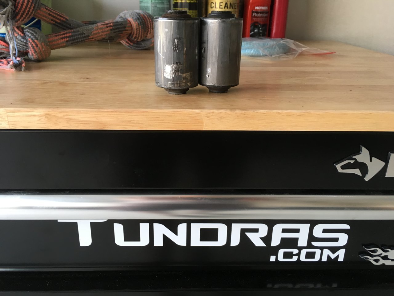

    Had some time today to install the lower poly bushings for the shackles in the leaf springs.
    @csuviper do you have a pic of your lower bushings torqued at a similar angle? I found your other pics but not close enough to see the bushing. Both upper and lower are torqued to 77ft lbs. The lower bushings are compressed more and it seems with poly that is not ideal?

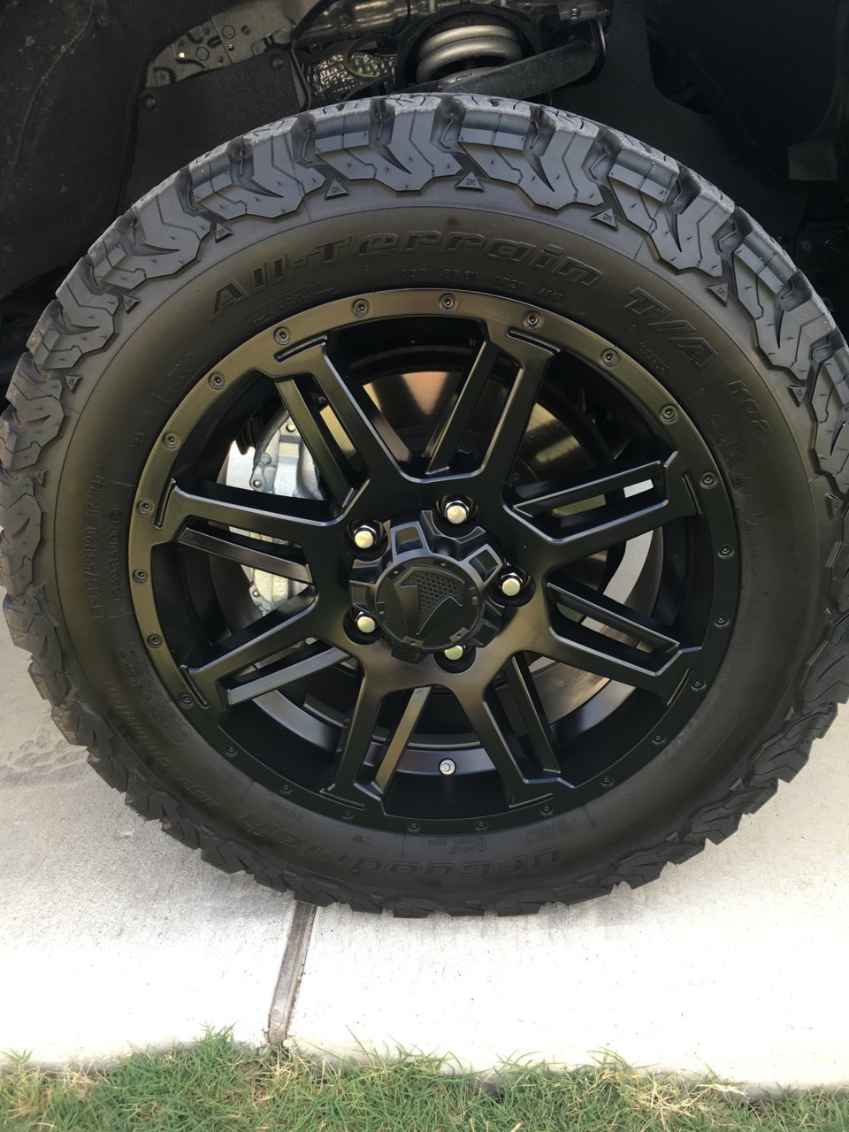

    Are those the stock 20" wheels just powder coated black. I am thinking this same tire on my wheels.

    They are the stock black 20” wheels.
