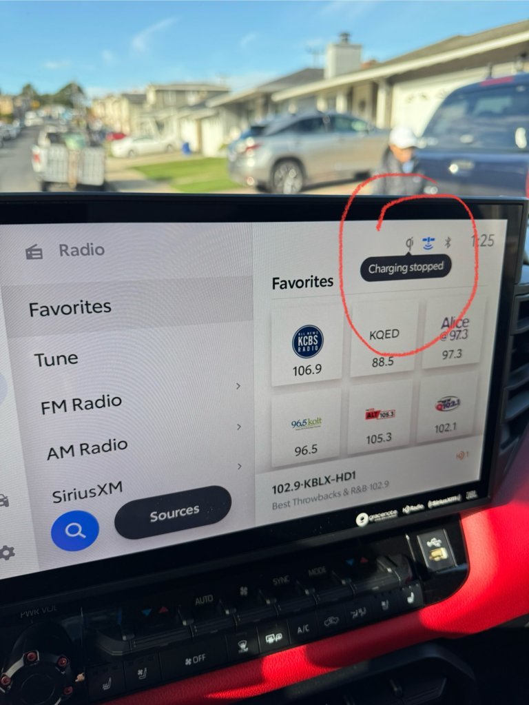

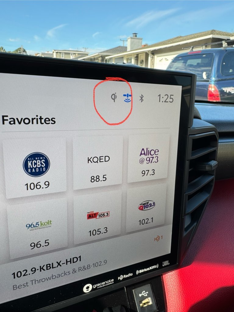

    In the non CarPlay the qi charger shows up in the top right, and it will say in a banner across the top charging or charging has stopped

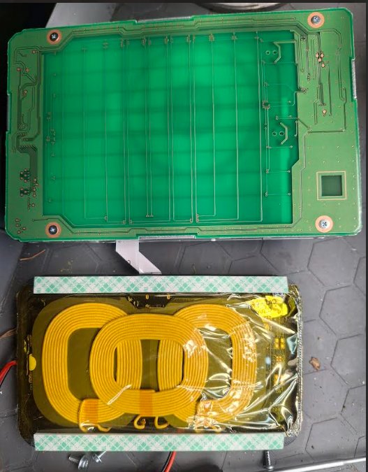

    Yes, was shipped promptly after contact. Installed it tonight, works much better than the OEM, at least it immediately connects to my S21 with otterbox where as the OEM required finding the best spot. I'll reports back after some longer term usage.

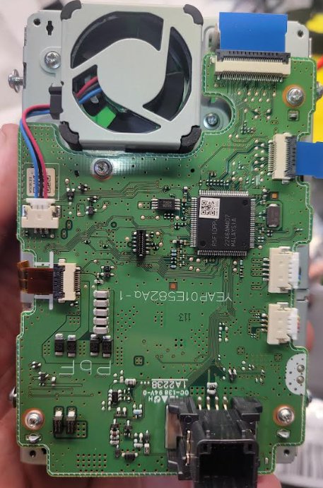

    Here is an image of OEM vs EEF. Interesting that OEM has a fan where eef is passive cooling.

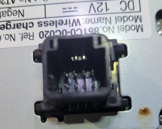

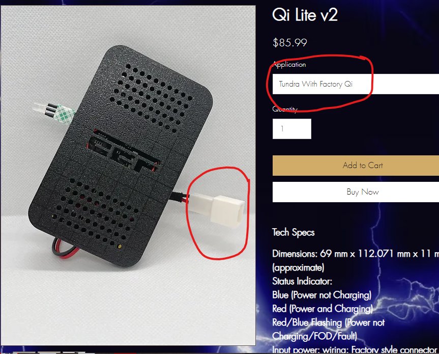

    Thanks, does it plug into the oem power source or do you have to plug into a usb-c in the center console? I have seen it being done both ways.
    Thanks again.

    Used the OEM connector. Plug-n-play

    Was looking at the install video, it showed plugging the charger into the usb in the center console. Your version you didn’t need to?

    correct. I replaced the factory unit, plugged into the factory connector.

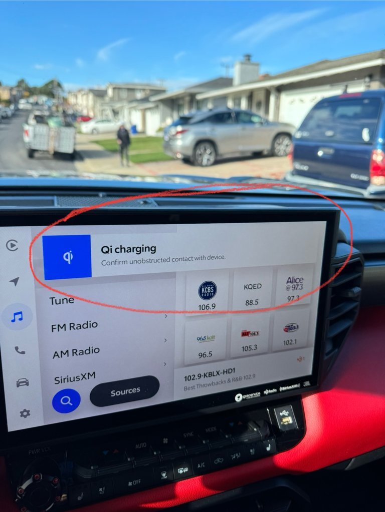

    With the eef does it pop up and register on the head unit like the factory one?

    My factory did not, neither does the EEF.

    It doesn’t display (see images)

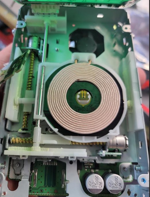

    So that is what that symbol is - curiosity never rose to the level to break out the manual. I've seen it, always been the same which I expect as my phone seldom charged. The EEF uses two pins on the connector, the OEM appears to use 8 pins which explains the feedback to whatever module (BCM?) updates the display.
    Took a few moment to interrogate the OEM - impressive. EEF uses brute force to connect with 3 coils. The OEM is smarter in that the charge coil searches (XY motors) for the optimal position to charge, or at least it appears to be designed that way or it knows the phone model and has a lookup table for position. It also has a cooling fan.
