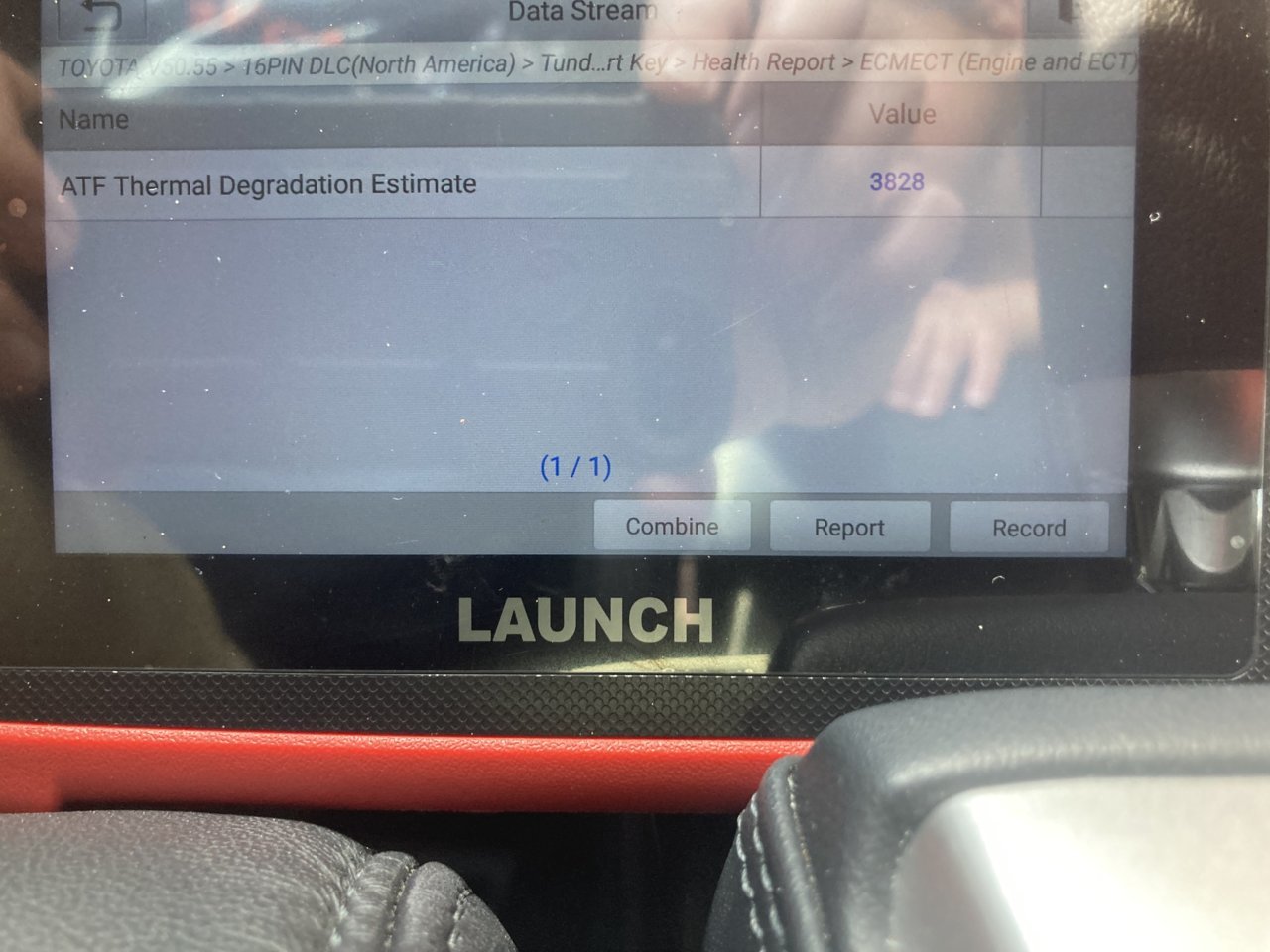

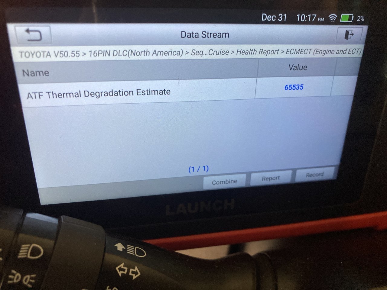

    Another data point:
    2020 Tundra, 50K miles, 2970 - has aftermarket transmission cooler
    2014 Sequoia, 98K miles, 65960 - does not have a transmission cooler
    I have a sample of the transmission fluid that will be sent to Blackstone to see if the correlation and counters are correct.
    LS3, Chip_Tundra, Oey12 and 3 others like this.

  15. Aug 25, 2023 at 11:19 AM
    #75
    Joe333x
    Joe333x Member
    Apr 4, 2019
    #28632
    1,920
    Boston
    2019 Tundra CrewMax Platinum
    Thats actually the maxed out number I believe. It cant go any higher. You can reset it easily with TechStream.
    Edit: the number it maxes out at should be 65535 according to some other Toyota forums. https://www.tacomaworld.com/threads/atf-thermal-degradation-estimate-from-ecu.535949/

  19. Aug 25, 2023 at 2:08 PM
    #79
    yakeng
    yakeng 3URFE Apologist
    Mar 9, 2023
    #93554
    847
    2020 Tundra 4x4; 2014 Sequoia;
    ECGS Bushing; GCS Cooler RASHD; Fox 2.0
    Here’s the value, I accidentally mixed some numbers, but it’s maxed out.it is indeed 65535
    Joe333x and ZappBrannigan like this.

    #80
    yakeng
    Mar 9, 2023
    #93554
    847
    Tundra with cooler. Thought it was 2900 (apparently I need short term memory exercises) but it is 3900. Still a pretty big difference. I have doubts on the accuracy of these counters, so it’ll be interesting to see the Blackstone results.
    Joe333x, ZappBrannigan and Terndrerrr like this.
