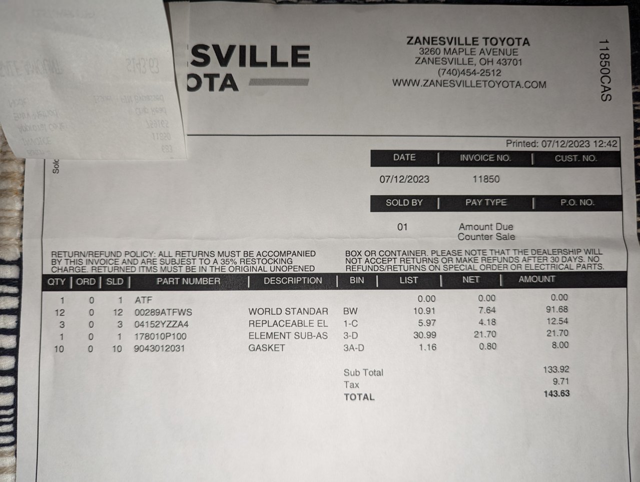

    Looks like I’m the odd one out but here goes nothing…….….with my 2021 SR5 I change my transmission, front/rear diffs, and transfer case oils every 30k. Engine oil/filter, engine and cabin air filters every 5k. All AMSOIL except the transfer case where I use the ridiculously priced Toyota stuff.
    When I realized my truck did not come with a liquid to air transmission cooler I started researching transmission fluid characteristics. What I found was at around 240* transmission fluid breaks down and starts to varnish. I thought, that can’t be good.
    Turns out the 2019, ‘20, ‘21 Tundras all had their liquid to air coolers removed and replaced with a liquid to liquid cooler that’s about the size of a spin on oil filter cut in half. I’m not sure about the 5.7L Sequoias.
    At 12k miles I installed a factory Toyota transmission fluid thermostat, factory hard lines, soft fluid lines and aftermarket cooler from Genuine Cooling Systems. I’ve got just under 55k on the truck now.
    Today was pretty warm at 107* ambient. I drove up a slight grade on the freeway (not towing) for 8 miles doing 60-75mph. The TFT reading on my scan gauge topped out at 192*. It’s my only vehicle so spending the money I do in maintenance is doable.

    Speaking of WS fluid, I noticed some dealers sell for 30% off online which comes to $11 something/qt. I stopped at the Zanesville OH dealer on Wednesday and asked him if he price matched. Oh boy did he ever. I bought 12 qts for $91.68 before tax. Since about 30-40% of my 22,000 miles has been towing I'll do a drain and fill soon and each year afterwards.
