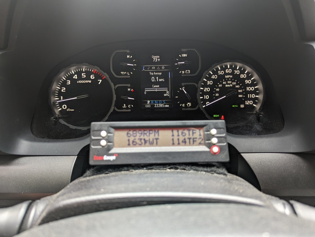

    Speaking of drain and fill procedure, does anyone have the official word from Toyota on how this is done? I thought I had seen copies of service manual pages but can only find a TSB for the 2007 MY.
    There seems to be a lack of consensus among members here of almost every aspect of doing this. One person said his newer Gen 2.5 didn't have the pin 13 in his OBDI port. I plan to use the jumper trick to put mine in trans fluid check mode to get the idle down so I'm hoping the 21 MY accepts that process. One more question...Since I run a scangauge and I'm pretty sure the scangauge plug has both male and female ends, can I leave the scangauge plugged in while the jumper between 4 and 13 is used? Sure hate to smoke something.
    Edit: Right after posting this I pulled the OBDI connector down where I could see it. First off the scan gauge connector is closed on one side so it must come off for the jumper trick. Second, my 21 does not have a pin 13 so the paperclip trick is out.
    At 73* this morning it took my truck 8 minutes to reach 115* fluid temp. The idle had settled long before that so I have little concern about lowering the idle speed when checking.
    Another Edit: Job done. As mentioned in a quote to 2muchfun I found my trans overfilled by 10oz. I drained the fluid and got 3 qts on the nose after removing the excess 10oz. I put 3 qts plus 8oz back in and did the check procedure again. This time only 8oz came out so I should be spot on. BTW, with a full tank of gas the trans pan was level.
    The worst part about the whole job was there were four concrete slabs with the expansion joints coming together in the exact spot where my creeper wheels decided they needed to be.

    Why not just use the temp reading from the scan guage? You should get really close just measuring what you drain and putting the same amount back in as long as it's about the same temperature.

    Two reasons: the TSB for the 2007 mentioned inaccurate readings if the idle wasn't reduced while in check mode and how do I know the amount in there now is correct?
    I'm going to put the truck on ramps and level it, put a big ass fan blowing under it and once cooled repeat what I did this morning and once 115* is reached, pull the overflow plug to see what comes out. If any.
    I have a translucent 5 gal bucket I'm going to mark graduations so I'll know close to exactly how much came out.
    I'll drain overnight and fill in the morning.
    Edit: I checked it starting at 116 and finished at 126* F and got out 10oz of fluid before it trickled. So it was 10oz overfilled.

    Yeah, I saw that doing the jumper reduced the idle and I also considered that someone else maybe didn't fill it or check it properly the first time. Both are logical reasoning and you seem to have a logical plan too. Just be sure to loosen up the fill plug before you drain a drop. If you ever added a cooler, don't forget to pin open the thermostat as well. Be safe while you're wrenching!

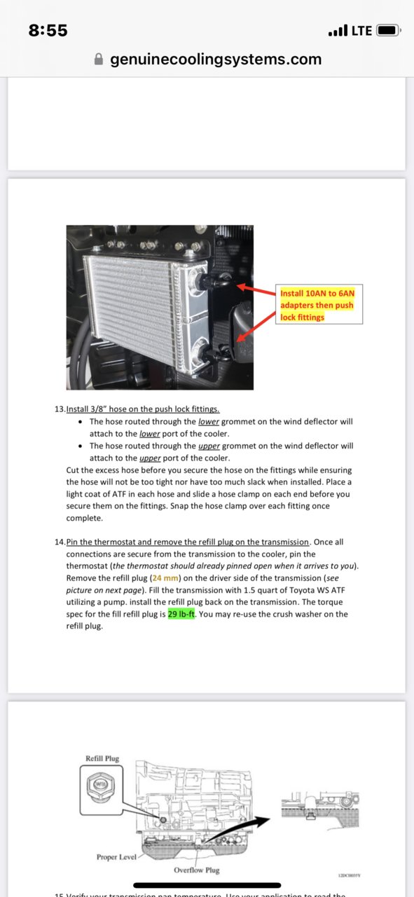

    Here’s one that just came to mind.
    I’ve got a transmission air to liquid cooler/thermostat, etc.
    Is there any detrimental things I ought to be aware of if driving city/interstate in temps ranging from 105-118 degrees with the thermostat pinned open?
    I conducted an experiment yesterday driving upgrade on the the interstate (98-102* ambient) speed 65-75 for 16 miles with it pinned open and then pin removed (closed). Not towing or loaded up.
    This particular part of the interstate has a significant hill of 5-6 miles.
    Pinned open it maxed at 194*.
    Pin removed it maxed at 204*
    Any thoughts on this?

    I don't think its going to make much of a difference, the issue with leaving it pinned is warm up temp, especially in the colder months since the torque converter wont even lock up until its over 100°. Optimal temp is around 185° thats when the thermostat opens up. I pinned mine once just to experiment but I dont really see any benefit since the thermostat will open once it's up to temp. By pinning its just going to take longer to get up to temp. I dont think you will have any negative affects by leaving it pinned when its hot out but it wont really have any positive affects either, 10° difference is negligible.

    Thanks for the information, especially the temp the thermostat opens up. I’d wondered about that but couldn’t find the answer. So, thanks!
    I was on the freeway again today running errands. Ambient 102-105*. Had it pinned open and got it to 180* at 80. It hovered around 176 going the speed limit. The cooler I installed works wonderfully in hot weather with the t-stat pinned open.

    Which cooler did you use? I have the Setrab 20, unpinned on the highway I stay right around 185° unless I'm going up inclines but then it drops right back down.

    I have the ‘MHX-514 Improved Racing’ cooler from Genuine Cooling Systems.
    I went the website just now and although there’s a link to its installation it appears it’s no longer offered for sale.
    It does the job very well. I think it’s designed primarily for use in extreme heat. I recently drove thru Las Vegas, NV. It was 116-118* on the freeway. The big “test” was after crossing over Hoover Dam on the new bridge there’s a significant hill to climb. My truck was loaded with gear but not towing. I had the thermostat pinned open and was doing 60-70mph. The transmission temp never exceeded 185.
    When I got off the freeway and took a
    bathroom/food break it hit 197 doing a small amount of city driving. Probably would have gone higher had I driven more in the city. I got back on the freeway and it dropped back to down even as far as 176 on flat grades but I’d say the average temps were 181-185.
    I forgot to add that I did away with the WS fluid shortly after installing the cooler and have been using AMSOIL ever since.
