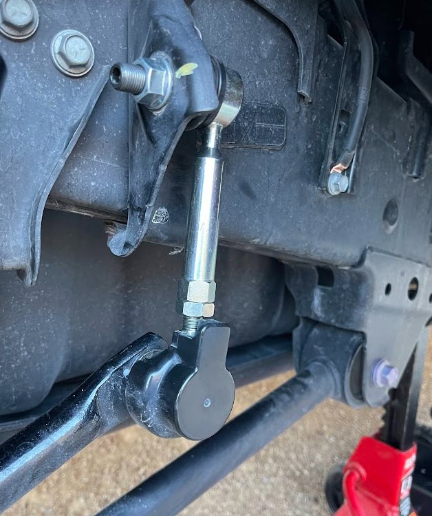

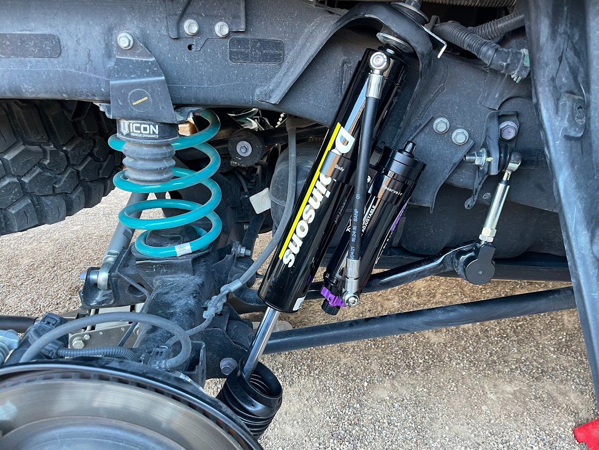

    Rear suspension swap #2 went in last week and then I took it on 25 miles of washboard trails on Sunday. Really a huge difference in the rear. It's got me fired up to swap out the front Icons to a tuned & adjustable setup vs the 2.5 Non-Adjustable Icons that I have up front right now.
    • New Springs: Dobinsons 220-440lb Springs (C59-837V) - Removed the OME 2866s
    • New Shocks: Dobinsons MRR 3-Way Adjustable Rear Shocks (MRA59-A687) - Removed the Dobinsons IMS Med/Heavy Shocks
    • New Sway Bar Links: Dobinsons Rear Adjustable Links (SE59-591)
    I'll have the Dobinsons IMS Shocks and OME 2866 springs for sale soon as take-offs, if anyone is interested.
