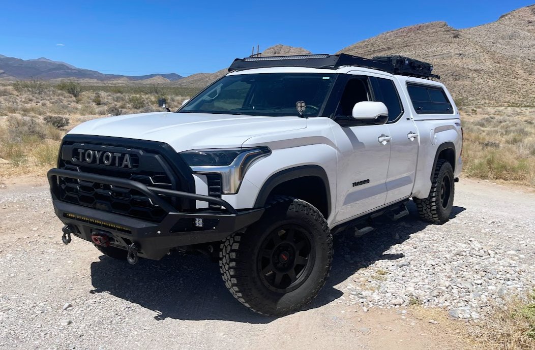

    No big update. Just an updated picture from spending New Years in Yosemite National Park. Rented a cabin in the park. Had a great time. Just wish Badger Pass had got snow so the wife and I could have done skiing & snowboarding. Boo. Only big change from previous is you can see that I finally mounted my old traction boards and you can see the Renogy solar panel mounted on the roof rack above the passenger side.
    Caption: Current Pic of the truck while running some trails west of Las Vegas in the Spring Mountains.
