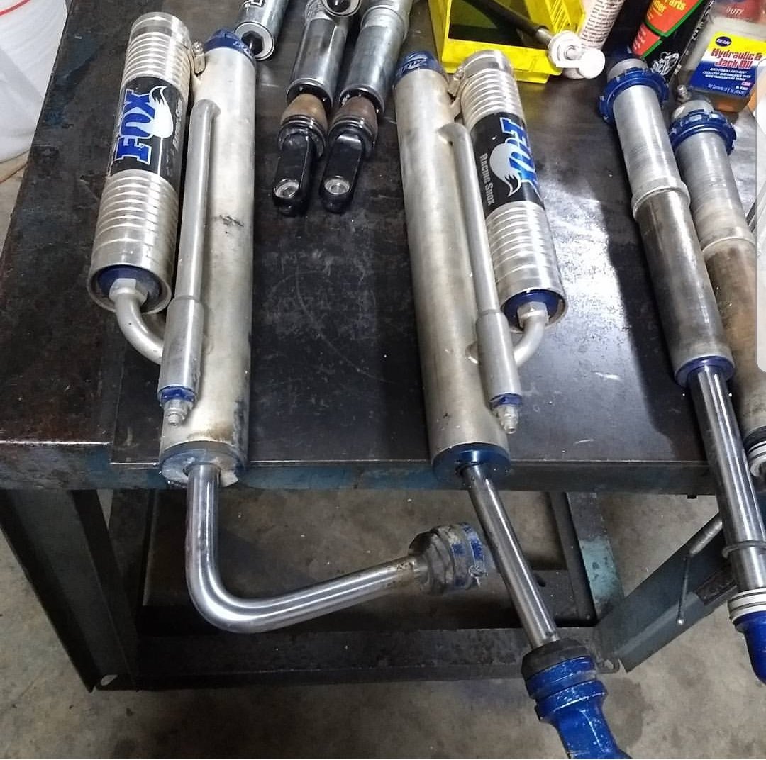

    This is the dumbest thing I have ever heard. On fox's, the shaft size is the same for 2.5 and 3.0, also I think 3.5 is the same but I would have to check. they are all the same strength. The extra diameter is for handling a higher heat load.
    I jump The Truck all the time and I have 2.5 all around.
    Now, you get more dampening per shim for the larger diameter shocks, thats true. But you can still dampen a 8k lbs truck with 2.5's, you just have to have the right stacks and use low flow pistons. Oh wait, nobody offers low flow pistons except fox...
    My front shocks never get hot, not even in 100 degree desert heat and running 3' whoops for hours. They don't even get above 150 degrees. I did finally manage to get my rear shocks hot after I redid the leafs because now I am using the full stroke. But they got no where near 400 degrees, more like 200 degrees. and in order to get them that hot I had to run a truck that weighs 8k lbs over 3' whoops for over an hour
    Ya'll can waste money on large diameter shocks and add unnecessary weight to your truck all you want. Somebody has to support off road businesses to keep the prices down for guys like me

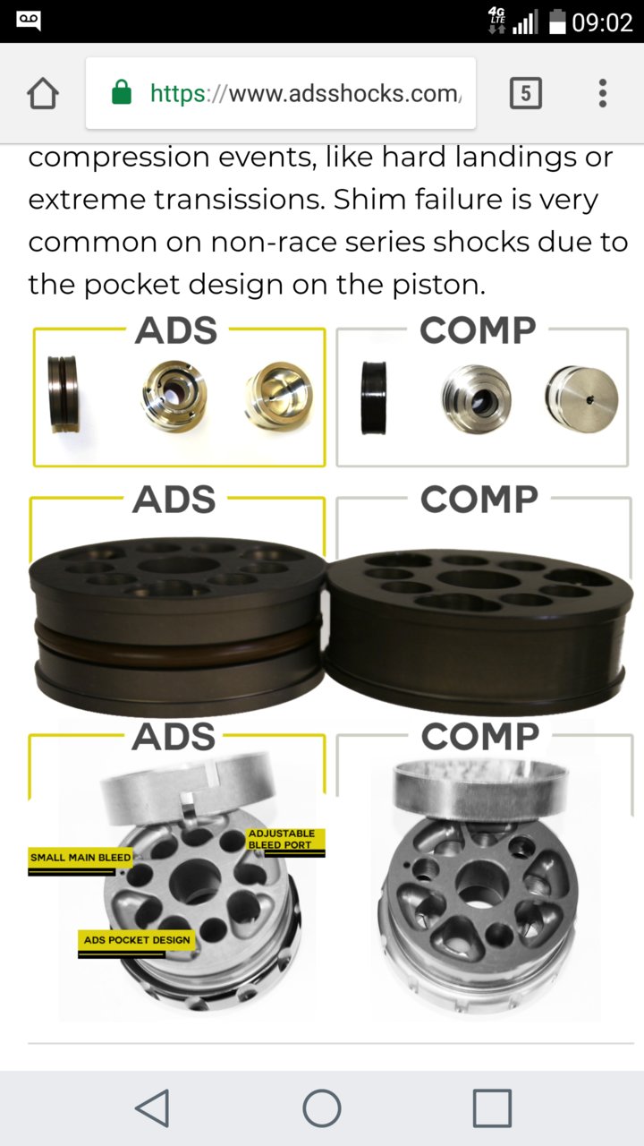

    @ADSracingshocks - F 3 point ohh / R 2.5 - w/clickers @camburgracing - uniball UCA @rigidindustries - 40" amber/white split, Dually XL, D2 @coopertires - 35/12.5/17 STT MAXX @bayareametalfab - low pro bed rack @toyotausa - 17" rock warrior @sdhqoffroad - rock sliders, a-pillar @hondogarage / @apple / @gaiagps / @dualgps- navigation @wheelersoffroadinc - superbumps
    Don't 100% quote me but I believe ADS has threaded bleed holes (probably can completely block them off as well I could only imagine) to tune as you please. plenty of other people know much more than I, just sharing what I see and read.

    idk exactly what point they are making here, but on my kings i was able to have bleed holes tuned, they all have that option. ADS isnt very different from Fox and King.

    Low flow pistons, stainless shafts, and when that shaft velocity gets a little over board....

    The bleed holes are in the pistons. Most brands have them, some are threaded for set screws to block off, others are open holes and need to be tapped to block them off. The bleed holes are more for a shock without bypasses. Having them open on a bypass just deteriorates the bump zone performance.

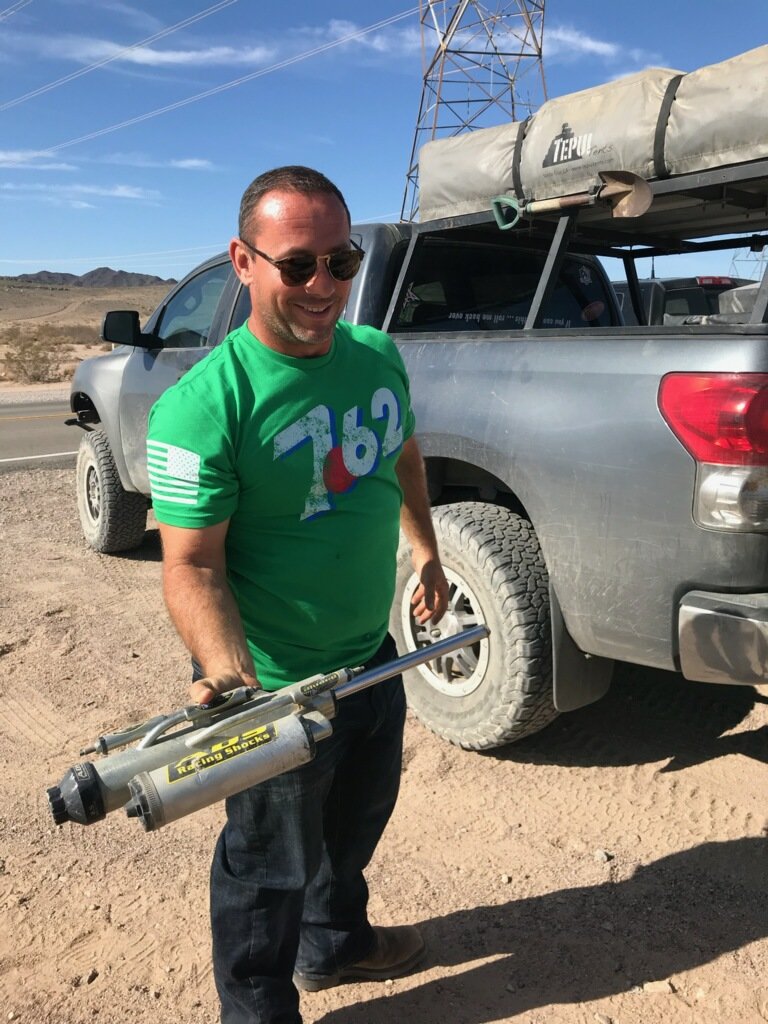

    Yeah and dragos had to wait like 6 months for the free replacement
    maybe so, but the point is catastrophic failure can happen for lots of reasons in lots of different situations. Ive seen Kings fail, ads, fox, Bilstein, toyotec, icons and the like for a variety of reasons.... arguing semantics serves no purpose. They are all good companies, they all make great stuff, applications and cost are what drives each of their markets.
    Side note @n2deep hows your ADS shock repair/replacement coming, been almost a year for the replacement right...

    Yeah in Anza when the battery got the strap.
