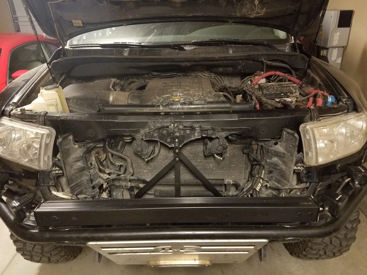

    The hood is fixed!!

    really like that front bumper.

    Mine? Thx !!

    yes ! it flows well with gen 2 Tundras body style

    Thx homie!! It was custom built to my truck. Had to modify the lower body crossmember and relocate the steering pump cooler in order to stuff the winch in tight to the radiator. Everything is welded to the frame and connected in multiple places. Frame horn is double walled and the lower frame crossmember is reinforced for big hits

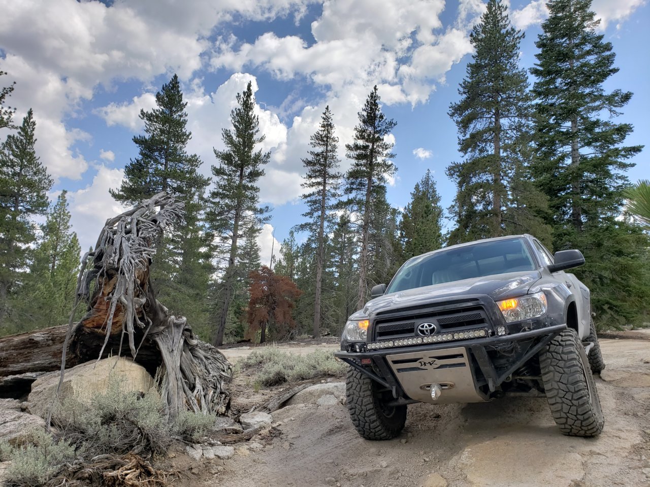

    Do you even read posts before you answer? Zak has a camburg shock relocation kit and he's getting 14" travel with his kings and deavers
    This is simply not true. Something wasn't done right and thats why those shafts bent. I'm running low flow pistons with modified #120 stack (top out deleted and minor change to the last shim) and I haven't had any problems
    there are plenty of videos of me jumping and running big whoops. I've bottomed out these shocks plenty of times on some really big oh shit hits.
    Stop spreading misinformation
    Are you ever going to start telling people that these shocks interfere and fall off of people's trucks because you didn't set them up properly?? I personally know several people that have had your ADS's fail.
