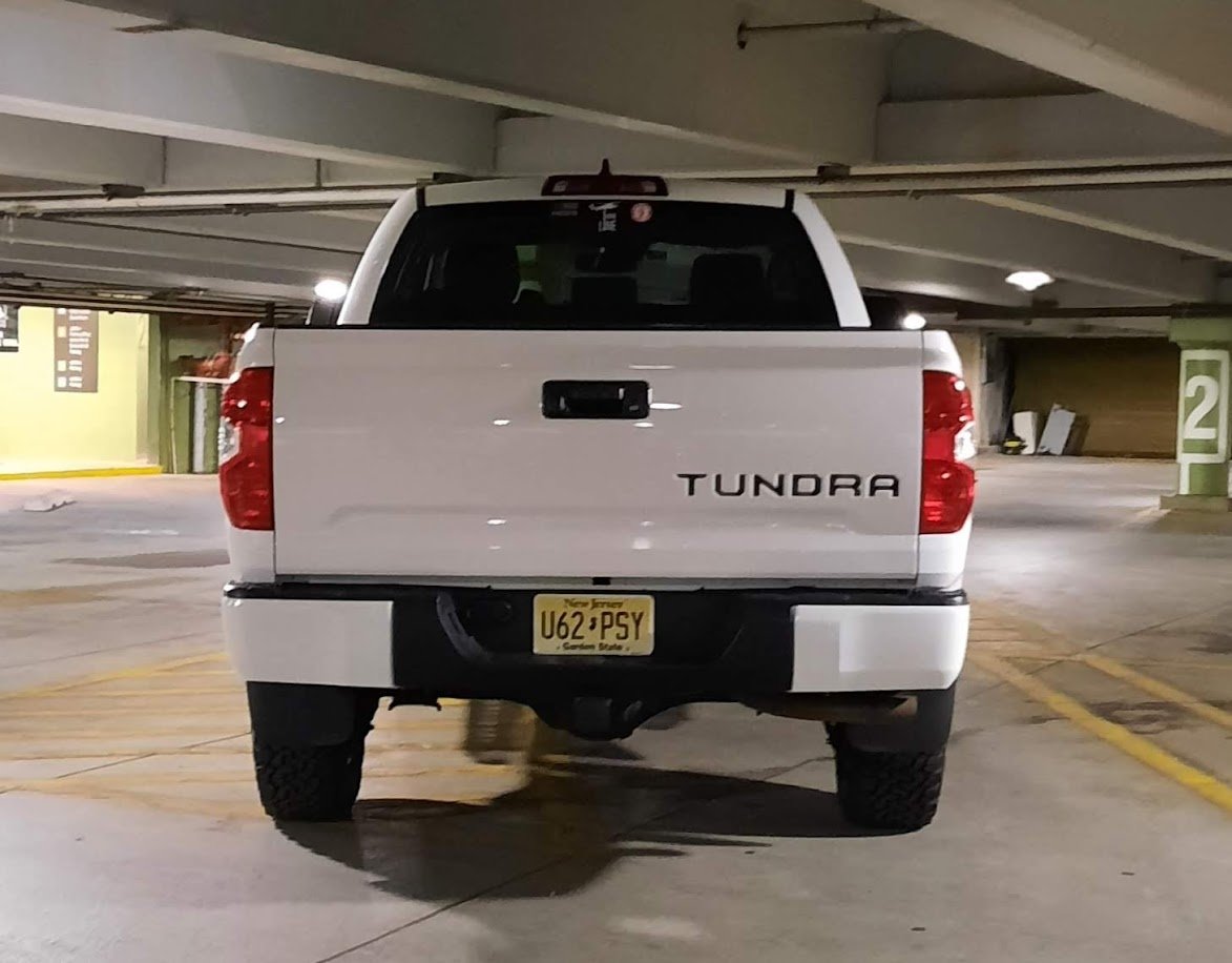

    Then took this picture today where it looks pretty level. Not sure but I believe I had a full tank in the first post and this one today is just under half. Does have BDS 3" suspension lift, Fox shocks...

    Could have been exacerbated by an uneven driveway or something. That pic in the parking lot is probably as level as you are going to get outside of a shop. It is definitely less noticeable in that pic. Did you have that lean while you had the stock suspension too?
    Its weird, I think I have the only Tundra that has a slight lean to the passenger side right now. I have stock front end with 5160 in the back and RAS, I could adjust the ras on the passenger side 1/8" up to level it but I am waiting to do the front coilovers this weekend to see if it has any effect on the back.

    I am thinking maybe something uneven at the end of the driveway from that initial picture. Going to check again at gas station right after I fill up next.
    Yours leans to passenger side? Hadn't heard that one yet.

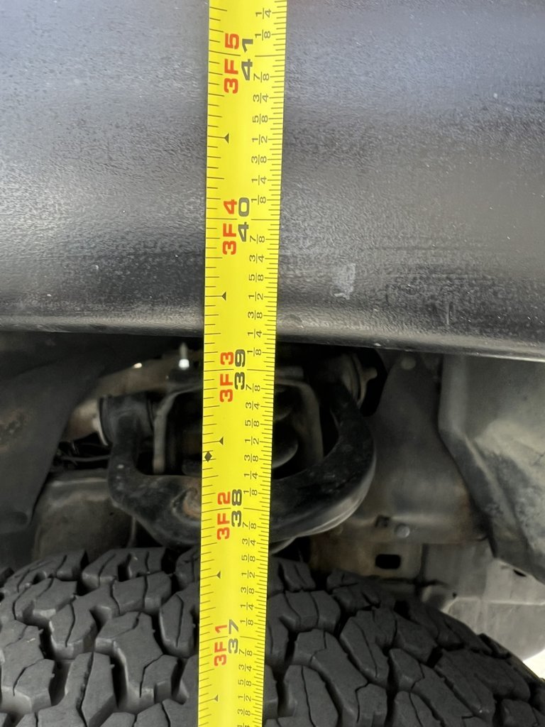

    Have a 2" front spacer lift and a 2" block. RAS system installed on white (lowest) setting.
    Current measurements:
    DF 39 3/4"
    DR 41 3/4"
    PF 40 1/8"
    PR 42 1/16"
    It's noticeable, I want to live with it, but my OCD will not allow me to. Thinking of adjusting the RAS on driver's side a little more aggressively and hoping it pulls it up.

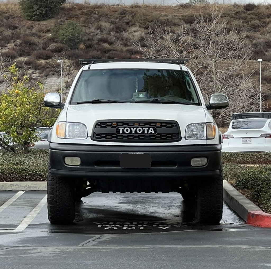

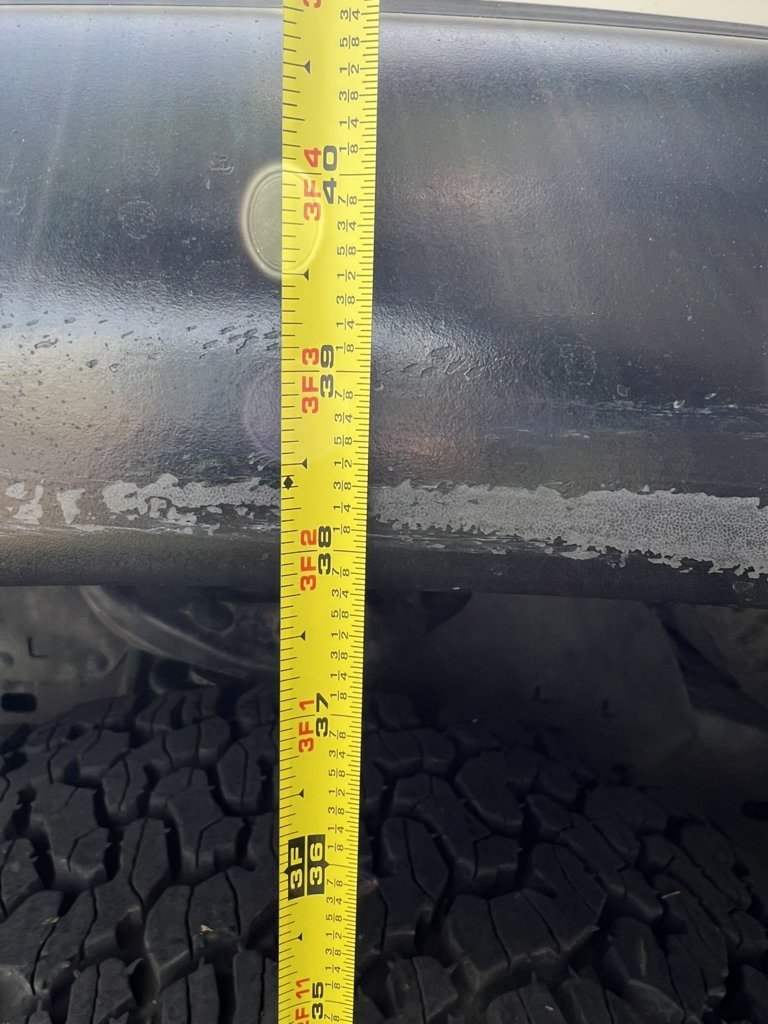

    How much drivers side lean is normal? I am about 1.5 inch lower on Drivers side. Passenger is 39.25 and Drivers is 37.75.
    PASSENGER SIDE
    DRIVERS SIDE

    Bassani cat-back
    I load my battery, fridge and toolbox on the passenger side & sit pretty level with 650lb 6112’s on the same bottom notch. No lift, but minimal preload.
    sorry, i read ‘driver’ as ‘deaver’ and thought you mightta mounted to tall leaf on the wrong side. I’ve taken apart 5 trucks, and swapping leaves side x side would definately move the taller leaves to the driver side. But i havent done mine yet.
