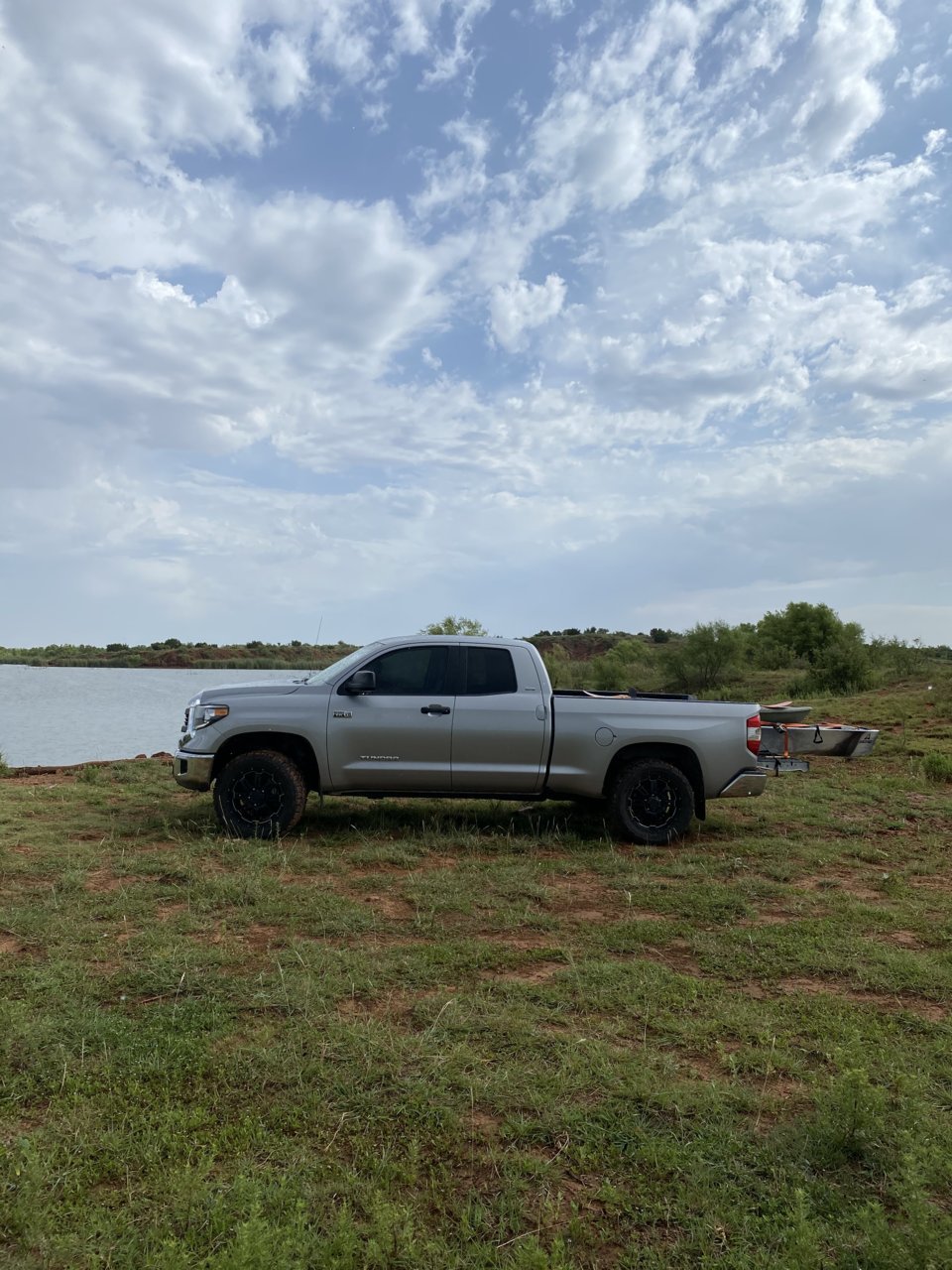

    Sorry for the late reply. I haven’t been on in a while! I had them for about 20k miles and really liked them. Only thing I wish was different is my tire and wheel setup. I just bought a 2019 crewmax and will definitely be going with 18’s. Not sure if I’m going to go with 6112/5160s or go all out on a set of kings/foxs.

    Looks good. I agree: 17s or 18s are the way to go. Such a nice ride with all that extra tire between the wheel and the road, and I like the way they look.
    I see you're a fellow kayak angler. Tight lines.

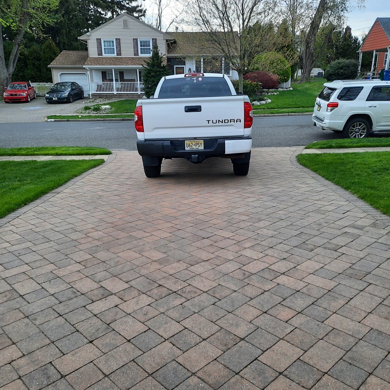

    I thought I was seeing things until reading this thread. Was playing around with wrap on rear bumper end and took this picture. I thought my eyes were playing tricks.

    Wow that is pretty noticeable, so much so I would bring to dealer. Maybe you have a bad leaf or something.
