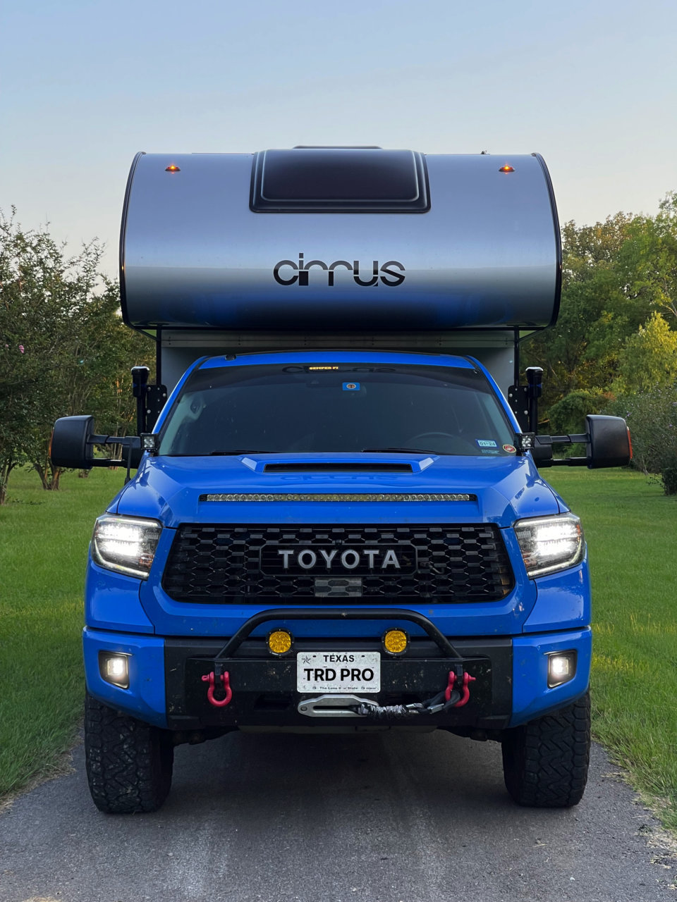

    You definitely are going to need a F350 or Ram 3500 for that camper

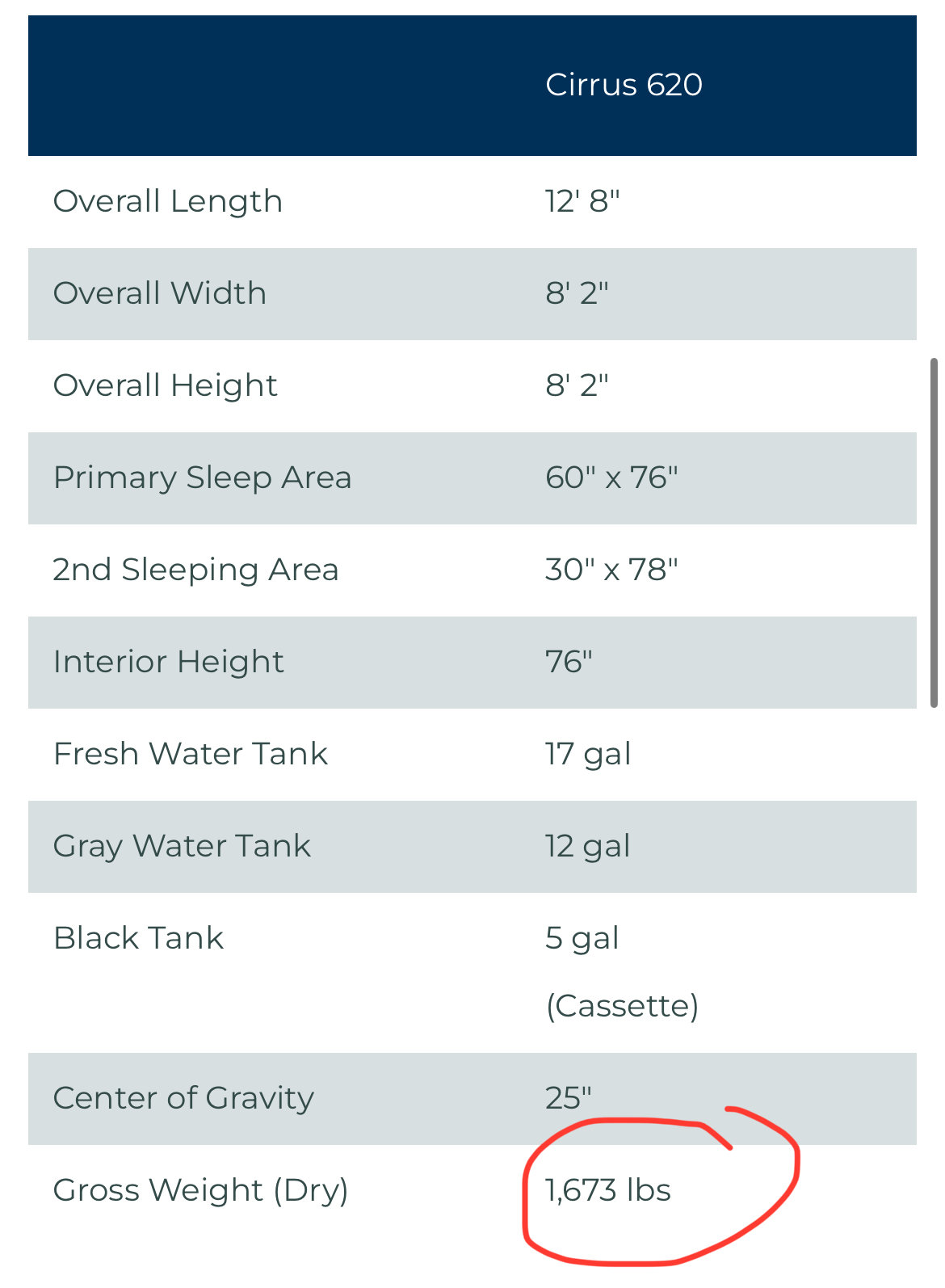

    FYI: After adding tow mirrors, adjustable air shocks, helper springs, and a rear sway bar, we purchased the Cirrus 620.

    No more drive through stops! Watch out for tree branches and such! I'd also get busy on a brake upgrade like yesterday.

    Personally, I wouldn't keep a 1500+ camper in my Tundra. Airbags, shocks, helpers, yada yada, don't change the axle ratings, or body and bed mount ratings, etc. The bed is thin spot welded sheet steel that's only attached to the frame in what, 4 spots on those little beds? There's a lot more that goes into payload rating a vehicle than how much the leaf springs sag when you add weight.
    However, I'm not as concerned about carrying the camper as I am about about the brakes. Especially if you need to stop quickly on the interstate while doing 60.
    At the very least, replace the stock brakes 2-3 times as often, if that thing will be in the bed all the time.

    Thanks for all the great advice guys! (Buys slide in camper that puts him 800# over payload anyway) :notsure:

    Way to go!!!....nice camper and rig!

    Great choice. You’ll be immediately over your payload numbers. Once you add any of the equipment needed to camp in it, people and gas, you’ll likely be over rear axle rating. This will put continuous strain on the suspension and braking components. Will it fail? Maybe not. Will the components wear out early? Probably so. Wheel bearings and suspension bits will likely be the first to go.
