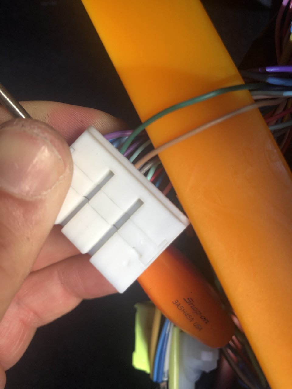

    Just went to do this and my 2015 kick panel wires look nothing like the pics. Where could I find the wire colors for 2015?

    CBA283C5-7B90-41A8-968E-2DB39AE3D54A.jpg E62B1AD7-5A05-4D78-B9F5-6BD46D460556.jpg 85D100BB-580A-4601-867E-0D8BF47F433B.jpg
    Done! Thanks for your help @Wynnded ! Instead of pulling the wires and re-pinning, I cut and crimped quick connectors. It’ll be easy to swap back if there’s ever a need. Headed to take the kids to Candytopia then gonna see what I can do about deleting the +/-

    Mine is different, I don't even know what yours looked like before. Where you able to just use a Sharpie?;)
