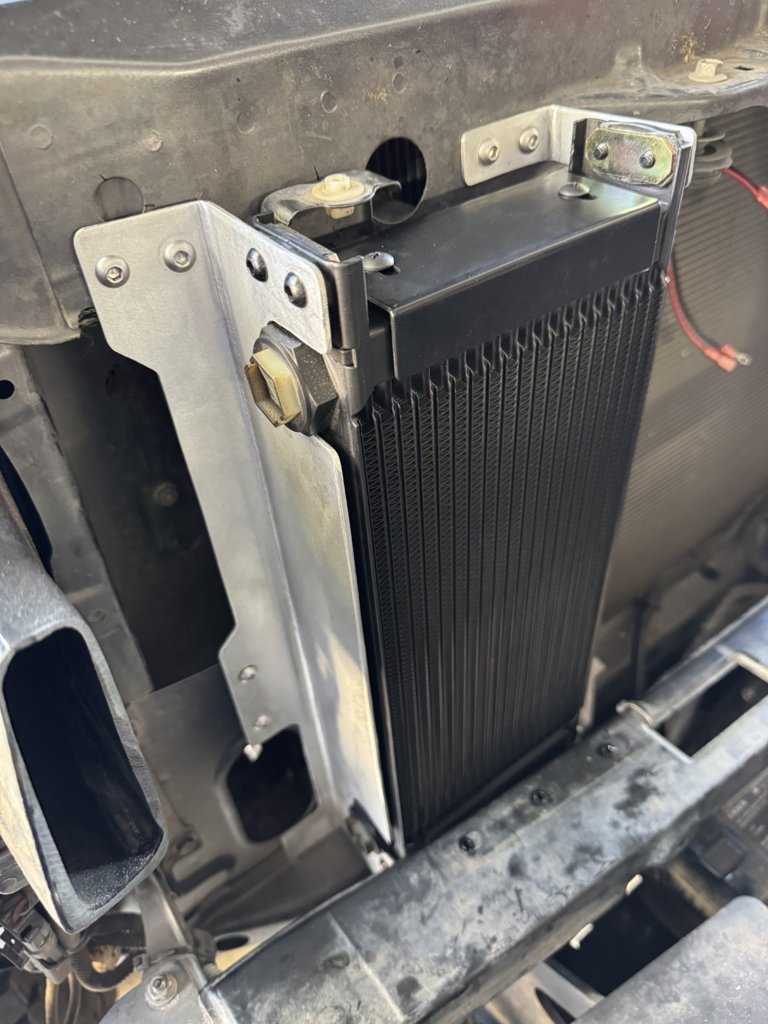

    Installed mine. Love it. More photos and videos on IG @ASV_Tundra

    absolute clean install!

    All the credit goes to my brother in law. Guy is the best fabricator I know. This mod kicks ass and totally worth doing.

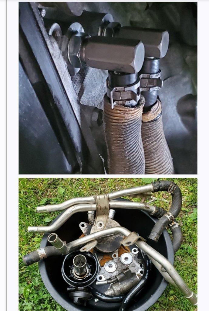

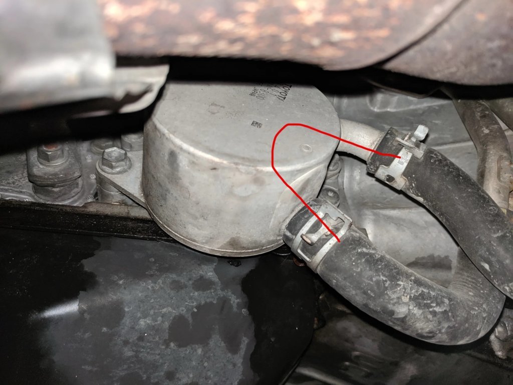

    Has anybody else bypassed their transmission “heater/cooler” puck? My plan is to add a cooler by using AN lines from the transmission where the puck is and looping the coolant lines together. Anyone see any issues with this?IMG_2793.jpg IMG_2792.jpg

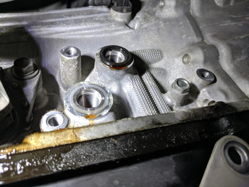

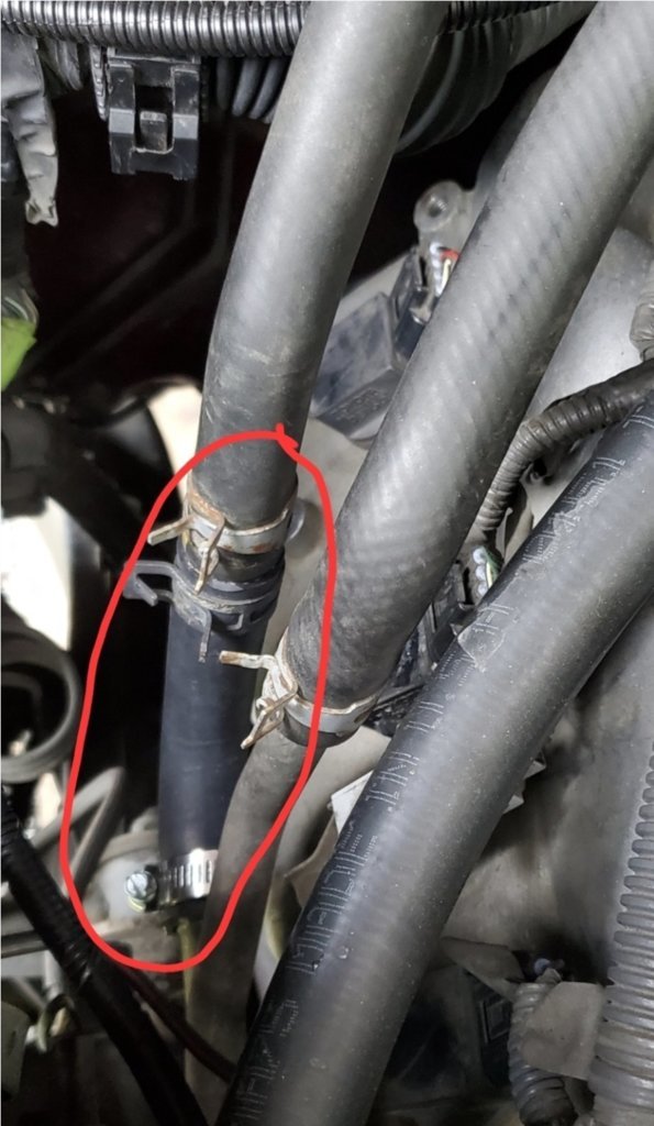

    Yes. I posted the fittings and removing the coolant hardlines on page 2. If you remove hardliners just join coolant hose off of firewall. I have since added a 145 degree thermostat.

    Oh geez I missed that bypass part, I saw the Toyota fittings for the transmission though! No ill effects from it so far?

    Depending on which part of Maine you're at will take a little longer to heat up in winter. I know it can get pretty cold. I had it without the puck in 20-30 degree winter. Took an extra 10-15 minutes to come up to 140. I added the Improved Racing fsm 145 degree thermostat. And it sits at 150-170 degrees.
