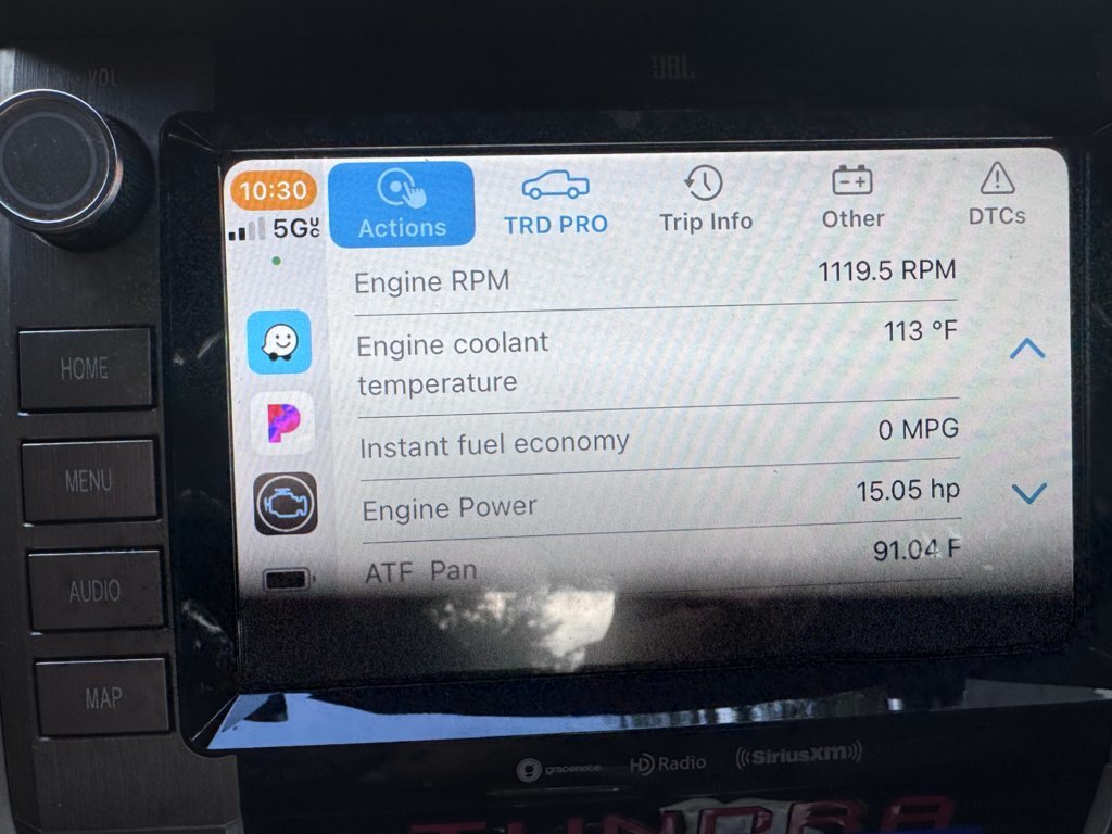

    Thanks for this write up. I'm doing a drain & fill this weekend to get me by for a while until I can assemble the parts. My truck is a 2021 with 32k miles on it so it's time for a drain & fill anyways. I plan on adding a trans cooler, before winter if I can squeeze it in but more likely after winter.
    I just moved to the North Carolina High Country near Beech Mountain. So, we now drive winding mountain roads every day where we're often running slow speeds.
    After a week or two of being up here, I started to notice a slight "burnt" smell when we'd get home occasionally. I'd most notice it between the cab & the bed. Checked everything underneath once it cooled off and couldn't find anything, so I figured it was a fluid getting hot.
    We often have to use 4H to get up to our house. From the entrance to our neighborhood, it's 1.7 mile drive up a gravel road but it's nearly a 2000' elevation change. Though the road is well maintained by our POA, there are several tight switchbacks, and I use 4H often on those. Especially after a rain. I imagine I'll be using 4H all the time in winter.
    Started monitoring my trans temps via the OBD Fusion app with the Veepeak BLE OBDII adapter. Sure enough...trans temps were running upwards of 235-240. Hottest I saw coming up the mountain was 252 on trans temp sensor #2, which I assume is the return line. That hotter temp was in 4H, but no towing. Ambient temps in the low 70's. I'm planning on buying a small UTV/side-by-side in the future. I dread the thought of what the trans temps will look like towing a (small, but loaded) trailer up to the house. :eek2:
    Drain and fill now. DIY trans cooler coming soon.

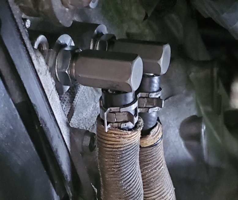

    You'll have to convert to AN fittings vs barbed hose.
    I was going to suggest that you could use hose that has a nylon shield. To get a decent clamp you would have to peel back the stainless hose to clamp the hose to ensure is doesn't leak. I would opt for fuel injector clamps over regular hose clamps.

    thanks for the reply on the hose, I may just peelback the braiding to keep the barbs. Gathering all the parts and will do a transmission fluid change while I'm at it. I too have the vepeek OBD scanner and I keep mine plugged in all the time, it comes over on my car play so I can view all the time.IMG_6307.jpg

    I like it. It's a useful setup (when coupled with the OBD Fusion App) and the price is nice. I usually leave it plugged in and will monitor data about every other drive. It's nice that it integrates with Apple CarPlay (mentioned above), but I usually have Maps up instead. I've got my phone mounted high using one of TackForm Vent Mounts. Since it's within eyesight, I usually monitor the data using my cell phone and I have custom dashboard setup in OBD Fusion so I can monitor a bunch of data in a single view.
    That being said, I'm thinking of going the ScanGauge route eventually. Probably the SG2 mounted on the steering column like a lot of folks. Not in a huge hurry though.
    On a side note: I did the drain & fill weekend before last. When I did, I decided to leave my catalytic converter shield off the truck for a while. I've noticed my temps have dropped a good 10-15 degrees at city & highway speeds. Upwards of 20 degrees cooler when I'm crawling up the mountain in 4WD. It was definitely sealing in the heat with the 4 cats on either side of the trans and really roasting it. Deciding between leaving it off permanently or taking a plasma cutter and cutting in a bunch of new ventilation holes in it.

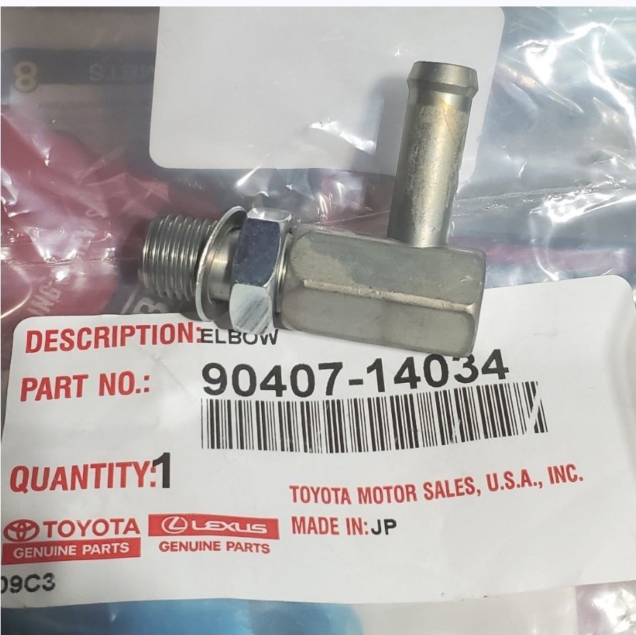

    Sooo...basically you screw in the 90° elbows and run lines to a transmission cooler? If it's that simple, I'm doing this ASAP.

    You need 2 o-rings 90301-11030 that go with the elbows. You can throw on an inline thermostat later on if it's too cool. Innovate racing, derale, earls and mishimoto have decent thermostats.
    Or like @snivilous did his cooler. Sorry for the hijack...:rolleyes:

    I ran the hard lines and bolted them up in about 5 minutes. The most difficult part from what I remember was making sure I didn't touch the catalytic converter as they get hot even from just moving the truck into the garage.

    My 2020 was no fun either. Once I finally got the lines in place the back bolt was easy but that front mounting bolt was just buried. Many cuss words were uttered, but if I had to do it all over again I would still use the hard lines.
