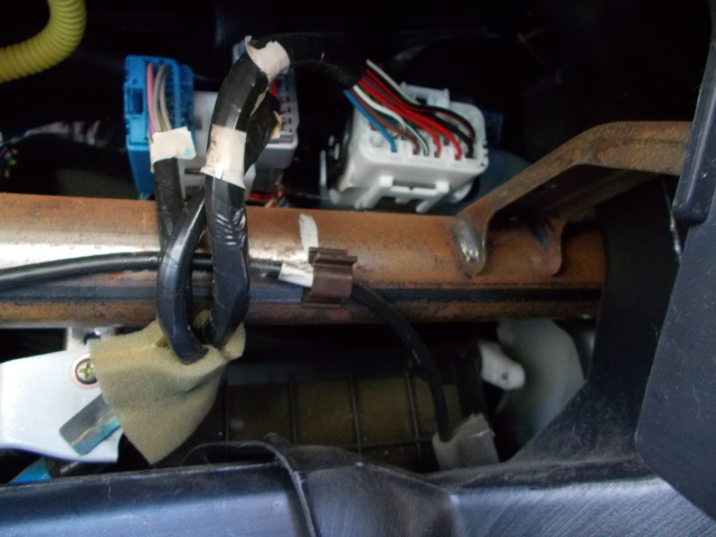

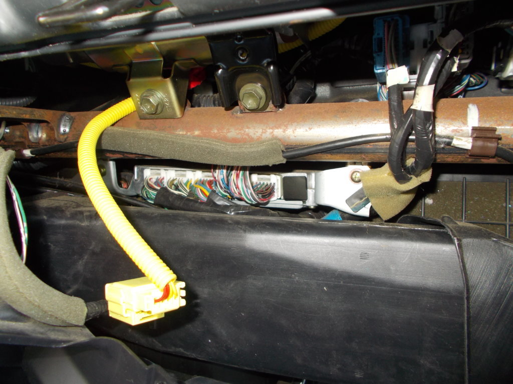

    I think you will appreciate my resolution / modification of the TPMS warning light problem:
    PICs tell it. Here's the description:
    1) Buy an ON/OFF (locking type - not momentary) push button switch with lighted ring;
    1)a) For this PIELE switch (black shell w/ yellow light ring) drill a 1/2" (12mm) hole in the top of the upper glove box (at the 'third rib from the right' - so it fits right of the pass air bag and left of the harness);
    2) Despite the wiring instructions included:
    2)a) The blue wires are ON/OFF via the switch - at the TPMS computer: one goes to #6 (yellow 5V) and the other to #5 (light green) -- no need to cut either wire, just strip the shielding;
    2)b) The Red/Black wires are the light, which I tapped into the lower glovebox light circuit;
    Now, you can defeat the TPMS light at will with the switch and the dash colored light illuminates with the parking lights!
    PIC 1 = where I tapped into TPMS wires
    PIC 2 = looking up at the glove light harness - the orange #20ga wires going left are for another switch I will install near the RSCA button
    The original owner installed an ugly giant toggle that manually turns on the reverse lights no matter anything - a good idea when trying to hook up a trailer at night, though poorly executed
    PIC 3 = the end result in upper glove box
    Could be better: Add a 4-pin plug so you can remove the upper glove in the future; my wires are soldered for the present.
