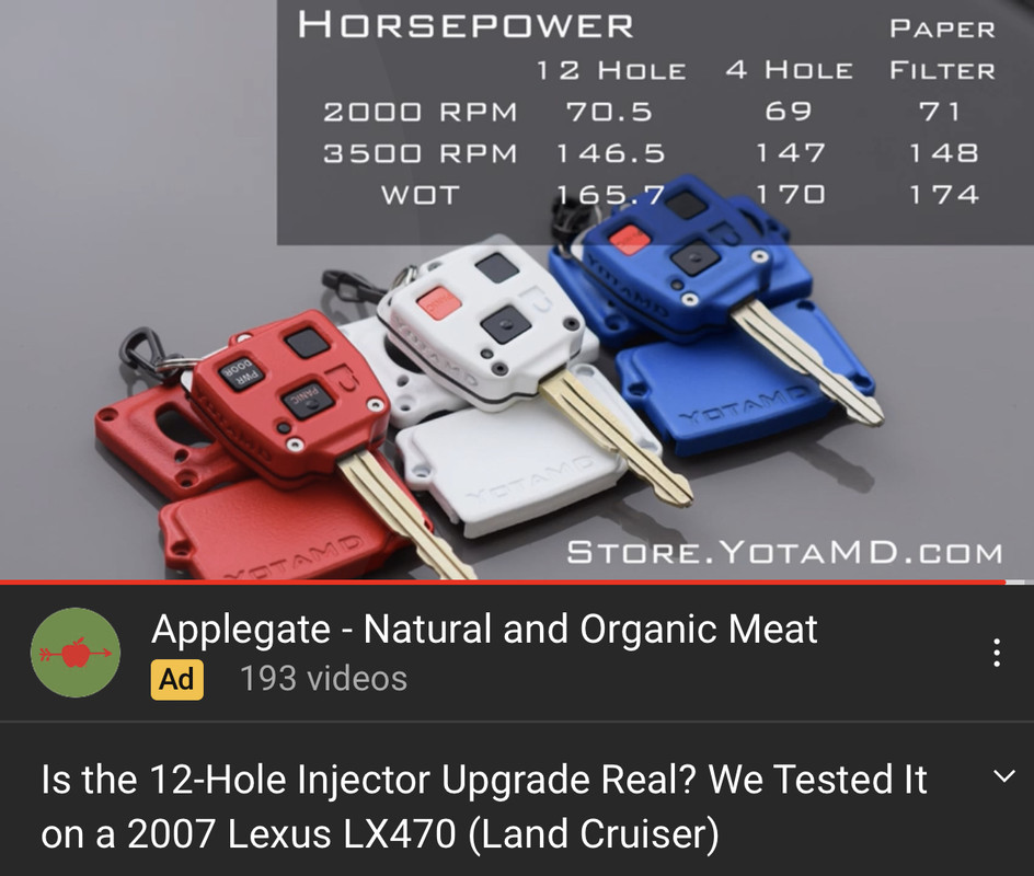

    Are these higher flow than stock or just better atomization?
  13. Aug 18, 2021 at 1:30 PM
    #43
    FirstGenVol
    FirstGenVol Brake Czar
    Dec 13, 2018
    #22934
    13,088
    East TN
    2002 AC
    Supposedly better atomization but when a dyno test was done the standard 4 hole injectors actually performed better. Several of us are skeptical you'll see any improvement with more holes.
    I believe this was the video.
    https://www.youtube.com/watch?v=D1zq1Dl_IhM
