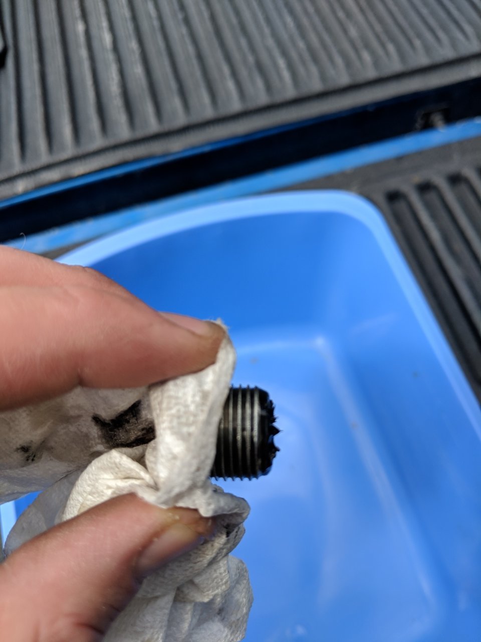

    Changed front and rear diffs and Tcase today. I bought magnetic drain plugs from goldplugs.com - I've lined out those model #s below. The OEM drain plugs have magnets, but they are not very strong. The ones from Gold Plugs are much stronger, but see the end comments for more info on that. And, just have to throw this in - always crack the fill plug first before cracking the drain plug :)
    Also, I used Amsoil 75W-90 for the diffs, and Ravenol 75W for the Tcase. Used "
    Differential and Transmission Drain Plug Crush Washers Gaskets for Toyota 4runner Tacoma Tundra FJ cruiser Land Cruiser, Replacement for the part# 12157-10010 90430-24003 90430-18008
    " for washers, Amazon.
    Here's a breakdown of findings for my particular truck:
    REAR DIFF:
    Gold Plugs # AP-05
    Small amount of build-up. No shards.
    Fairly dark oil:
    FRONT DIFF:
    Gold Plugs # AP-24
    Small amount of build-up. No shards. Oil looks same as Rear.
    TCASE:
    The GoldPlugs site states model # AP-05 for this drain plug. However, this does NOT fit. See below for the plugs I had for fill and drain. I was able to take these out, and put back in, by just using the square head of a 3/8" socket driver. These bolts were not very tight, and were not leaking at all.
    Fairly dark oil:
    Since I wasn't able to use the drain from GoldPlugs, I still wanted a magnetic end. So, I went to True Value and bought this, https://www.truevalue.com/3-piece-neodymium-super-magnets:
    It fit perfectly on the end of the drain plug (I didn't take a pic of the final product, but it works):
    I cleaned the plug and magnet, scuffed them up a bit with sandpaper, and superglued the magnet to the drain plug. And, this may actually be a cheaper way to achieve magnetic drain plugs rather than buying the ones from GoldPlugs - those are about $20/piece. Knowing what I know now, that's what I would have done instead. Live and learn.
    There's my experience performing these tasks on my truck. It may be slightly different for yours, but hopefully some good info. For video tutorials, I highly suggest the Youtube channel "Toyota Maintenance". This guy has some good stuff.

    Good job. I did transfer case & both diffs this past weekend too. Found a decent size chunk of metal from rear diff’s plug. Think there’s any need for concern on that? Pic below.
    I have to say, I’m not sure I’d trust super glue to keep that magnet in place, esp for something as important & expensive as a transfer case.

    Great idea! These magnets will probably work well stuck on the outside of the plug as well. The magnet will magnetize the plug and the shavings will attach to the factory plug tip on the inside.
    apbreaux[QUOTED][OP] likes this.

    Yeah, that's a big piece. However, I'm not sure what you'd do besides taking the housing apart and doing a visual inspection. The only other recommendation I have is to maybe change the gear oil again in 5k miles or so and see what's there. If more, I'd say take'er apart. If no, probably good.
    I appreciate the warning re: the magnets. I will tell you that these magnets are extremely strong. Like crazy strong. I can't see any circumstance where the magnet would come off. The superglue was more of a CYA than anything.

    That's not a bad idea. Those neodymium mags are strong enough that that would work.

    The stronger the magnets the harder they are to insert in the front and rear diffs. Funny, still trying to figure out a fix for that. Need to make a plastic insertion tool.
