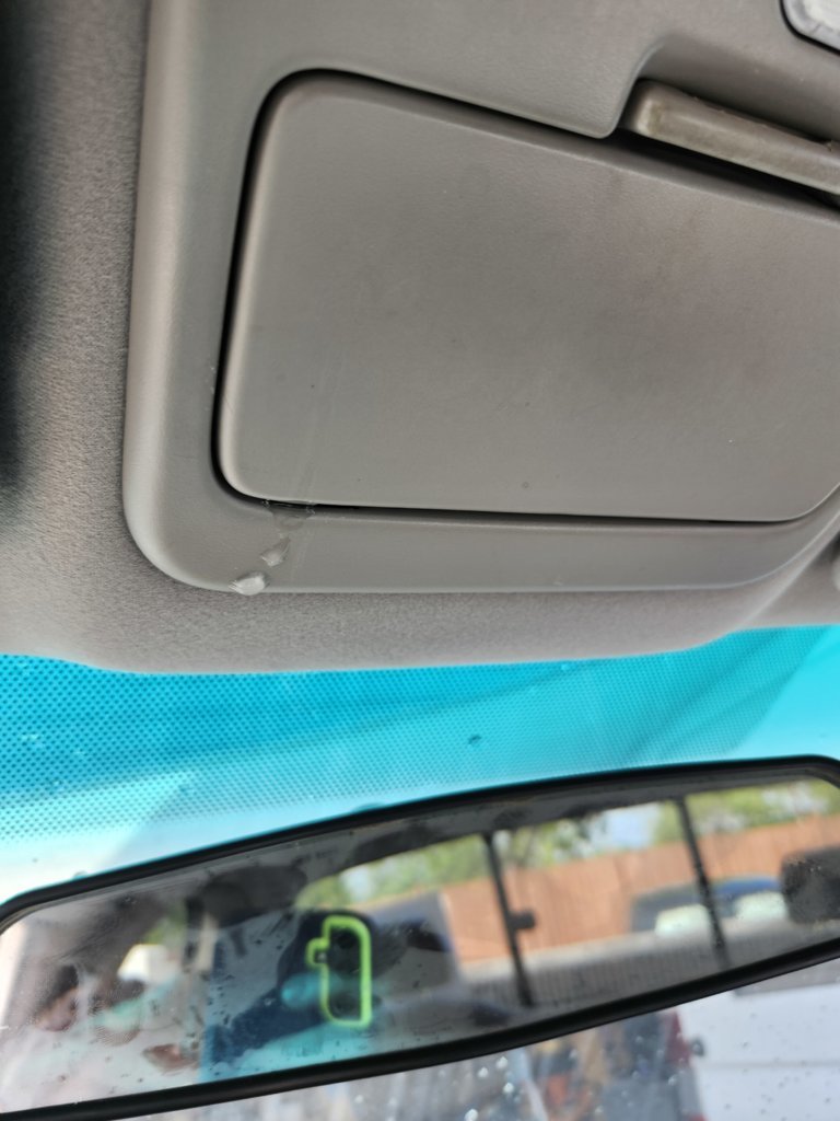

    Hi guys, newish member here. I've been doing other repairs but noticed that the driver side floor was wet after a rainstorm. I dried it up and was going to address it later but we had another storm last night. I went out to see if I could see any interior leaks and saw it was dripping down from the little sunglasses compartment! I've read the entire thread but not the video yet. Any idea where the water would be getting to this area from???:confused::fingerscrossed:

    Black 00 SR5 AC 5VZ PreRunner
    Imma keep it stock
    I think that is identical to @Jack McCarthy 's leak https://www.tundras.com/threads/wha...-gen-tundra-today.2558/page-2368#post-3934828

    #134257
    95
    2002 4.7L AC 4x4

  27. May 28, 2025 at 1:35 PM
    #87
    shifty`
    shifty` [OP] Earth acid cleanses me, cleanses me clean
    Jun 20, 2020
    #48239
    31,528
    ATL
    '06 AC Limited V8/4WD
    Didn't watch the video eh?

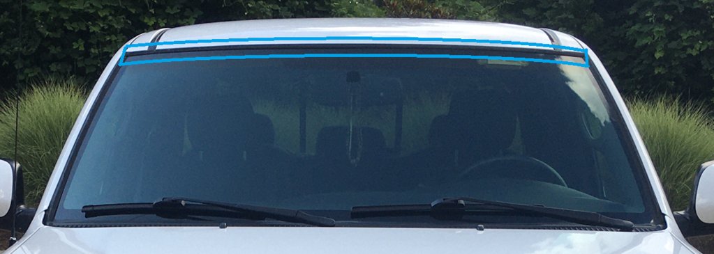

    6m28 secs, he covers leaks thru the sunglass holder. If you get clear packing tape and lay it over the top of the windshield, so at least an inch is on the paint and at least an inch is on the windshield. And at 10m10 he covers the 3rd brake light.
    It's going to be one of those two things, chances are. If you park nose-up, it's probably the windshield. If you park nose-down, it could be either. He also shows you how to remove most all of the trims associated with each leak/spot, like the side window covers, the top windshield seam cover, etc.
    Waterhose test, while parked exactly where you were when the leak happened, starting by letting the hose run water onto the 3rd brake light for 2-3 minutes and seeing if it drips at the sunglass holder within 5 minutes after you stop may reveal it. Otherwise, wait a full day, put the hose top-center of the windshield frame for 2-3 minutes and see if it drips.
    But like I said before, one way to isolate things also is to use packing tape. TAKING CARE TO NOT USE a highly aggressive tape like duct tape - I prefer the goldish-clear thin packing tape that comes off boxes way too easy - and when you remove the tape, don't rip your paint off with it, go slowly, and maybe use a blow dryer to heat it up.
    Places to put the tape - see the blue boxes below - you want to fully cover the seams of the spot you want to rule out as the leak source. Like so. If the tape totally covers the area, to the point water cannot get into that joint anymore, and the leaking suddenly stops totally, that seam is your leak source.
    But seriously. Go watch that f'n video. But rewind it to the start, since I have it auto-jumping to the cowl fasteners.
