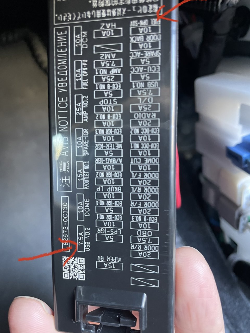

    Thanks for responding, I just received a message from Dongar saying their wire doesn't come with hot wire (for constant power) it works with vehicle on only

    I am not sure how others found constant power using Dongar connector, here is what they told me:
    Hi, Unfortunately, our adapters only support ignition On and will not supply power while in parking mode.
    Hi ,
    Thanks for sending that information.
    There are two products that will work with your 2022+ Tundra.
    1) Mirror adapter: https://dongar.tech/products/10pin-type-b-lexus-toyota. This connector port is located under the shroud at the base of your mirror. You can see a similar installation in this Toyota Sienna installation video: https://www.youtube.com/watch?v=8FmcnFMC0ok. This product is ignition-switched only and powers on only when the vehicle is started.
    2) Roof "option connector"...lead time is 3-5 days to ship. This uses the 5-pin connector above the domelight console which is also what the Toyota OEM dash cam option uses: https://dongar.tech/products/optionconnectortoyota. This product is ignition-switched only and powers on only when the vehicle is started. Here is how to access this connector:

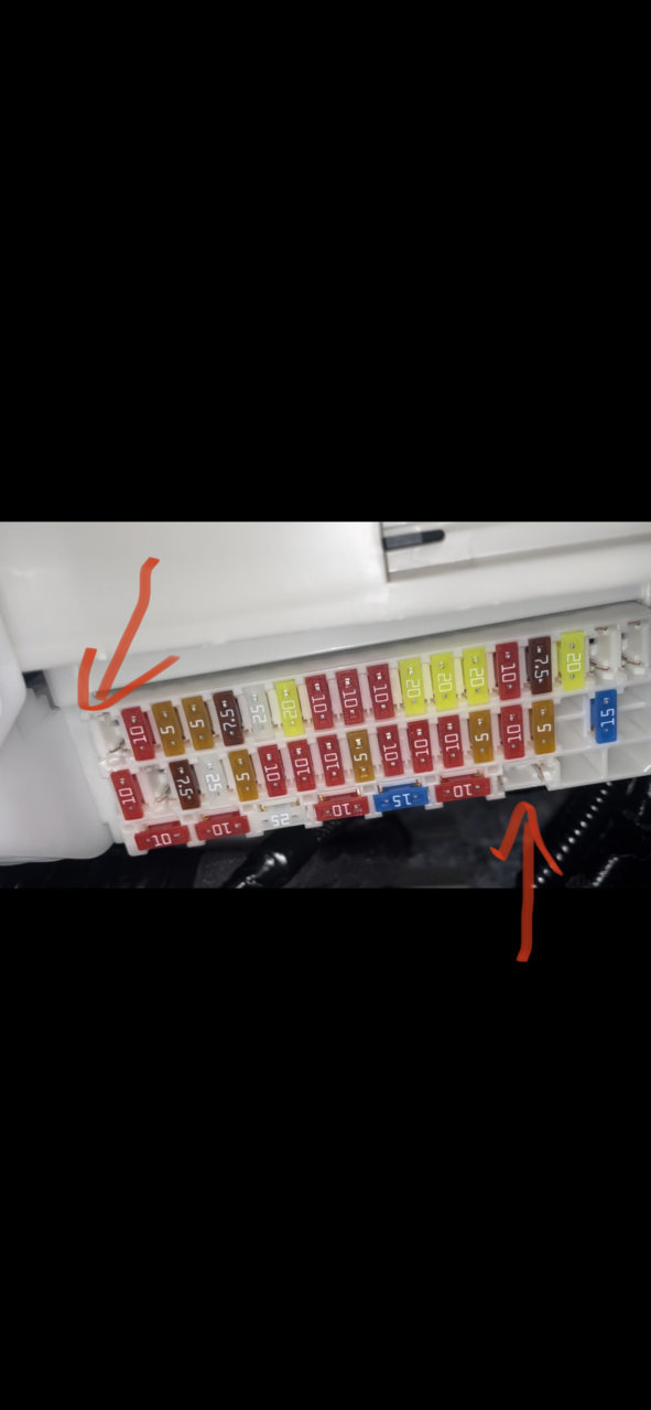

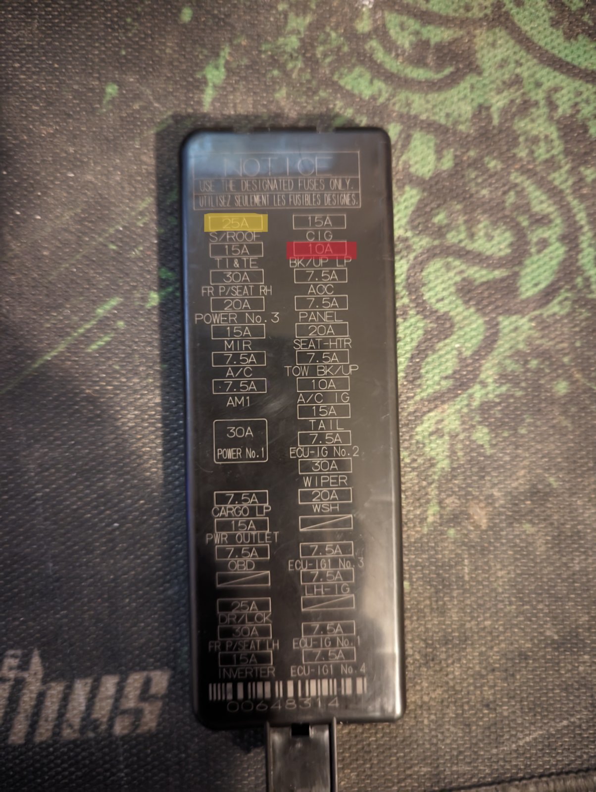

    Jumping onto this thread to try and figure out fuse tap locations for a 2015 Tundra 1794 edition, I tried BK/UP LP for constant and S/Roof for ACC but scared the shit out of myself draining the battery, clearly that's not the way to go! I tried testing a bunch of fuses with ACC on but couldn't get anything to light up.
    Is anyone using fuse taps on a 2015 Tundra with the following fuse maps?

    You might be able to tap the Seat Heater fuse, since that circuit is only enabled when the car electronics are powered on.

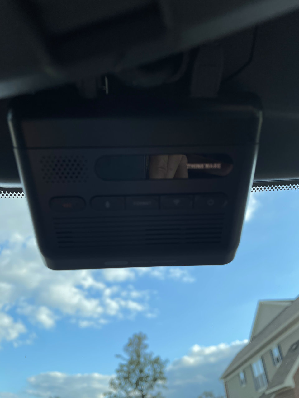

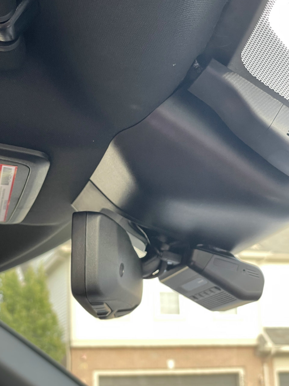

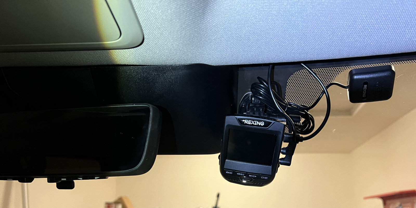

    I ordered one of these a few days ago, got it yesterday and installed today. Aside from getting the console off (took a good pull down), it was a quick and easy install and works like a charm... and this is on a 2024 Tundra SR5. Pics are of rear facing camera and main camera - with all cables carefully tucked into headliner.
    mrfreeman likes this.

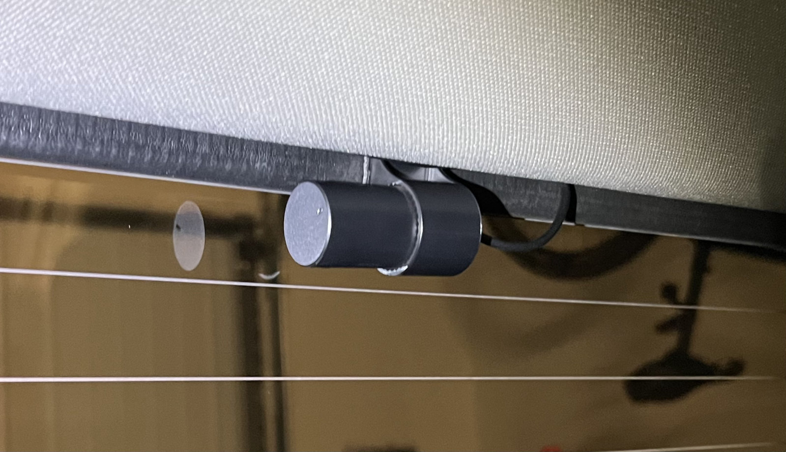

    What kind of rear camera bracket are you using?

    The camera I have is the Rexing V1P 4K - it has a rear camera option... and that is the camera shown. The rear camera doesnt have any markings on it to say who makes it... but I am pretty sure the rear camera can be ordered by itself from Rexing. Unsure if the 3.5 earphone style jack (that plugs in to main camera) will work on other cameras, so keep that in mind.
    And re-reading this today, I see I failed at reading the words. oops.
    For the rear camera "bracket", I used a piece of double-sided tape and stuck it to the window trim - read window still goes up/down without affecting the camera.
