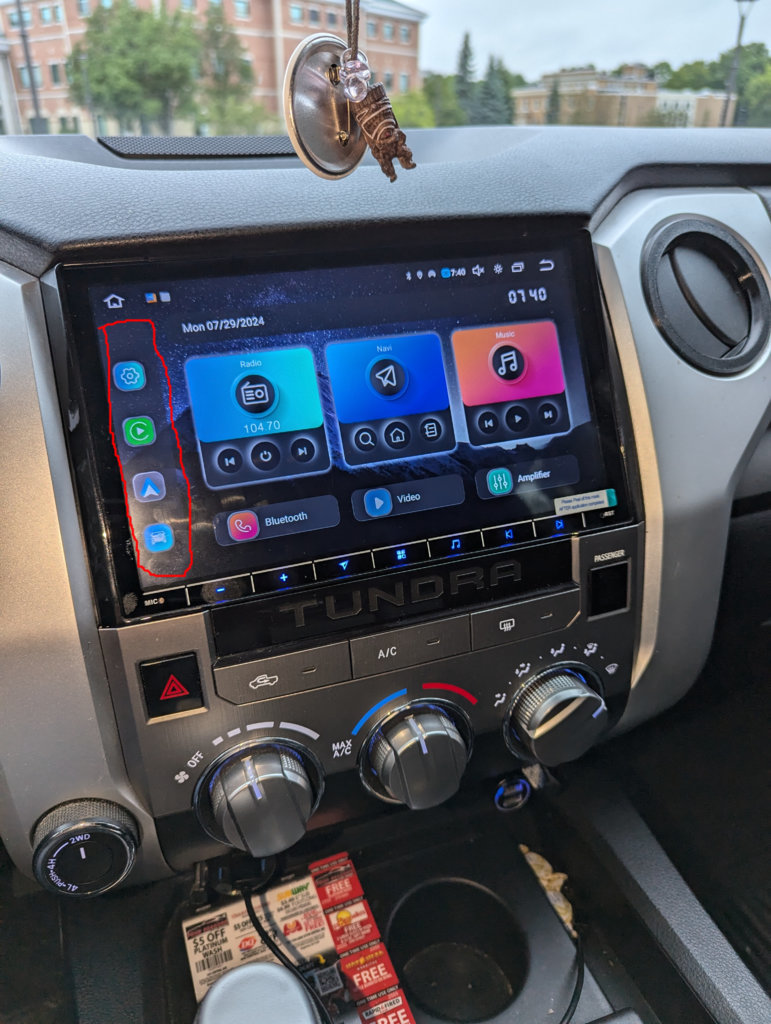

    Yes - the previous setup had the switch mounted in the dash under the stock radio. When i installed the G13, i removed the supplied harness and connected th RCA directly to th G13.
    There is an icon on the screen, you may have to swipe left to see it. You can modify the left hand ribbon where the android auto and the GPS compass icons are and add the front camera icon
    there for fast selection. I Think if you tap & hold in that area, it lets you modify the contents.
