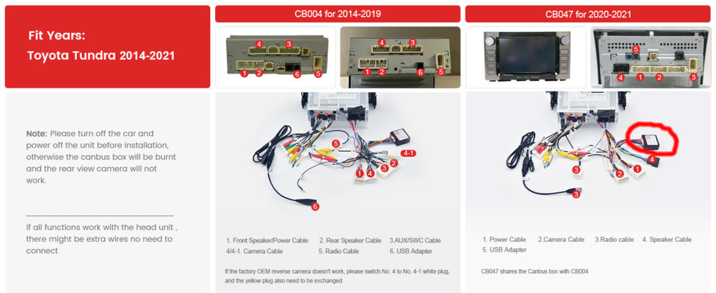

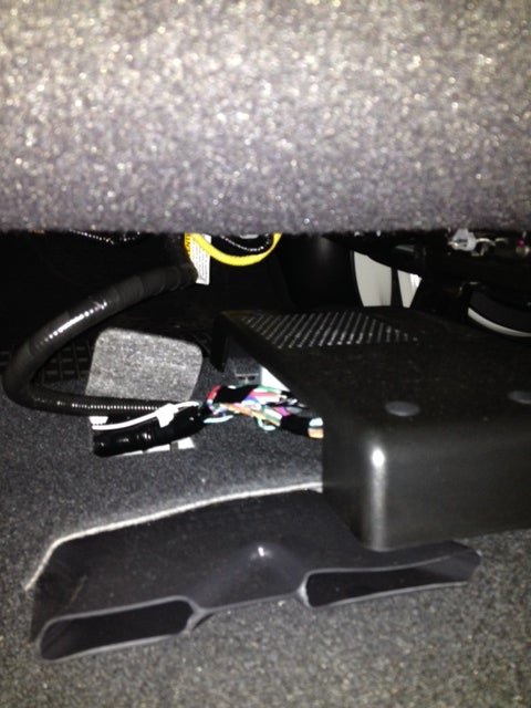

    The canbus is needed to utilize the steering wheel controls and it will plug into the small connector on the provided harness.
    You will/should get tow bags clearly labeled with the harness id. Make sure to use the correct harness. The canbus box is use
    by both harness's, so you will only get a singel canbus box. See the attached pic.
    Look under your front passenger seat, you should see a black plastic box/cover - that is the amplifier.
    The mic seems to be a mix of good and bad reviews. My wife can here me good if im parked, but once i start driving, the sound is lower, i think due to
    external road sounds. but there is supposed to be a fix the require additinal hardware. I will try and find that info.
    Found it ! - LOL
