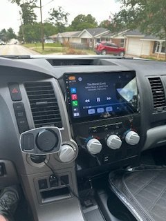

    Just installed my G12 in my 2011 tundra Sr5. Pretty straight forward and its a massive upgrade.
    Here's where im struggling. Should i use my factory camera that in the tailgate? Its going to the mirror currently.
    Heres my thoughts, I heard that the resolution is cropped and made to fit the mirror and if you send the signal to the head unit it could get grainy on the picture.
    Its also presenting some challenges if i am to go that route.
    Option1 (using Factory camera)I'd have to bounce the voltage down in the mirror and identify the correct wires and i dont have a video source tester. I followed a great video where this was done using a voltage meter and the product they used to change to 9volts i did purchase but not sure how to run/connect it. Then i would have to tap in and use a RCA video style and go into the a pillar to the back of the head unit.
    https://youtu.be/iIZZAtEcBqk?si=pCQehXn2M2TocDDT
    Option 2( buying after market camera) buying an aftermarker camera would insure an easy wiring straight from the back and to the head unit. Ive identified where i can tap into the reverse wire so thats good, but id still have to tap into the mirror because after removing factory camera its going to send blank data to that screen in the mirror and i dont want an error or blue/ black screen.
    Any thoughts on the wiring?
    This is what i bought: Red Wolf Step down.
    https://www.amazon.com/dp/B0945X9JHK?ref=ppx_yo2ov_dt_b_product_detailsdasaita.jpg
