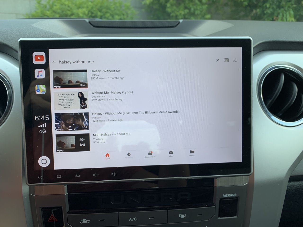

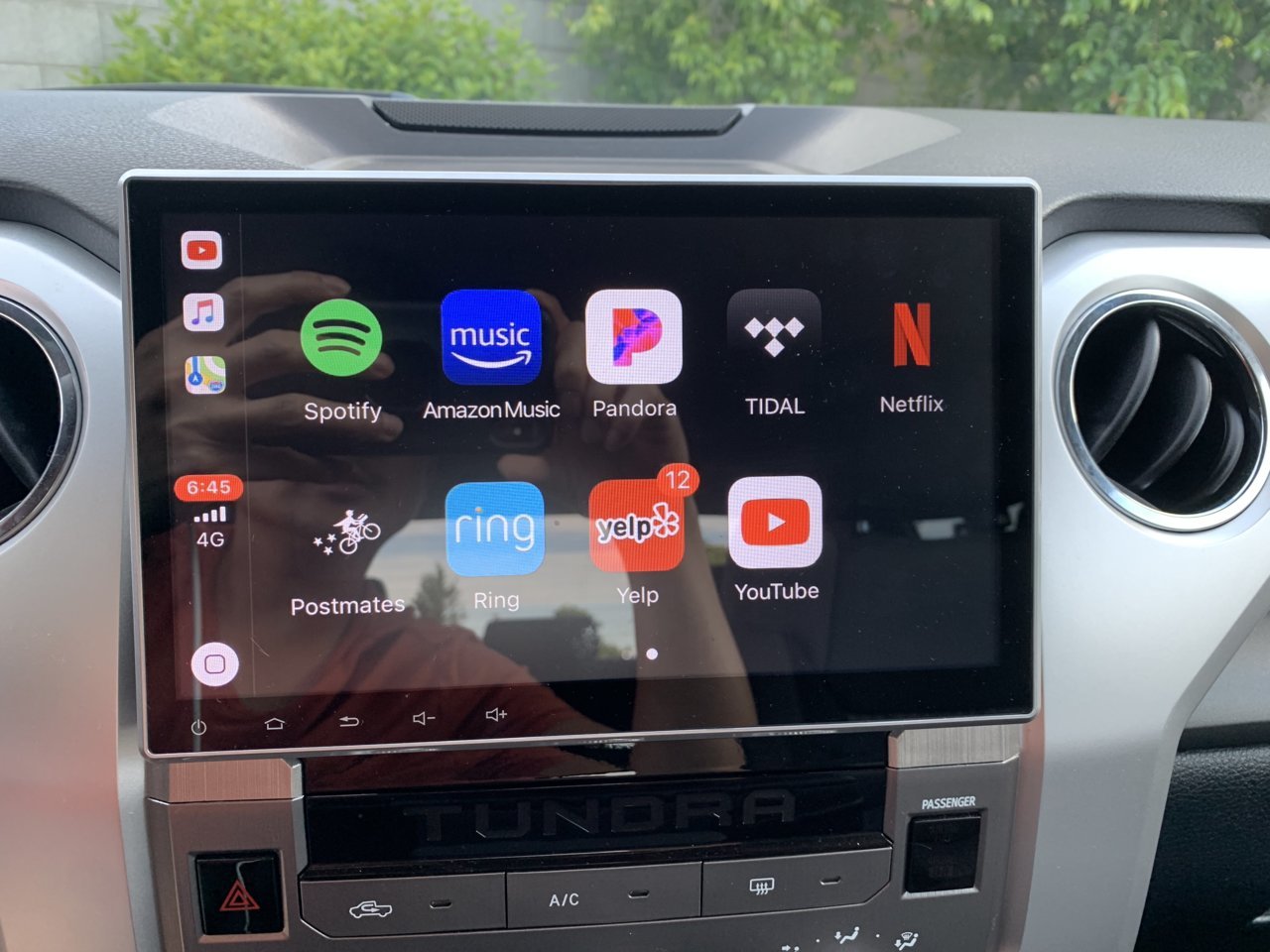

    Finally was able to mess around with jailbreak and CarBridge and now I can use any apps I want thru CarPlay.

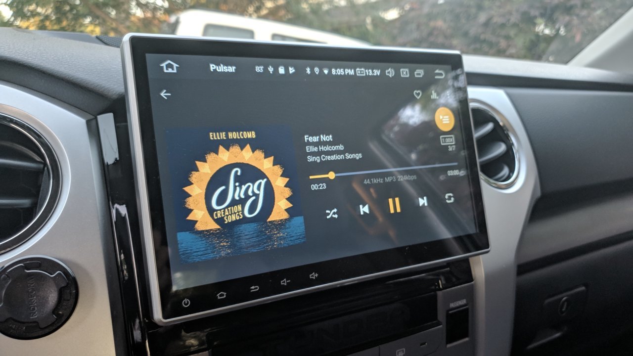

    I downloaded Pulsar Music Player(free version) last night and is way better than the music app that came with the head unit. This is if you wanted to play music from a usb drive. Intuitive and minimalistic.

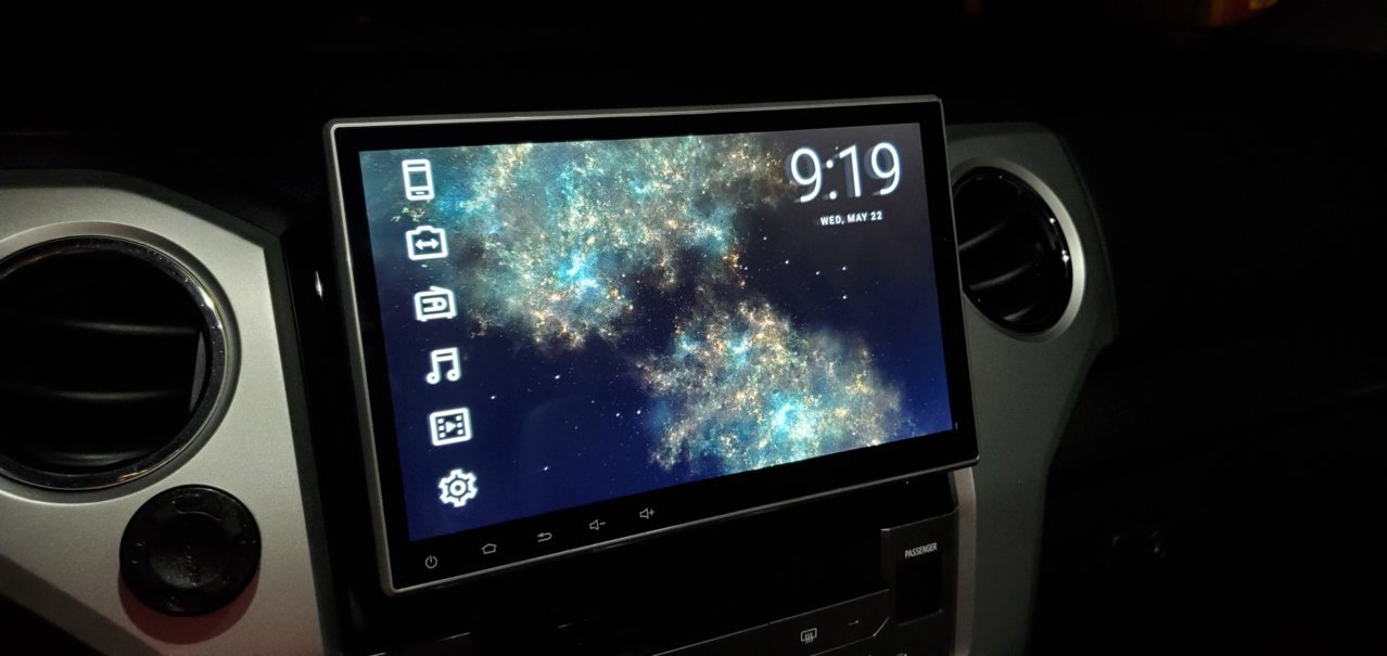

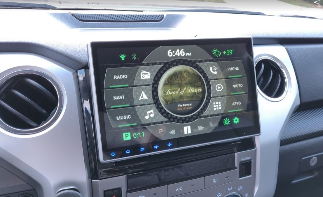

    Slowly getting mine set up the way I want. Running Nova Launcher and Maxelus Shadow Galaxy live wallpaper for now.
