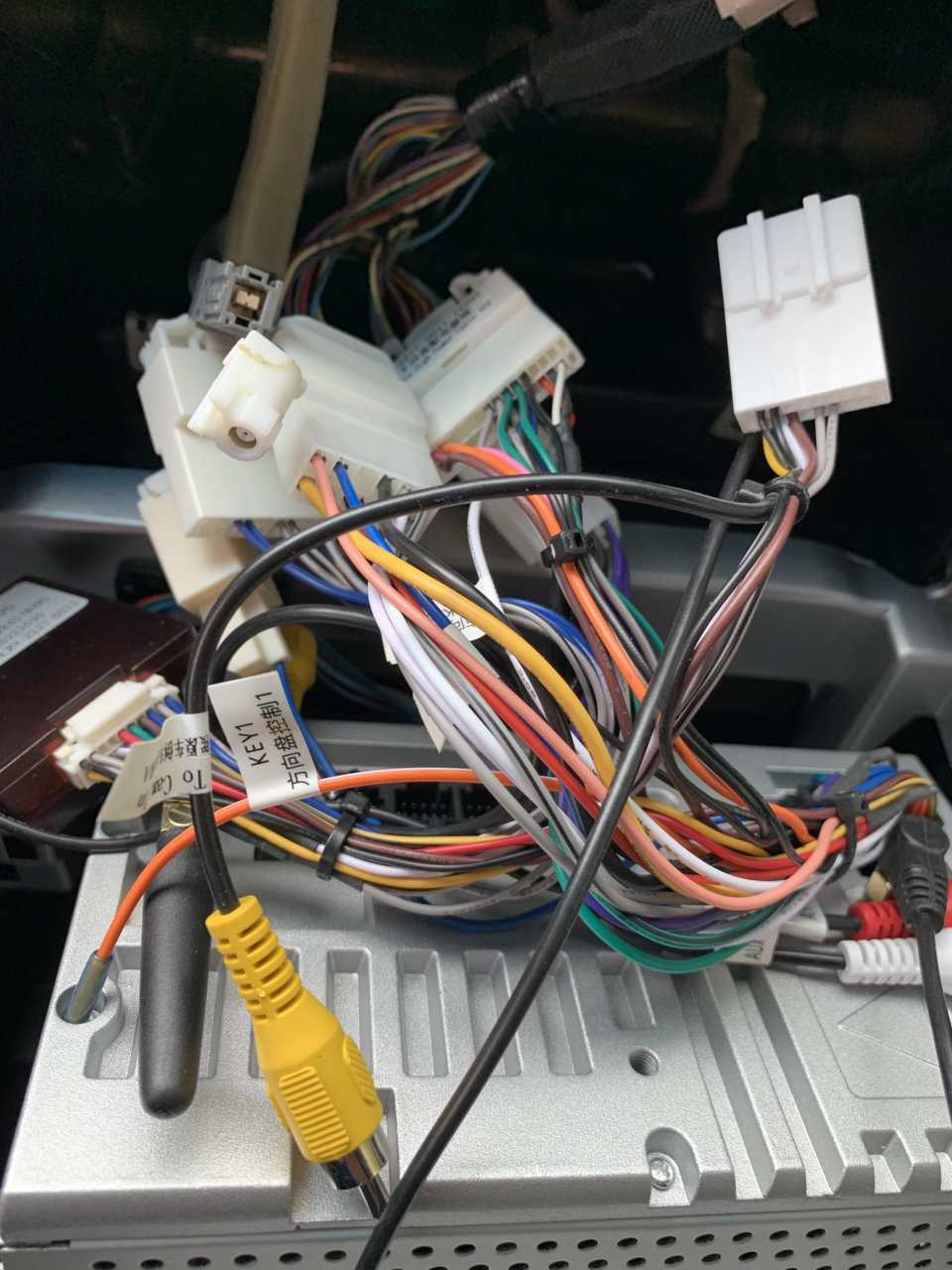

    I did receive my 13" HU on May3. I have installed it in my truck. The HU comes with NO helpful instructions at al, IMO.
    I purchased the canbus that DAsaita said would work everything. Well, it did not come with an adapter for my backup camera. The response from an Dasati email was
    office@dasaita.com
    Wed, May 4, 9:50 PM (3 days ago)
    to me
    Hello, your order did not buy our rear camera, so we did not give you, the factory rear camera on your car can be connected to our head unit for use. The GPS antenna is included in the box, please check clearly.
    Of course I had sent an email inquiring whether Everything was includrd to make my backup camera, SWControls work.
    FYI, make sure if you place an orderto get everything you will need. One would think that for the price they charge, EVERYTHING would be included.
    So their customer service sucks,IMO
    Installation booklet not included. But I was able to figure it out with some minor adjustments.
    After a few times of trying to get Zlink to work, everything is good and I like the HU. Of course now I have to purchase an adapter for my backup camera

    You bought directly thru Dasaita’s website?
    I had trouble with my backup cam at first but I realized it plugs into itself if that makes sense. The canbus I had spits out an RCA from the factory wiring. I thought because I didn’t have any RCAs stock that I didn’t need to plug any in. But you had to plug it in & then into the canbus. It creates the wiring harness for you.
    I did buy directly from Dasaita website.
    Not sure I understand what you are saying about the connection. I own a2016 and the backup camers factory wiring connector is like a rectangle shaped connector. I believe that it needs an adapter to connect to the RCA connector from the canbus.
    As you can see from the above pic that was sent to me from Dasaita in an email answer, there is no adapter to connect to my factory wire for the backup camera, which is the white connector in the top left of the pic. and the yellow RCA on the bottom of pic is for the backup camera from the canbus.

    Your pics of Dasaitas response don’t load on my phone for some reason. You might have the wrong canbus.
    What I meant was that I had that yellow RCA cable coming off also (my connection plugged in) but I was looking for another RCA to hook it up to. I didn’t realize I needed to use another connection that they had sent in the kit. I plugged that into the radio & hooked up the yellow cables to each other. Voila I had my backup cam.

    You may be right about the canbus.
