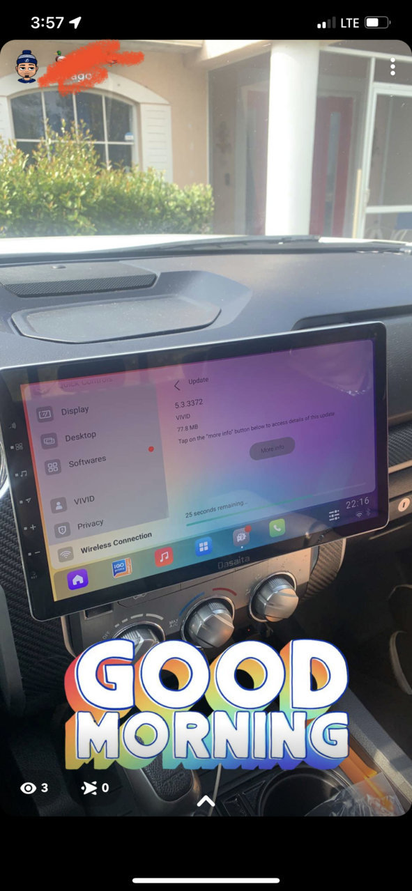

  13. Apr 2, 2022 at 2:01 PM
    #1963
    Shadowrex
    Shadowrex New Member
    Jan 19, 2021
    #57860
    10
    15 tundra xsp-x
    Best purchase ever

    Is that the 13.3”?
  15. Apr 3, 2022 at 11:51 AM
    #1965
    Shadowrex
    Jan 19, 2021
    #57860
    10
    15 tundra xsp-x
