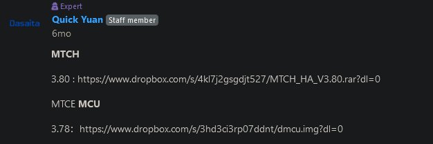

    Looks like a new firmware update was posted on Feb 10 on the Dasaita forums for all 3 firmwares (Scout, Vivid, and Max10).
    Will more than likely be updating my unit tomorrow.

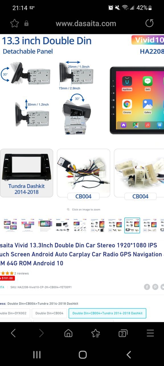

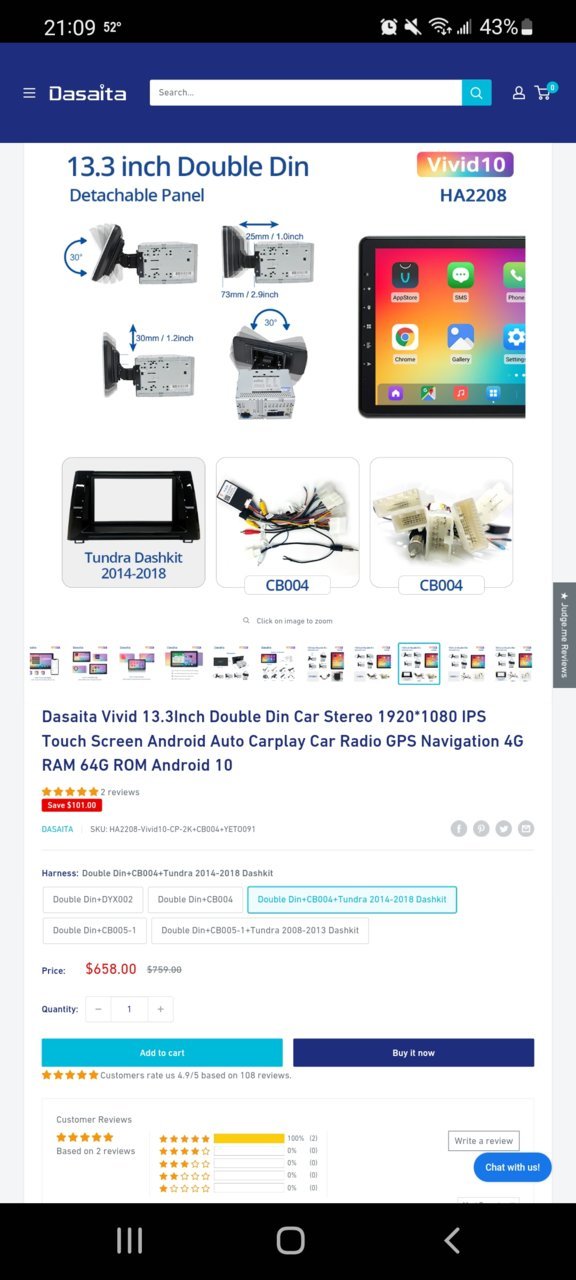

    Dasaita has a kit for the Tundra. Anyone have any feedback on the quality of the kit. Looking to order soon.

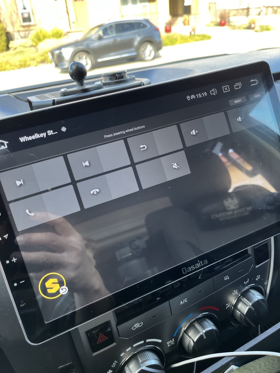

    Think I halfway figured this out... at some point I was experimenting with in the "factory settings" by switching the steering wheel controls to SWC and not Canbus. I think that wiped out a lot of things and that's what caused the mixing with the radio. I've since switched back but the steering wheel controls that were defaulted by the canbus are wiped out. Could someone take a picture for me of what they have in the steering wheel controls area? Nicole from Dasaita says I need to program the steering wheel keys the same as the CarPlay, but there's so many different "next song" buttons in the programming I don't know which one to choose. The menu should look like this (Wheelkey Study)...
    After entering wheelkey menu
  16. Feb 23, 2022 at 6:09 AM

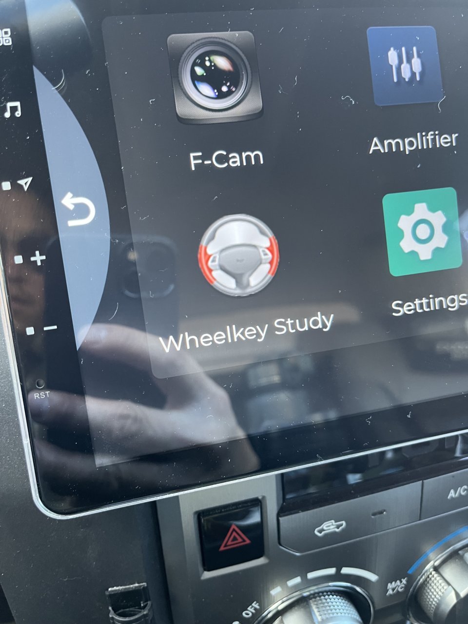

    where can we go to turn this off?

    if you’re on the new version with the new UI, touch the scout icon on the bottom left, open up settings(not the settings app), and scroll down.

    Also looks like there's an MCU update.
    I wasn't able to get my unit to update. The old file name use to be dmcu.img but the new file is hmcu.img
    No idea how to get it to update. I messaged dasaita to ask if this was an update also for the px6 scout units and they said yes but I can't get it to work. The unit wont recognize the file as an MCU update if its named hmcu. I tried changing the file name to dmcu, the unit recognized it tried to install but it fails.
    Messaged dasaita to ask about this so just waiting on an answer.

    well got an answer from dasaita, the mtch mcu isnt an update for units with an mtce mcu, like they originally told me but they did say there is an mtce mcu update coming at a later time. so looks like its just firmware updates for now.

    Is it supposed to be pretty obvious? Settings menu still looks the same to me - not sure if it's under the advanced or factory settings. I did update to 1.1.1547 HCT but the UI still looks largely the same. The Scout Logo does disappear when I'm on the radio screen, but it pops back up again when I'm in CarPlay. Again, not sure if that's what the update did or not
