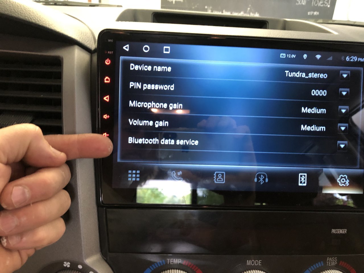

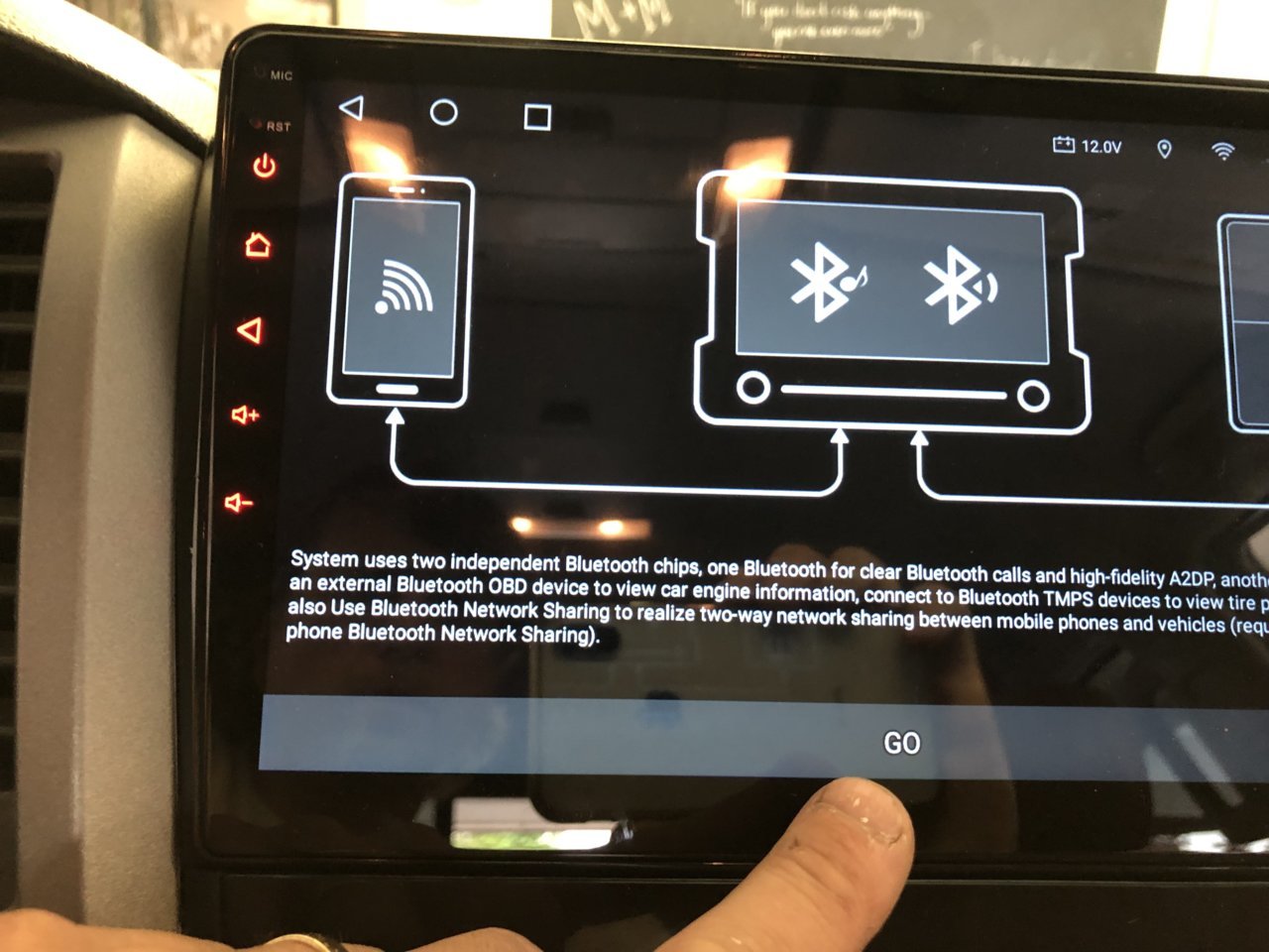

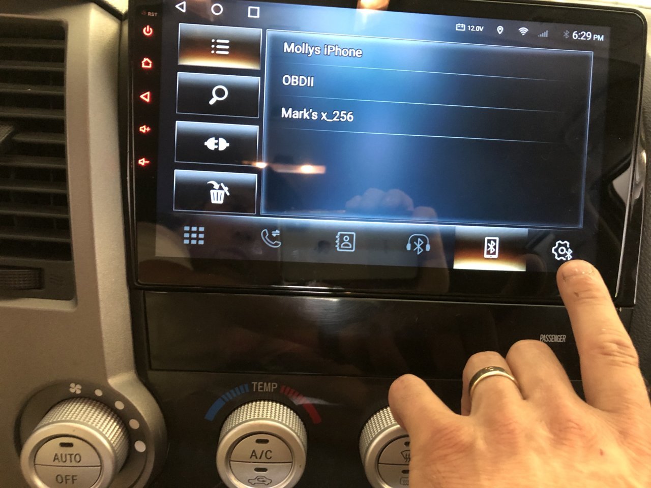

    My headunit is an OKNAVI which I believe is very similar, and I just went through the same issue connecting BlueTooth for OBD2.
    On my HU, there are TWO Bluetooth connection types. A2DP for better audio quality connections (phone and music) and while I don't know what the second is called, it is for non audio devices like our OBD2.
    While I could see and even "somewhat" connect to my OBD2 in the same Bluetooth window where I pair phones and other A2DP devices, it did not function and would drop. Within my Bluetooth app, there are several sub-pages, one of them was for making and managing phone connections and another was mostly settings (ON/OFF) but at the bottom of the window of this other page there was another Advanced or something like that. I went into that window and there was some information on the screen which explained this. I was able to pair from this window and then Torque would see my OBD2 BT adapter. This was a huge PITA to figure out; I did web searches and did not see a single reference; everyone else apparently "just connected" with no issues. Maybe some HU's are different but... you might consider this while trying to connect to your BT for OBD2.

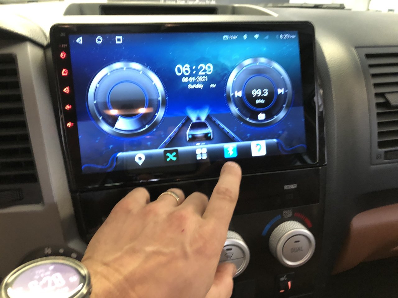

    Can you show screen shots or what your talking about, I have no idea what "other" screen your referring to

    The GUI look may be different since I have OKNAVI, not dasaita but, the concept might be the same. This "other screen" is called BlueTooth data services on my HU. Here are the pic's:
