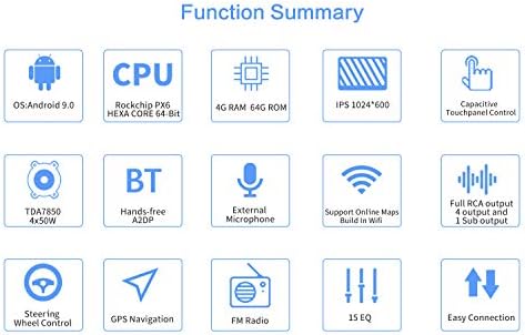

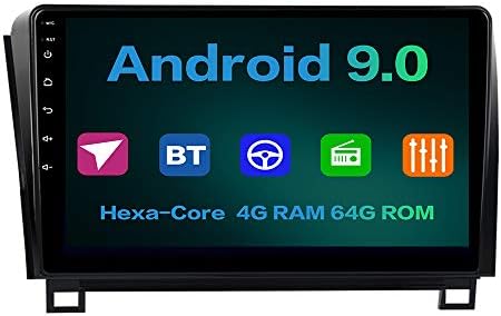

    Please help a brother out, I want to pull the trigger on this, have 2007 sr5, apple iphone will be used, currently have below but waze wont work on it anymore which is main reason for wanting to upgrade along with being able to watch movies etc
    Kenwood 7 Android AutoApple CarPlay Builtin Bluetooth InDash CDDVDDM Receiver Black
    Model: DDX9705S
    Kenwood CMOS230 Rear camera
    Is this unit easy to install with limited previous installation experience or will I need to find an installer? What additional components will be needed to make this plug & play and will I be able to use the Kenwood camera with this unit? Is the below the right unit? Thanks in advance for your guidance

    This is the correct HU for your vehicle. I believe a few people on this thread installed this unit for their second gen tundras so hopefully they can chime in. It should be plug and play if they provide you with the canbus harness. You don’t need anything else if you use the provided gps antenna and microphone. I believe you have to splice a wire or two for the backup camera but I’m not sure. Installation should be simple since it’s plugging connectors to connectors. There should be plenty of YouTube videos to show you how to install a new HU for the second gen tundra.
