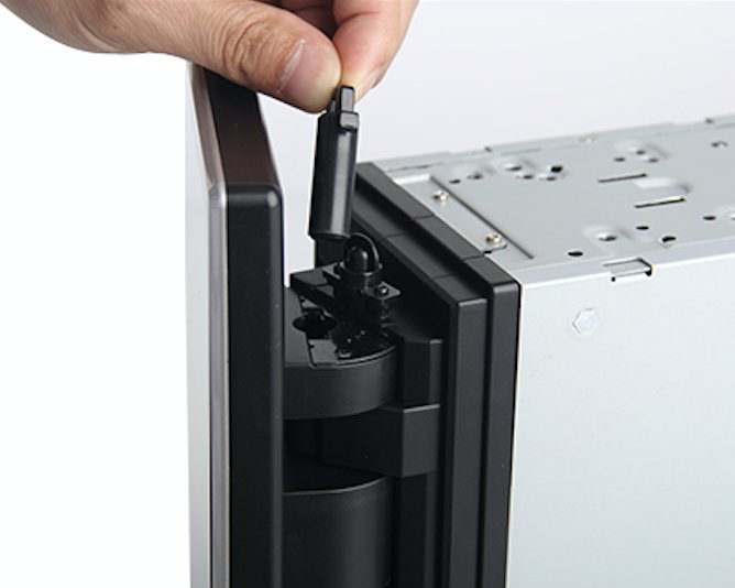

    Hi All, I purchased a Dasaita headhunt 10.2 from a member on our board. But when I received the headhunt I noticed 2 pieces of plastic holding the screen to the head unit are missing. He said to never had them. So I need to find out what this part is called if anyone one knows. Image of it is attached.
    I am trying to ask Dasaita or Phoenix to help me.

    Plastic screen tilt pins. Yeah, they probably aren't sold separately, so Dasaita is your only chance.

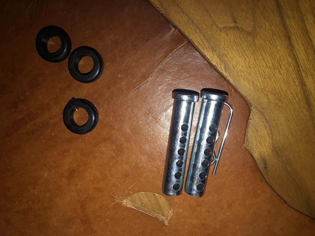

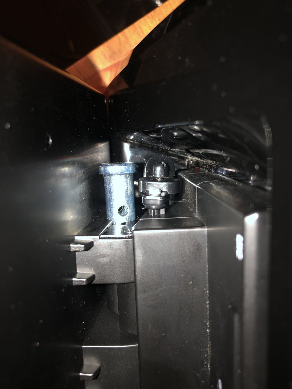

    Solved my own Russian way
    49990AB3-6330-4FF5-B032-7AA5148C0AE1.jpg 2A21594A-25AD-422E-B193-7CC01A6EEEB5.jpg
